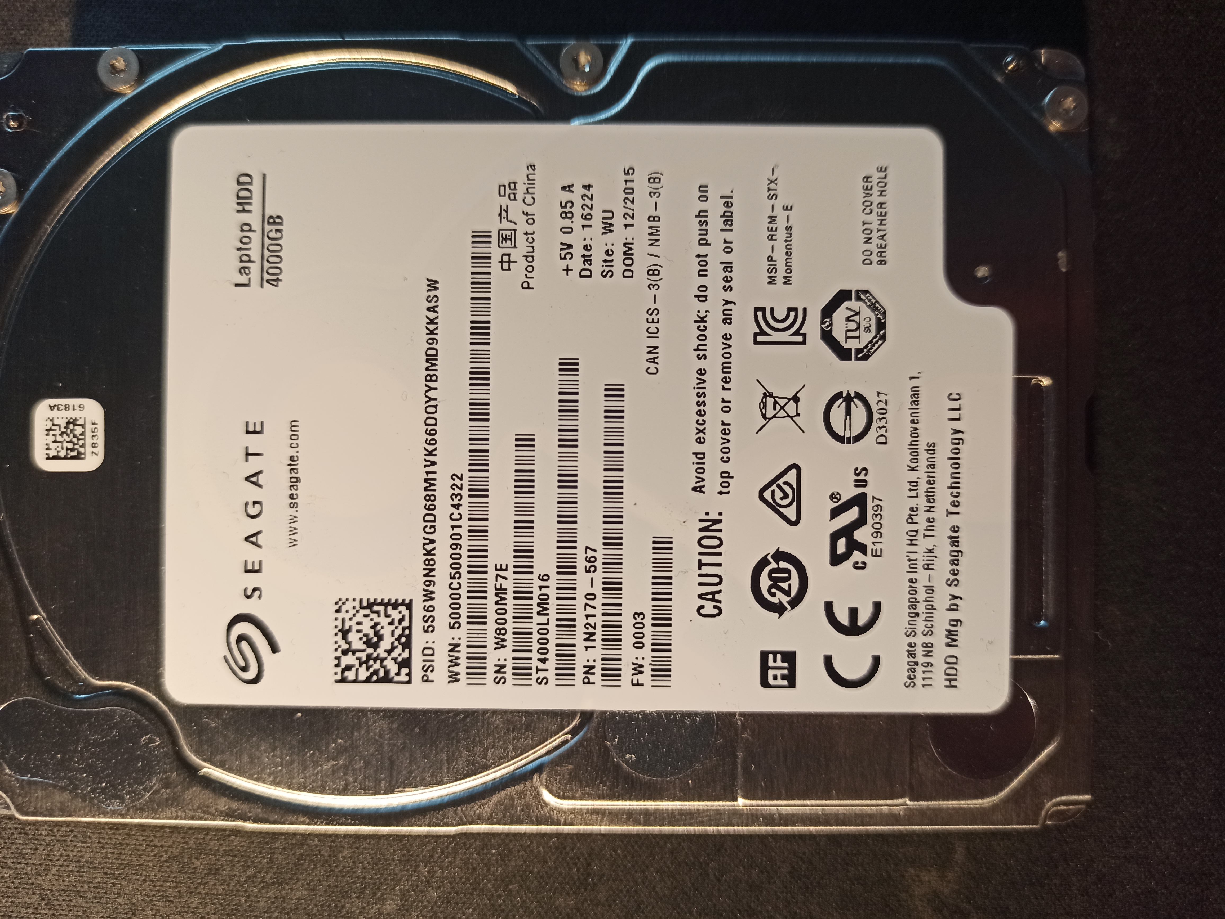

Hello!
I've a USB3 HDD that one day wasn't recognized anymore. I've dissasembled the case and checked the USB/SATA Adapter first with other drives but it was ok. So I connected the HDD directly via SATA to my PC. You can hear that the drive spins up smoothly but it it will not be recognized in the BIOS.
Then I remembered that I've a USB UART Adapter so I connected the faulty drive and cheched the serial output:
Boot 0x80M
Low Current Spin
(P) SATA Reset
RAW OFF
PASS
(DOS Table) Worst Count: 00000000 At SU: FFFFFFFF
Last Used Segment Found:
MSP POR10
No Phy: Staggered spin bypass
DSC
[BRO - 0002] 05AA9342 - 05AAB003
Starting LBA of RW Request=0005AA9342  Length=00001CC2
ProcessRWError -Read-   at LBA 0005AAAF03  Sense Code=43110081
Start SP recover for[Full ER]
SP correction starts at 05AAAF03
SP correction failed 84090094 at 05AAAF03
PrgF
LED:0x000000BD FAddr:0x00009861
As far as I read some documentation one should be able to get a command prompt by pressing CTRL+Z but this has no effect on the fauly drive - nothing happens.
Actually this drive doesn't contain any critical data but I'm interessted if it's possible to revive this drive or mabye recover any data from it.
Do you have any advise how to start in this case?

The drive has firmware problem, likely bad sectors, and possible mechanical problem.
No easy fix, sorry.

You Can Contact Frank -> https://www.gefund-it-datenrettung.de/en/ .This is a Media Cache Issue With This Seagate POS Drives
