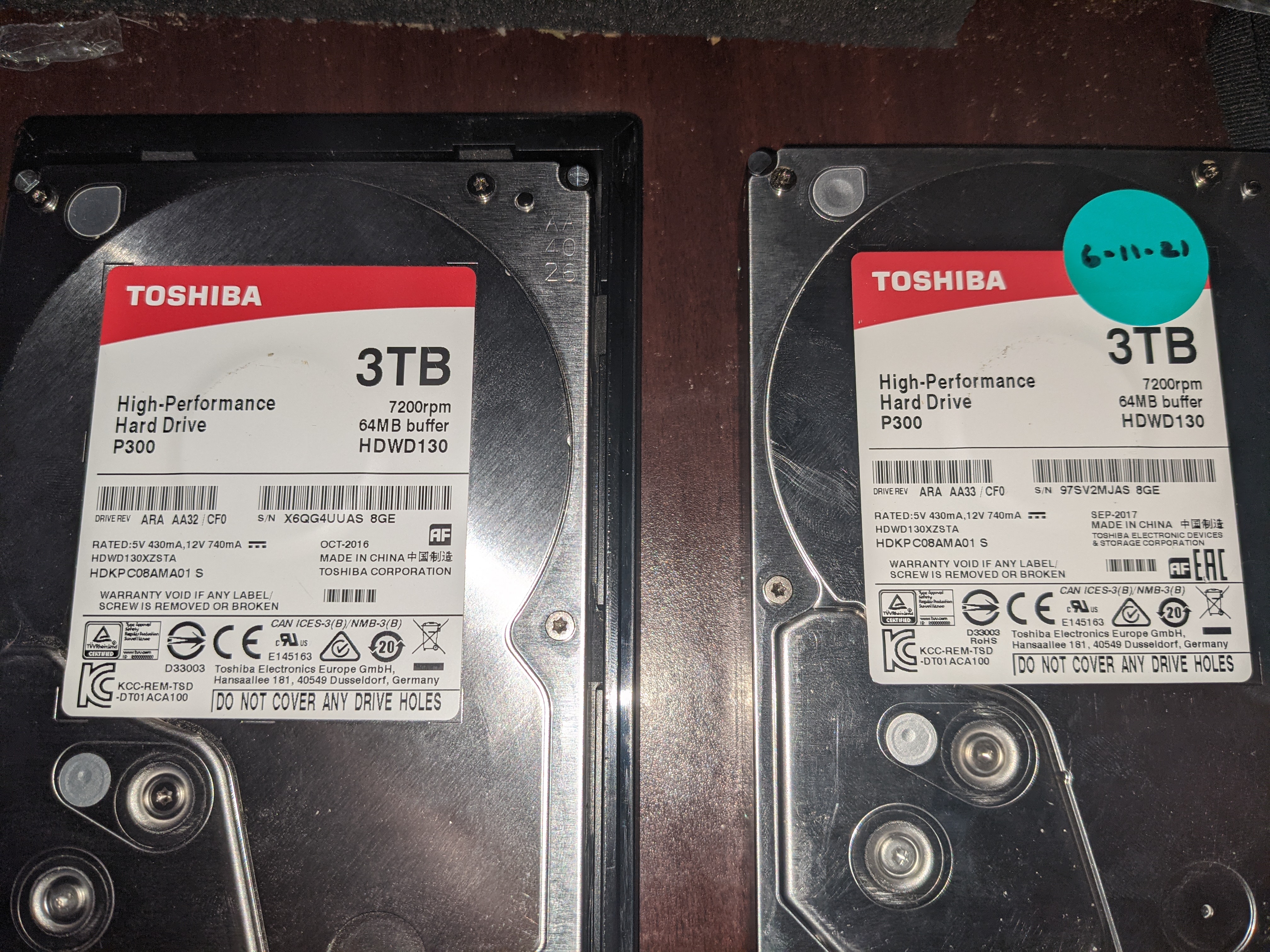

I've replaced the PCB with 2 different versions one which I realized was not the same chipset even though it had the same board number. The second one, I bought a complete HDD with Revision # ARA AA33/CF0(on the right). My revision # is ARA AA32/CF0 (left)but as you can see in the image they match in exact the model and what ever the series is below it that starts with HDKP which i assume is the chipset. This was the closest thing I could find to the original without paying 300+ for the drive. (it was 100$) Do you think it could still just be a matter of the firmware being off since its the next revision? It doesn't spin up/show up in bios ect.
Do you think it could be the pre-amp on the heads or is it most likely the spindle motor got burned out? I'm hoping I don't have to do a plate swap. I'd be willing to do it and have a laminar flow hood I can easily set up in an old grow tent in my basement.

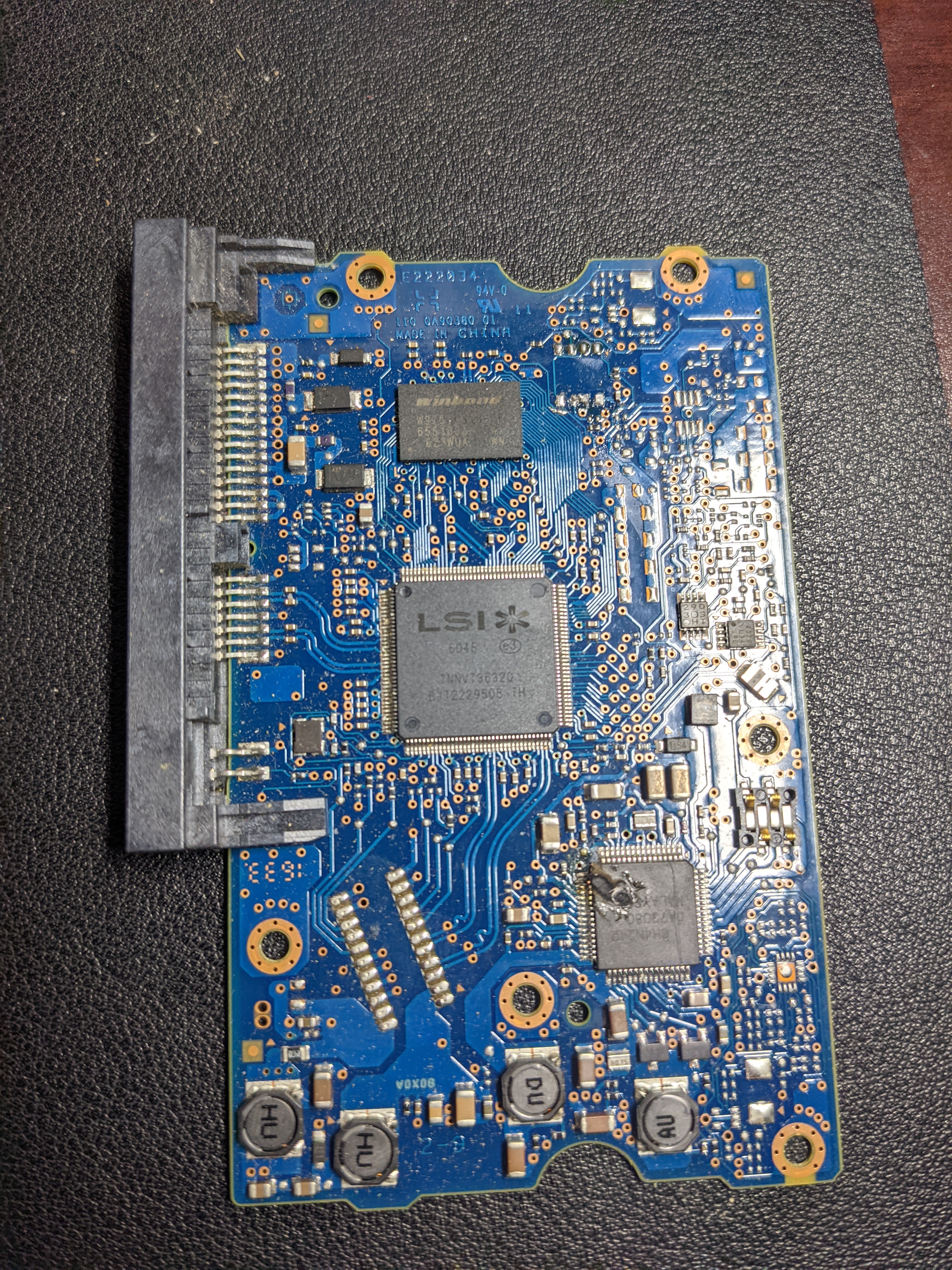

Here is a picture of the PCB that I fried.
As you can see the tvs diodes did nothing they aren't even blow but one of the main IC is fried and I assume that means the over voltage may have gotten further in the circuit to the internals... I know its weird but I put my nose up to the leads for the internal connection and I can smell smoke but it may just be proximity to the explosion that occurred on the pcb lol.

I know XD... it looks bad. And that's what feeds voltage into the preamp so I am pretty sure that's the next move. Luckily I was able to get an exact match model version wise for less than 100 USD which was a very lucky find on Facebook Marketplace. The only other sources want 200+ for them. Ooof. My next move then is to buy a laminar flow hood and build a box for a prefilter my inline fan then I'll likely cut the bottom our of a storage container to work inside. I can't really afford an 800 dollar repair bill right now. Worst case I lost a years worth of music and 2 weeks of code I was writing. Everything was backed up in December of last year.
I would like to test the preamp with multi-meter before committing to this build out though but I'm having trouble finding instructions for how to do this.
Also is there a safe way to test the spindle motor relay? I have a voltage injector that can go up to 4.5v not sure that would be sufficient for anything.

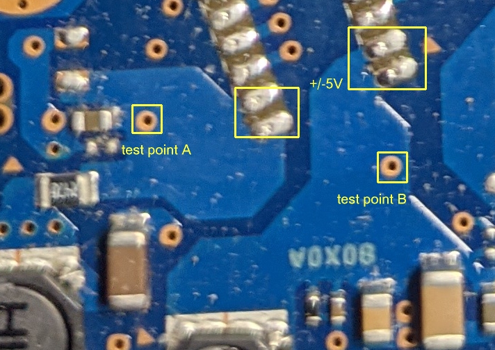

I suspect that the preamp is shorted. That would make the PCB look bad.
I would measure the resistance between ground and the two pairs of pins at the end of the HDA connector nearest the DU and HU inductors. Use the replacement PCB for this test.
Locate test points A and B on the other side of the PCB and measure their resistances to ground, eg a screw hole. Do this with the PCB on and off the drive. You can compare your readings against the working donor HDD.

The fuse has a bump which means it's definitely blown. The 5V TVS diode is most likely shorted. The motor controller has spilled its guts on the 5V side.

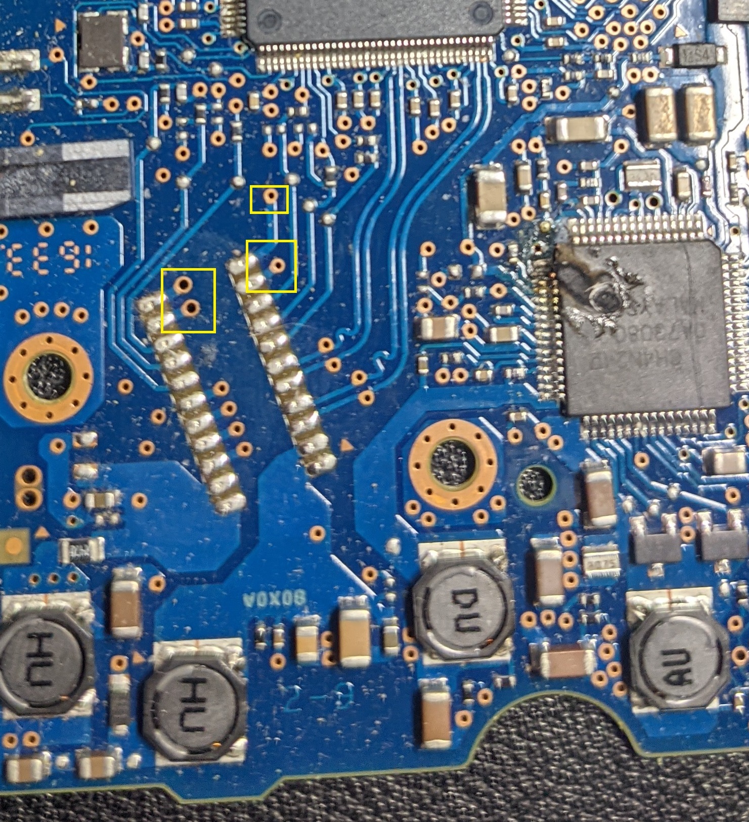

So for what I think is A and B test I got the same resistance for both drives. .4ohm for A1 A2 10Kohm and 10.3 Kohm for B1/2.... If that's the same does that imply the spindle is the culprit?
Also the positions of the test nodes were slightly different than the picture. I tested. I assume these are the corresponding locations.

With the PCB off the drive, do you measure the same resistances? :-?
With the PCB off the drive, can you measure the voltages at A and B with respect to a screw hole?
