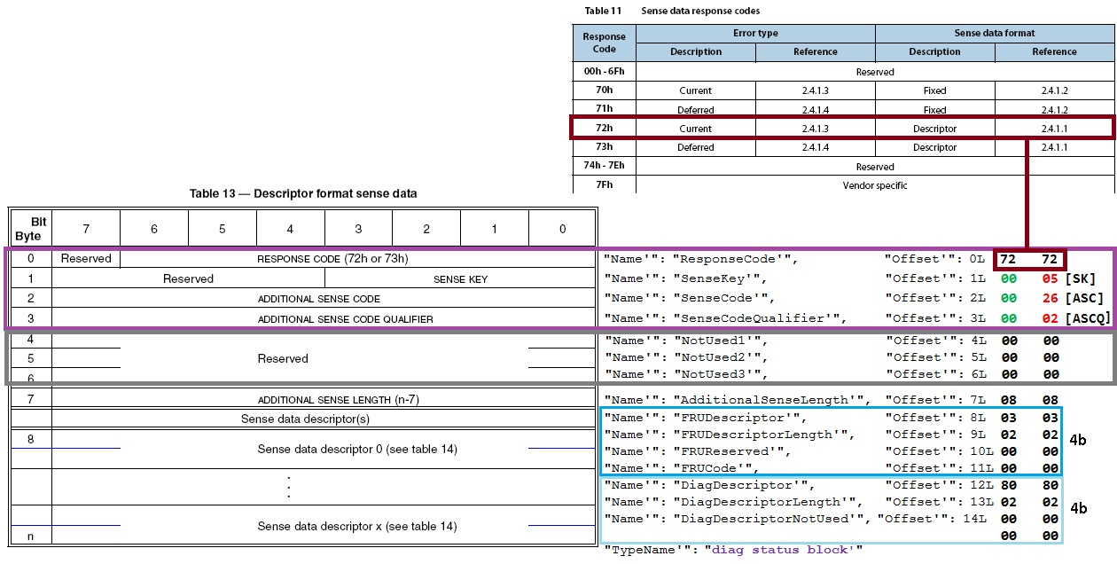

And now explanation of "SCSI-packet". This is 16b packet called DiagStatusBlock, most DITS functions uses DiagStatusBlock as its output. It's taken directly from SCSI standards. Most important values are first four:
72 - in SCSI it means "block describes current error and description is included". Seagate uses only "72" value, so it's easy to recognize this 16b packet in output - it starts from "72" and is 16b in length.
Three next bytes are:"SenseKey", "SenseCode", "SenseCodeQualifier", they give detailed description of an error, and there is no secret in it: https://en.wikipedia.org/wiki/Key_Code_Qualifier
In Seagate docs we can read, that their codes are not "exactly" as SCSIs, but... they are enough to understand meaning of the output.
If we got 72,0,0,0 -> command was successful
If we got 72, anything other -> there was an error specified in SCSI standards.
For example, we got "72 05 2C 00" after first SpinDown attempt.
This means: 5=Illegal Request,2C00=command sequence error. We didnt' unlock DITS before calling it.

SCSI DiagStatusBlock starts with 72,0,0,0, so it's OK
Next 12b are: Cyl(4b)-Sect(2b)-Head(1b)-rsvd(1b)-DriveFaultStatus(2b)-PreampFaultStatus(2b)
This 12b field is filled only in case of error - only then CHS and error values are set.
All this above is called "read_physical_sector_ret_value" (28b) in seagate documentation.
Next, 0x1F6 bytes of unknown purpose goes. This part is identical for 0/0/0 and 1/0/0 transfers, so it cannot be servo wedge content, as I initially thought.
Next, sectors are transferred, divided by 8b inserts. The last sector is incomplete.
Received transfer is correct, but.. protocol used by me is for sure not correct. Something is missing.... I couldnt' get transfer longer than 3 sectors, I couldnt' get any transfers on Kahuna etc. Probably SRQ must be taken into consideration in such disk requests.
Details about DiagStatusBlock:
I've attached an image comparing original SCSI (on the left and top) and Seagates' (on the right) documentation. Far right two examples of ESLIP output was shown: no-error with 72,0,0,0 and error 72,5,26,2 = "Illegal Request - Parameter Value Invalid".

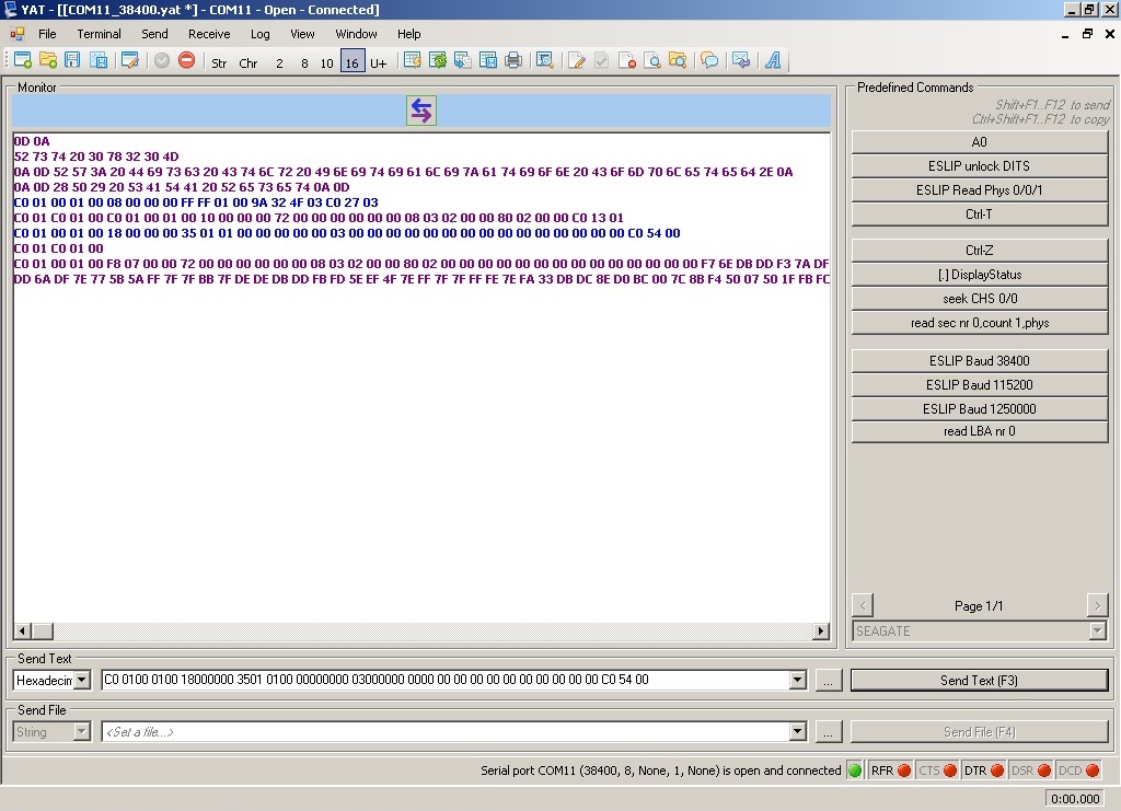

In my experiences usually it was impossible to send-receive large files. Only 1...3 sectors. Even at 38400 baud. There are random breaks in the transfer process. Also strongly influenced by BGMS. Turning it off helps, but not much.
IMHO if it is interesting to investigate the DETS-DITS command, and not the ESLIP protocol, then for this purpose it is better to use the ATA interface and the SCT protocol (as on the WD hards). The DITS and DETS commands are perfectly transmitted by this protocol. Look this:

What program do you use to send binary commands?
 Post subject: Re: How to speak with Seagate in ESLIP language
PostPosted: May 23rd, 2019, 21:07
Posts: 3975
could probably use:
Putty https://putty.org/
or
Tera Term https://ttssh2.osdn.jp/index.html.en

@BGMan:I use YAT: https://sourceforge.net/projects/y-a-terminal/files/
Its' GUI is not ideal, but after testing Bray, Coolterm, Realterm, Hterm, Docklight, teraterm, ZOC..... , YAT seems the best for this specific purposes. It has LONG edit field for hex commands input, buttons for pre-defined commands, full session history, input and output in different colours.... etc.
