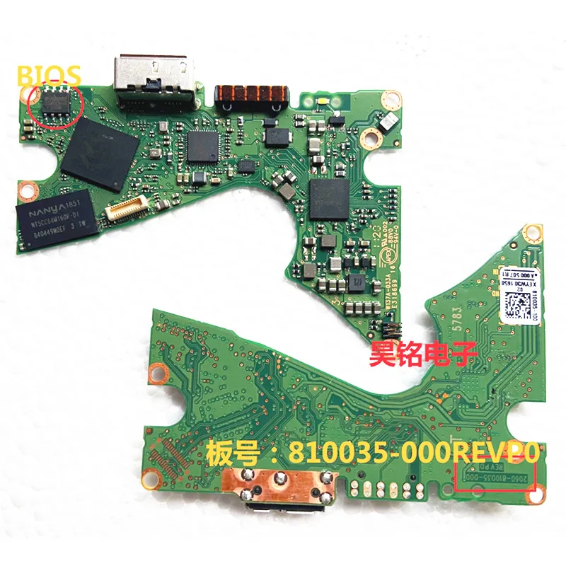

 Post subject: Re: New USB to SATA board connectors for SED
PostPosted: December 4th, 2021, 13:20
Posts: 17335
ddrecovery wrote:
pepe wrote:
wondering what the point is in removing the crystal once you removed the caps...
I am not sure what it does. But in some PCBs like the 800035 it is needed.
Do you mean "810035"?
https://ae01.alicdn.com/kf/H78377fae516c48e785fb7d318bf41898i/WD-2060-810035-000-Unlocked-PCB-Lockless-Circuit-Decryption-Logic-Board-for-WD50NDZW-WD40NDZW-Hard-Drive.jpg
The photo isn't very clear, but after you remove the SATA coupling capacitors, I can't see how the bridge IC can have any impact. The only way the bridge can affect the MCU is if there is an alternative communications pathway between the two chips. Therefore it seems pointless to remove the crystal. :-?

ddrecovery wrote:
Yes I did mean 810035.

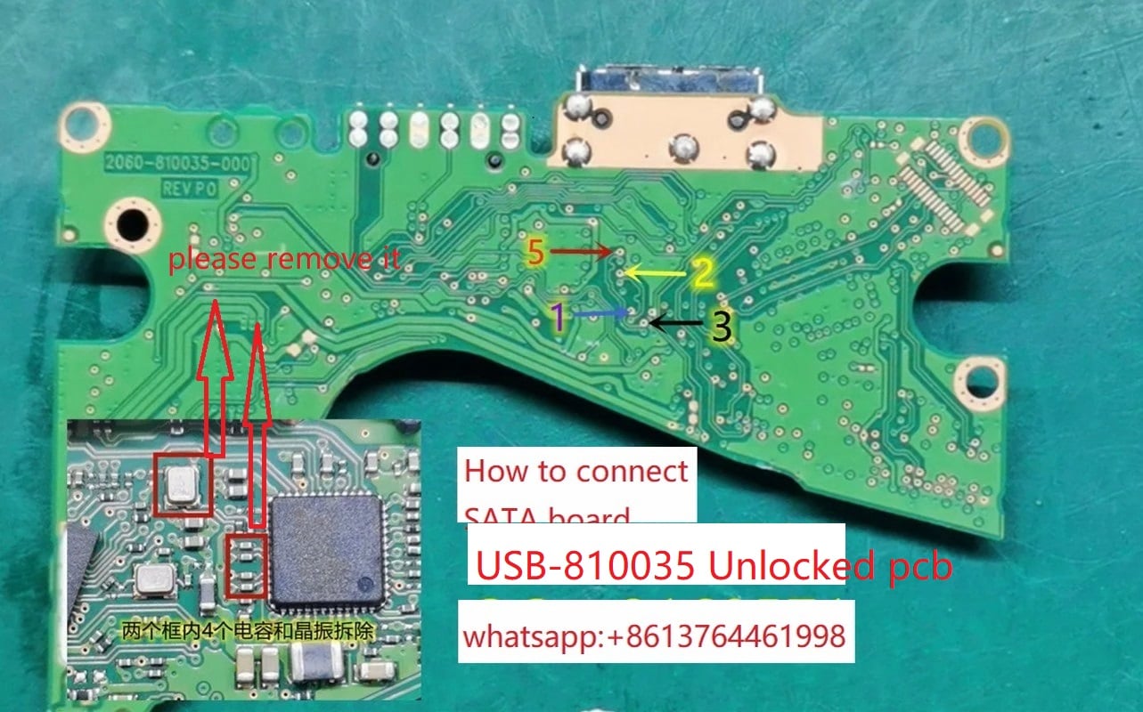

I think this picture is what steered me in the wrong direction.
Good news is removing the crystal had no effect on the SATA connection.
1, 2, 3, 5 ???
What happened to 4?
Not sure that I'd want to send my data there:
http://www.datarecovery-china.com/index.asp
PostPosted: December 7th, 2021, 13:51
Posts: 1777
Location: Phoenix, AZ USA
1, 2, 3, 5 ???
What happened to 4?
Different boards have different numbers.
On these boards the 4 is replaced with a 5.
Some boards have now replaced the 4 or 5 with 91 (or 94 can't remember off hand).
Most USB-C boards have no numbers, so you do a continuity test to find the pinouts.
PostPosted: December 7th, 2021, 14:37
Posts: 17335
Do you mean E71, E72, E73 and E75?
Yes. For example the 810012 PCB has E71, E72, E73 and E76.
PostPosted: December 7th, 2021, 15:11
Posts: 17335
ISTM that the easiest way to find the pinout is to find a photo of a SATA PCB with the same MCU and then visually trace the differential pairs from the MCU to the connector.
PostPosted: December 7th, 2021, 15:22
Posts: 1777
I am sure you are right. But the caps are always in the same place. So its a two minute job to find the pinout with a MM.
