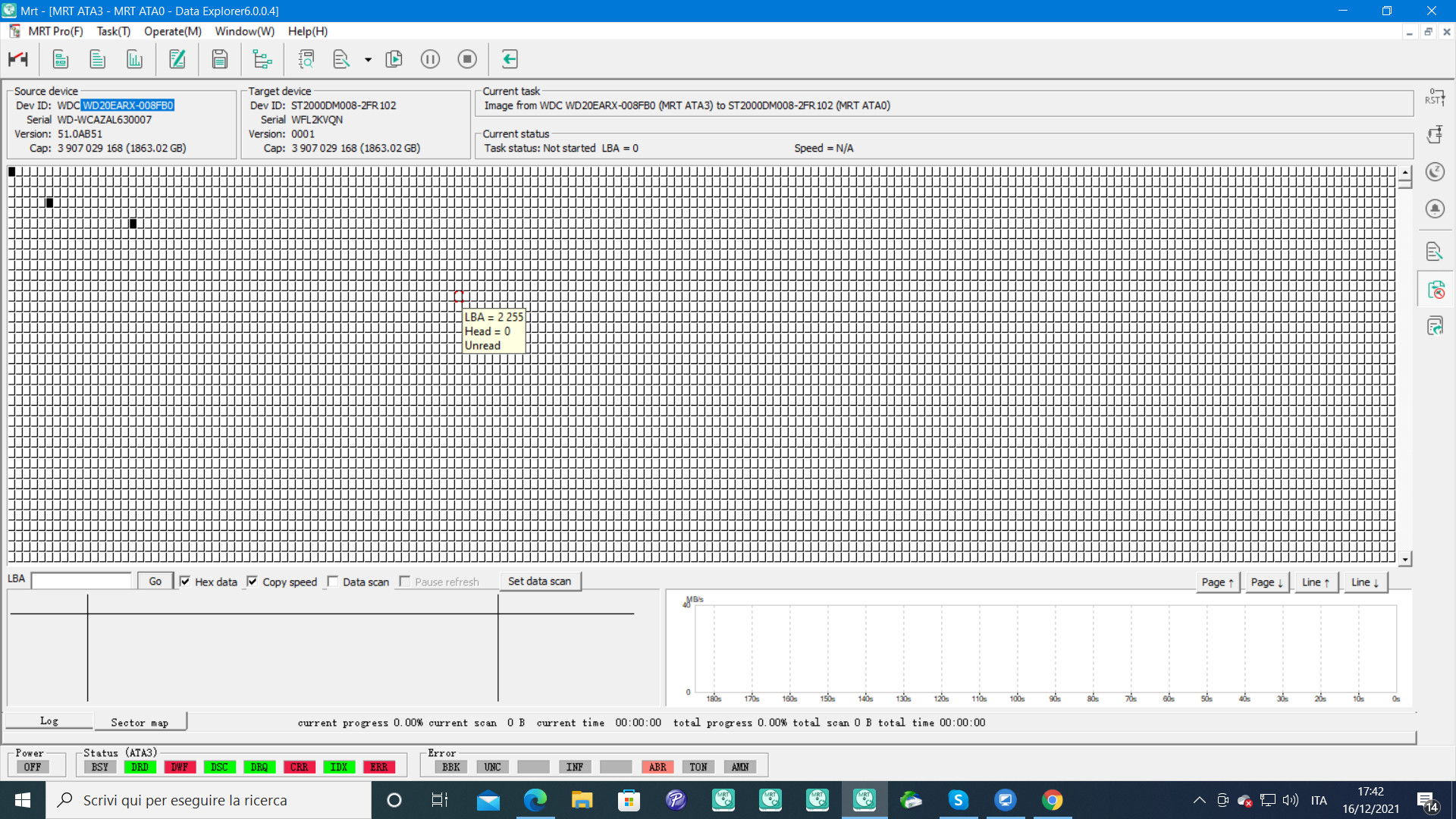

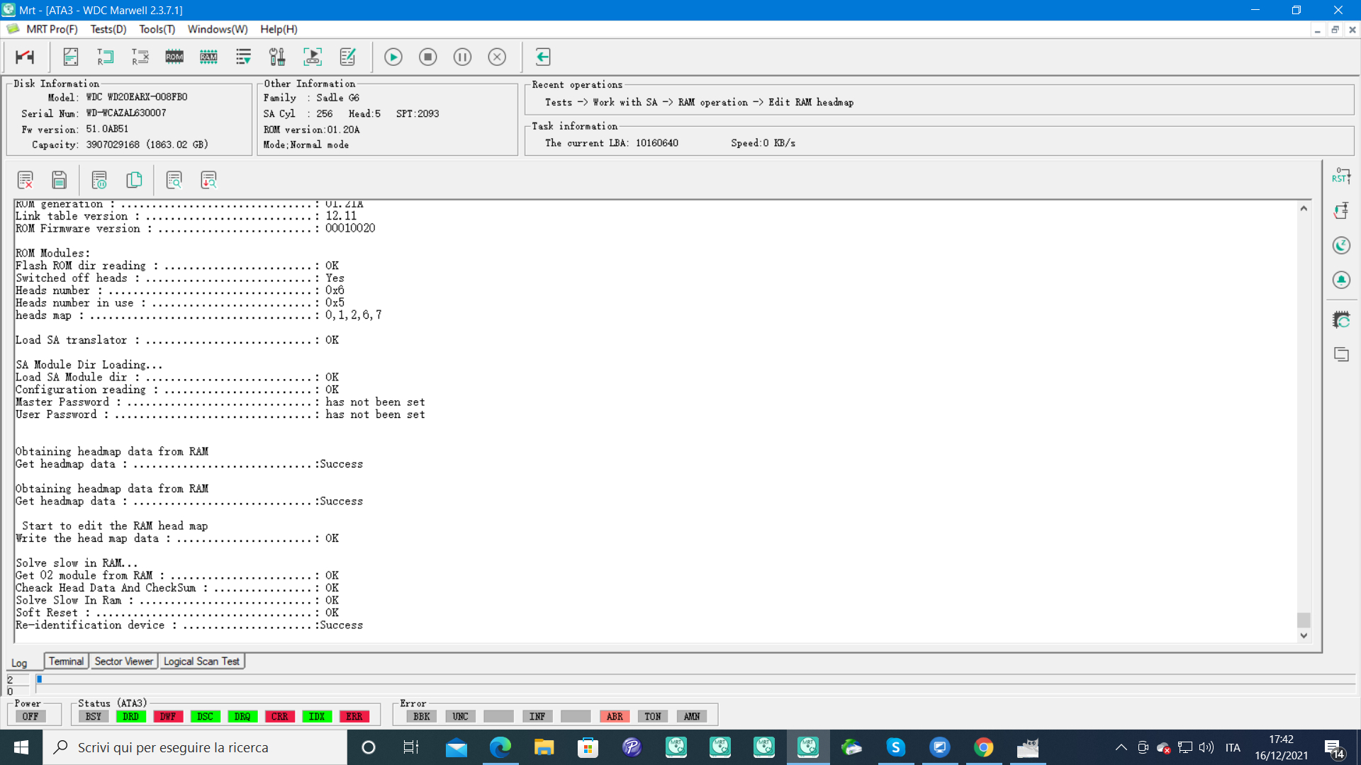

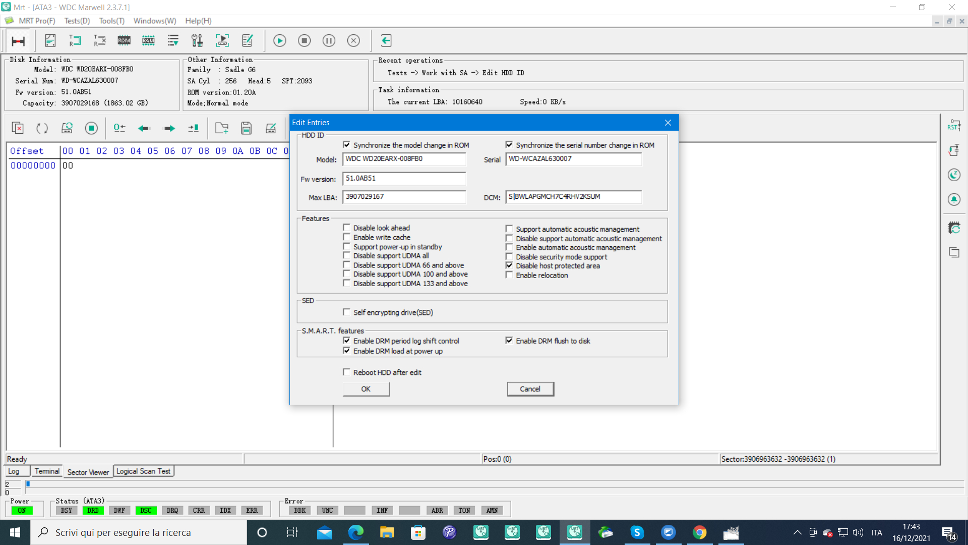

Hi guys i have this drive i have swap head and i can read all modelu of SA, the integrity check of SA say ok but i can't access to data area, not read any sector. I have thinked are SED issue and I have disabled but nothing have change, I have regenerated translator (after module backup) :-) renegerator go successfull but nothing, head test say all head ok. Suggestions ? I can read sector only if i disable module 02

 Post subject: Re: WD20EARX-008FB0 can't access to user data
PostPosted: December 16th, 2021, 15:49
Posts: 1748
All heads shows sector read error ?
PostPosted: December 16th, 2021, 18:45
Posts: 4854
are you using donor pcb by any chance?
PostPosted: December 17th, 2021, 6:23
Joined: February 13th, 2009, 13:41
Posts: 17
Location: Barcelona, Spain
Try replacing module 02 by another one. (Block access in RAM and load from other device)
PostPosted: December 17th, 2021, 11:33
Posts: 4854
Those status register values are bugging me... i would try a donor pcb too.
PostPosted: December 17th, 2021, 13:10
Joined: November 5th, 2015, 18:00
Posts: 82
Location: in the lab
Note that the power button is off for the last 2 images.
PostPosted: December 17th, 2021, 13:42
Posts: 82
Sorry, it was an observation for that:
VEXUS Data Recovery
PostPosted: December 17th, 2021, 14:33
Posts: 4854
facepalm, yeah, i missed the power state. Status and error regs are off in pc3k when power is off, so they don't show sht without power, that's what disturbed me...
What error do you get (abrt, unc, idnf)?
not security locked?
