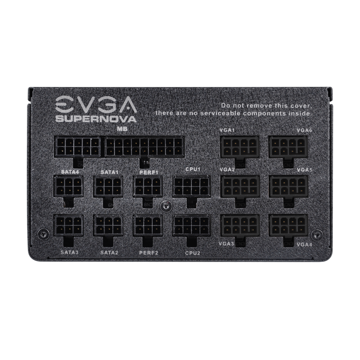

you mean connect SATA power cable to other outputs? No, I didn't do that.
All SATA drives are connected to SATA output 1-4. EVGA support says I can connect SATA to PERF1.2. I did connect long time ago, and it was fine
And are they all using EVGA sata power cables?
If you have 8 drives and and 4 outputs then does the other drive on on the same output cable as the dead drive spin? Do you see 6 or 7 drives. That will point you towards a cable or a connector problem, either way Id stop plugging drives in for the time being until you find out.

Location: United States of America
Lardman
That made me worry, and started to guessing why that happened. OK, so, my answer is no. EVGA SATA was in the PSU box, wasn't enough. And, I have extra SATA power cable from CORSAIR PSU, and I used it. Is that why the 5TB HDD suddenly dead? I thought all SATA power cables are universal thing, but that's not?
If not, if I buy some SATA power cables from somewhere else, that will be safe for PSU from any companies? Or still have compatibly issue?
Yes, other drives including the new 16TB, they all working fine. Weird thing is, I connected the new 16TB and the problem 5TB to the SATA cable from CORSAIR, didn't work. But, the 16TB is working fine after I switched to SATA power cable from EVGA PSU.

duhust wrote:
Lardman
Do not mix cables from different PSUs. The pinout is not standardised. You have most likely killed a TVS diode and fuse.

duhust wrote:
can't believe those cables are not standardized.
That would be far too sensible. Evga are Corsair are different https://solosleeving.com/psu-cable-compatibility-and-pinouts/ it looks like you put 12v down the 5v rail.
If you're lucky damage will be limited to a couple of components as fzabkar suggests. What's the make and model of the 5TB drive? and can you upload pictures of both sides of the pcb, this will help us determine if it's a DIY job.

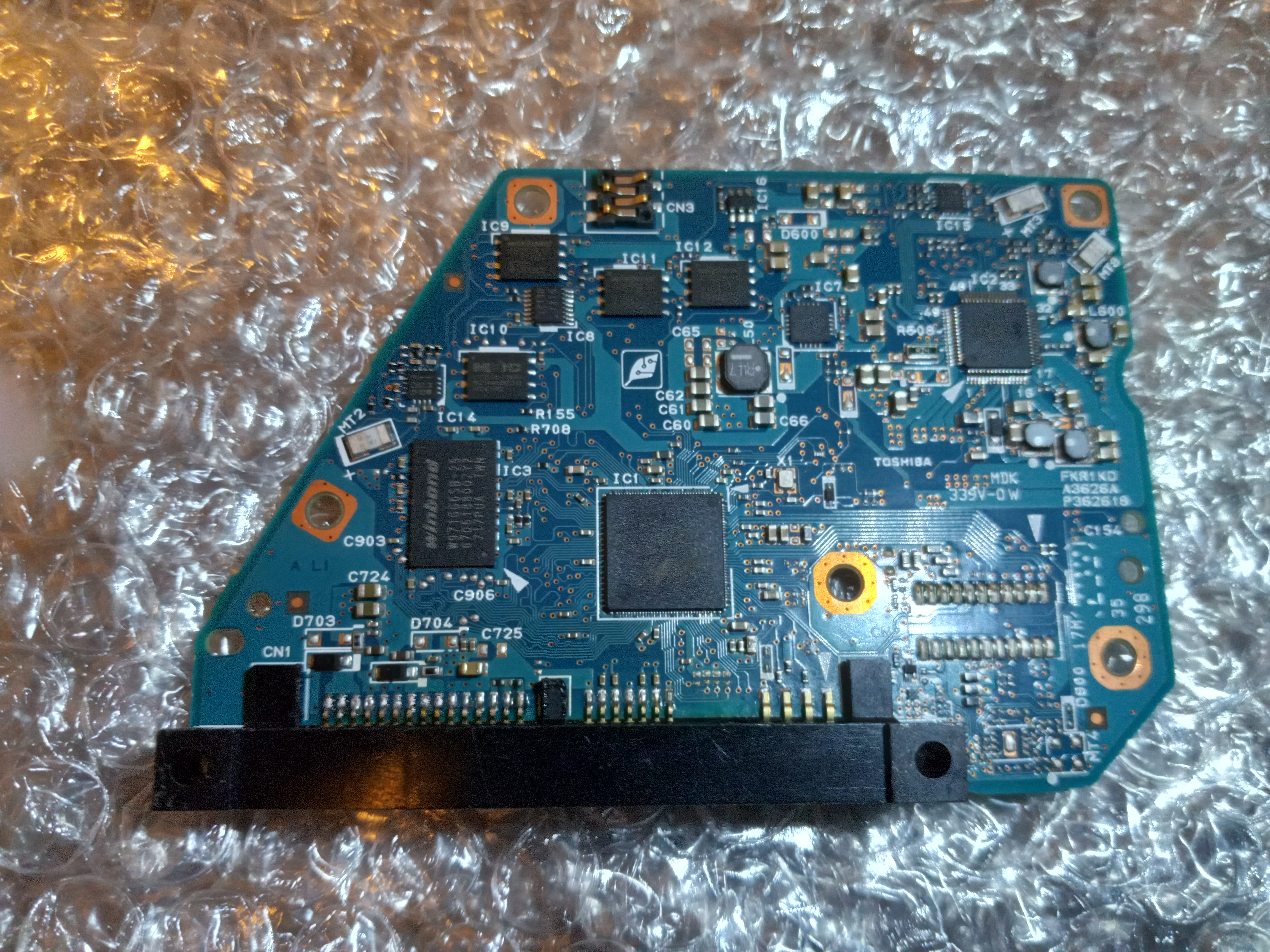

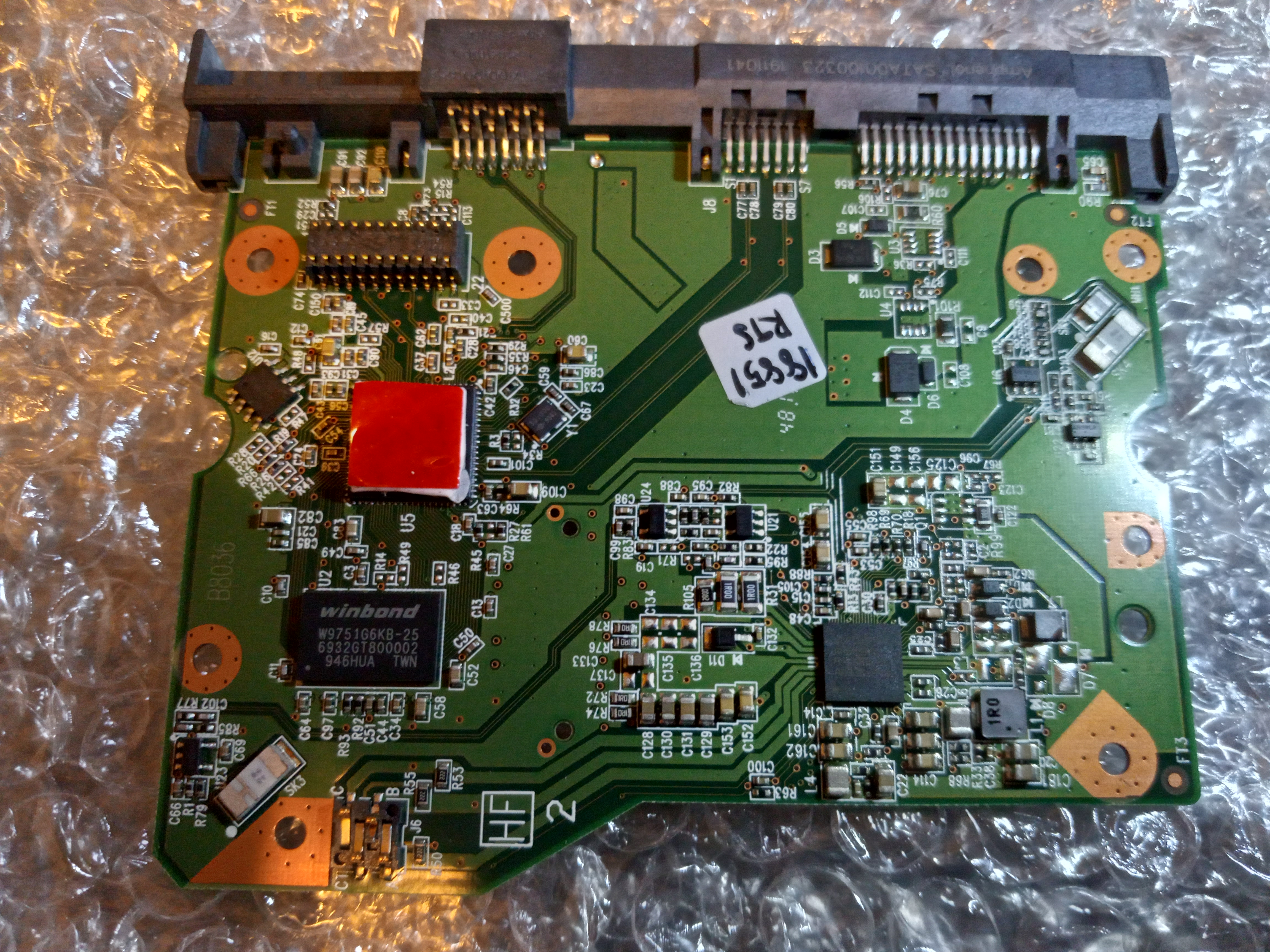

I finally received 2 donor boards and the tool
WD PCB 2060-800001-005 (WD100301_WD50EZRZ-32GZ5B1)
Toshiba PCB G3626A
>BTW, I suspect that the serial flash memory IC is a 1.8V type, whereas your reader is probably a 3.3V device.
I just looked at back side of donor boards,(attached photo) but I couldn't find how much voltages are. How do I check?

 Post subject: Re: hard disk doesn't spin at all right after installation
PostPosted: December 31st, 2021, 1:22
Posts: 17341
Read the markings on the chips and locate the datasheets.
http://www.users.on.net/~fzabkar/Datasheets/DATAURLS.HTM
PostPosted: December 31st, 2021, 2:42
Joined: November 27th, 2021, 1:22
Posts: 9
thanks, looks like I need to go get a magnifying glass...
PostPosted: December 31st, 2021, 8:46
Posts: 1323
I still think working on the patient pcbs is the way forward - jumping straight into reprogramming roms could end very badly.
