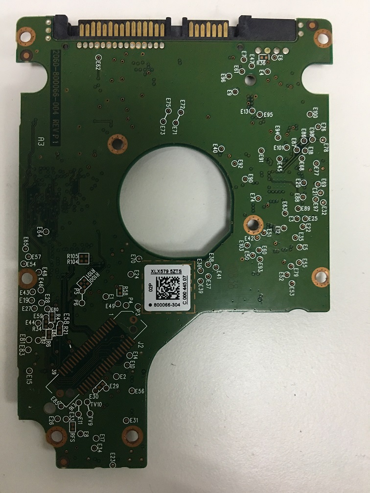

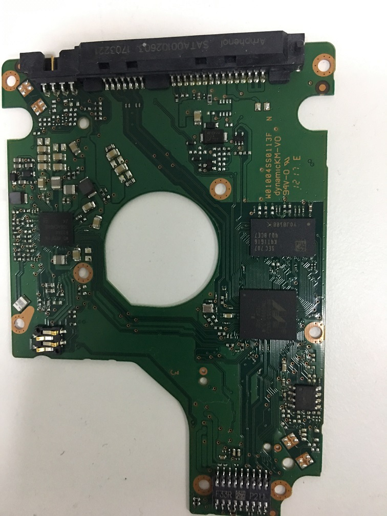

Please add an exact photo of the unlocked PCB

Joined: September 5th, 2018, 10:14
Posts: 15
Location: Tenerife
Mikippp wrote:
The lock is connected to the PCB (MCU) and not to the ROM
After the ROM is loaded from the unlocked disk to the locked disk, the disk is still blocked
Mikippp
Mikippp
You are right, without (MCU) from unlocked there is nothing can be done with locked PCB.
Transfering ROM from unlocked donor's pcb to patient pcb (lleaving neccesary original things), doesnt help.
Transfering ROM from Patient disk to donor PCB make the same.
MCU somehow linked with own ROM, or with some code.
