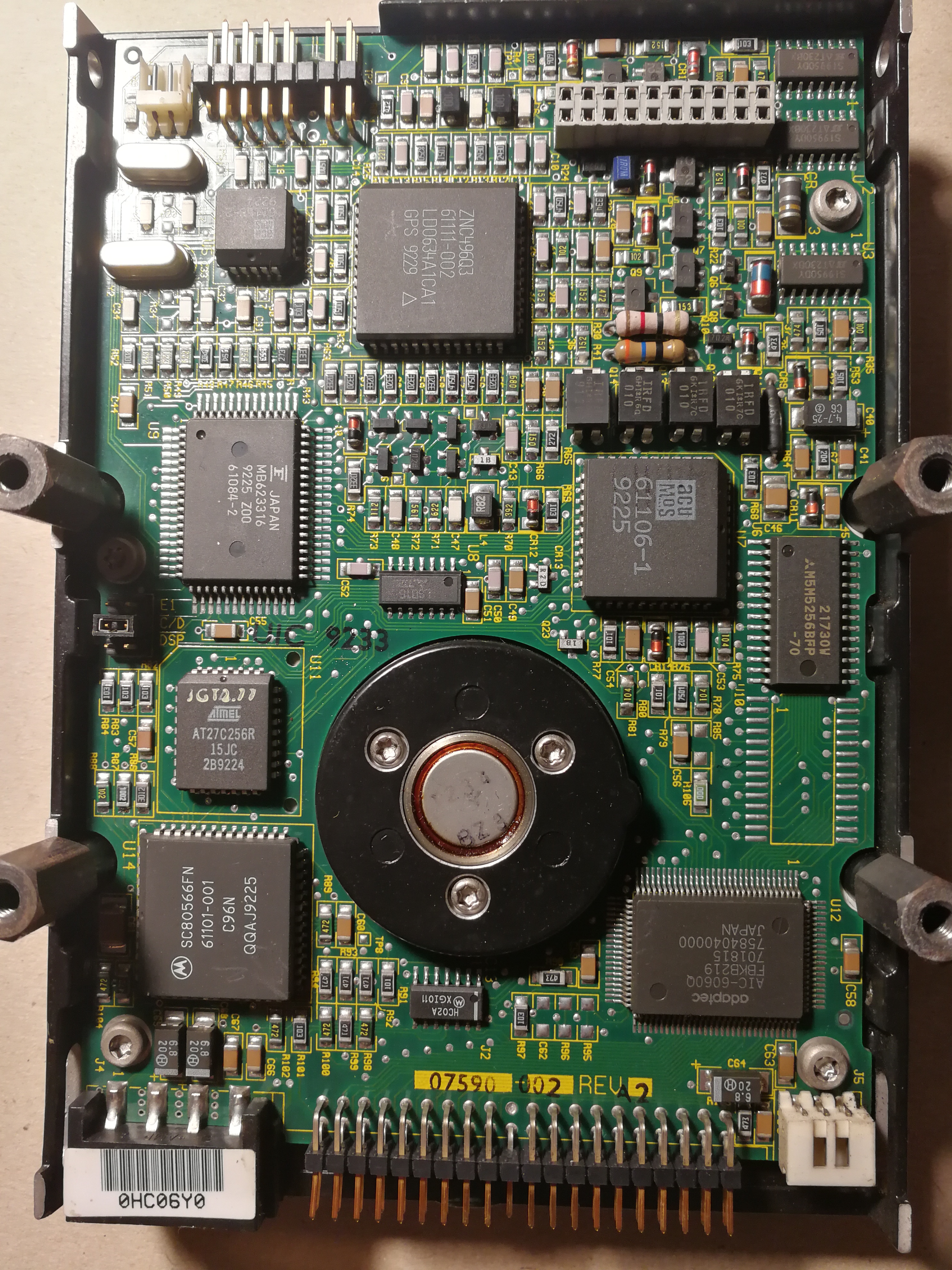

The HDD was in good condition in an old CNC-Machine, operating-system is DRDOS 5. I took it out to make a backup of the data. That was not a good idea. I connected the HDD to a Core2Duo PC with a legacy IDE-connector onboard. That PC has far more bios-options for a HDD than a 386 or 486 and I think that killed the HDD. I did an autodetect, the HDD was not detected. After that I tried with a Pentium 2 PC and at last with a 486, of course with correct parameters. Not detected. Then I took it back into the CNC-Machine but it was not detected either: "ERROR ENCOUNTERED INITIALIZING HARD DRIVE 0"
I also looked at the solder joints and I disconnected and reconnected the PCB twice to eliminate contact problems.
My boss is not amused!
any help would be highly appreciated

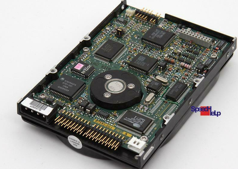

@all: I bought a drive with bad sectors. Same model but different PCB Numbers. It will hopefully arrive within the next days. I hope I don't make things worse when switching the PCB. Here are photos of my PCB (PCB1) and the one I have bought (PCB2).

I have received the donor HD in the meantime. Changing the PCB didn't help.

The hard disk is running again and all the data is still there!!! I bent the rather stiff cable between the hard disk and the circuit board differently and now the disk is recognised again. (The cable is very tight between the hard disk and the motherboard and presses against both) Even though I still haven't found the actual fault, I'll leave the disk alone from now on.
