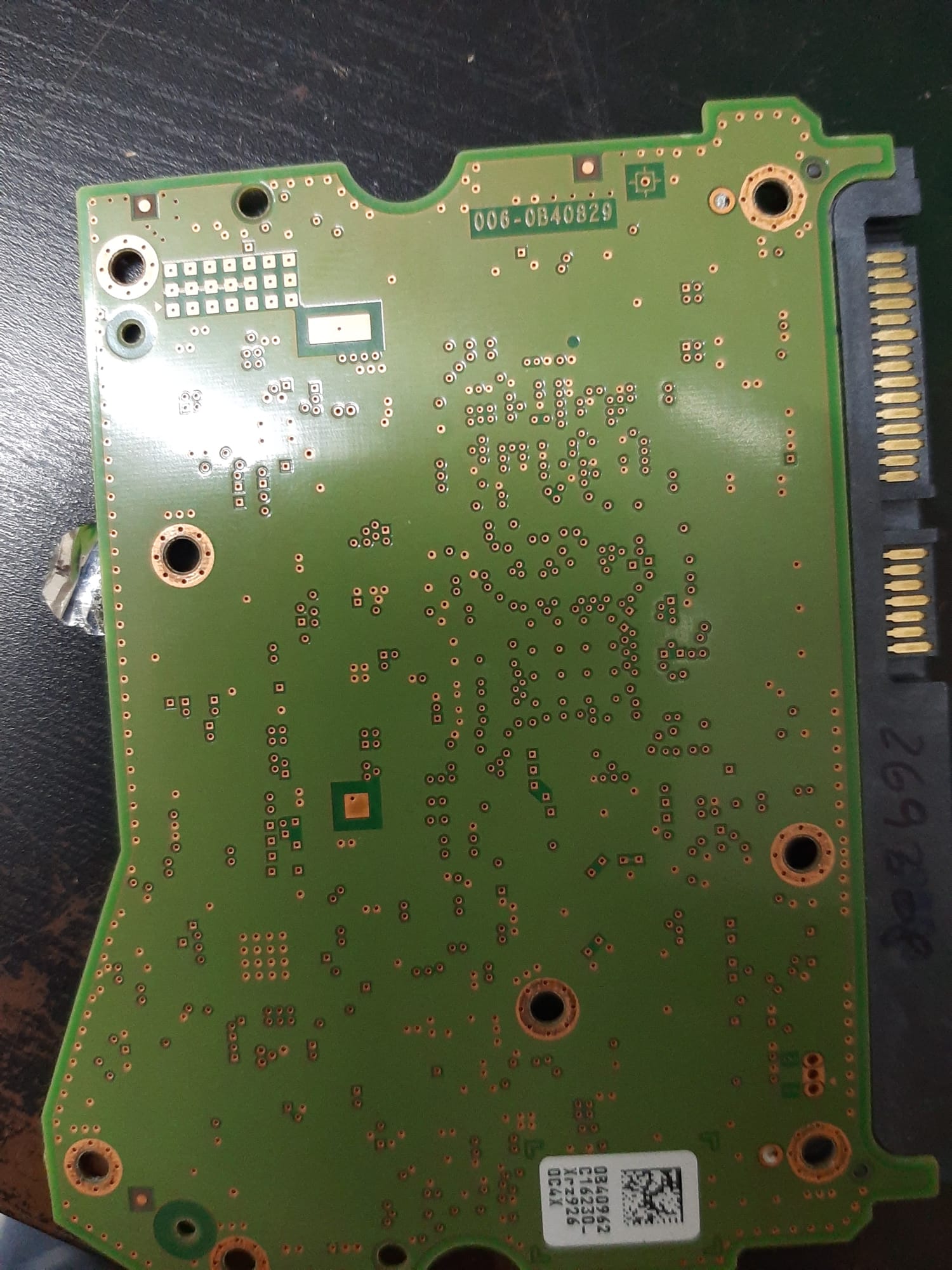

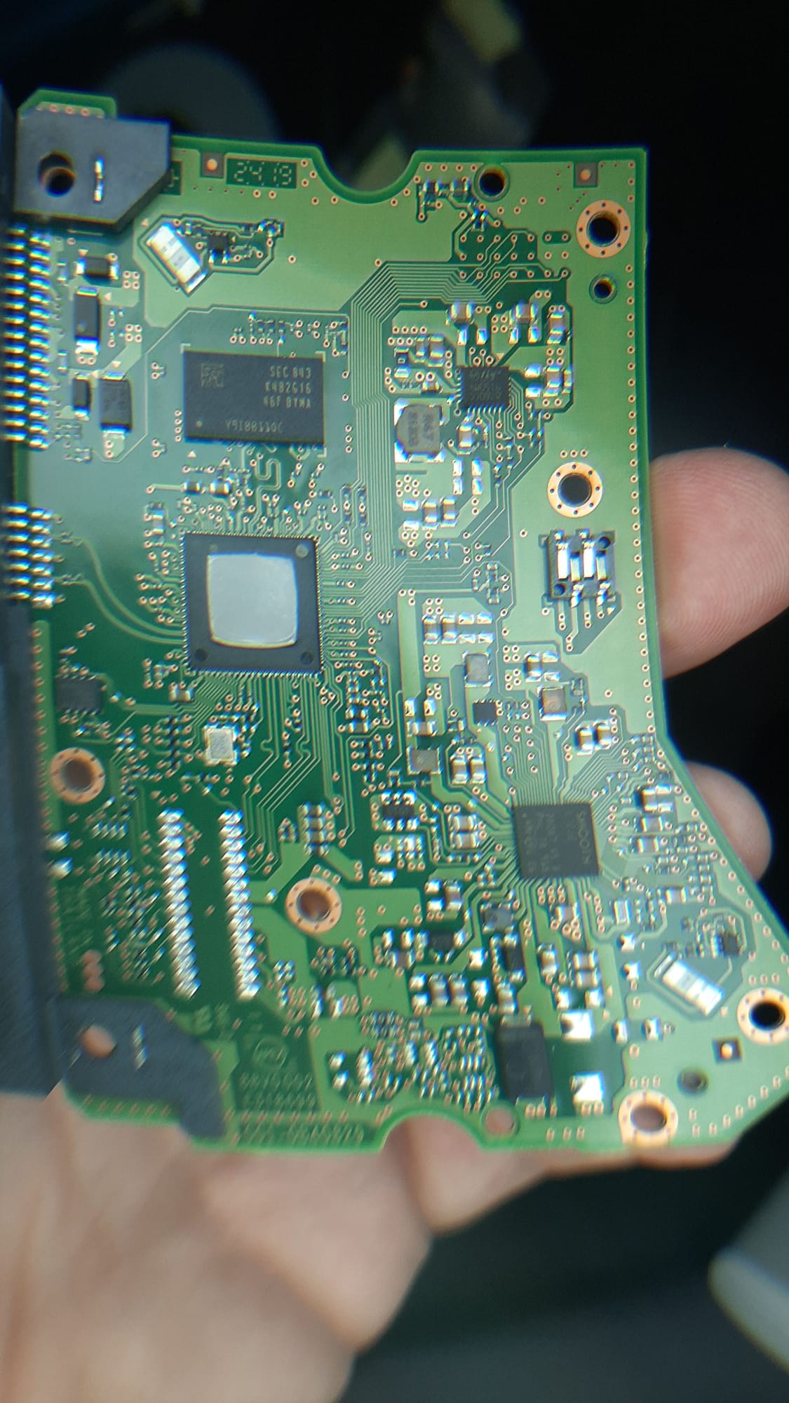

Hi Guys, a customer brought me an 8 TB WD hard drive with the following pcb 006-0b40829. The motor does not spin, it is possible to hear a small noise as if it wants to start but it does not start, in MRT it remains in the BSY state, removing the pcb and leaving it alone it remains in the BSY state. According to the client, the problem arose after a small bump. Suggestions?, Thanks

Hi guys I think it's bad pcb, the motor it's free to spin, no lock, suggestion for repair ? any friend have a schematics ? Tks
If you can provide a better photo (with a CCD scanner ?) I could identify the voltage test points. That said, I suspect that the motor controller may be faulty.
