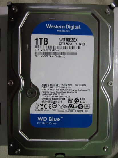

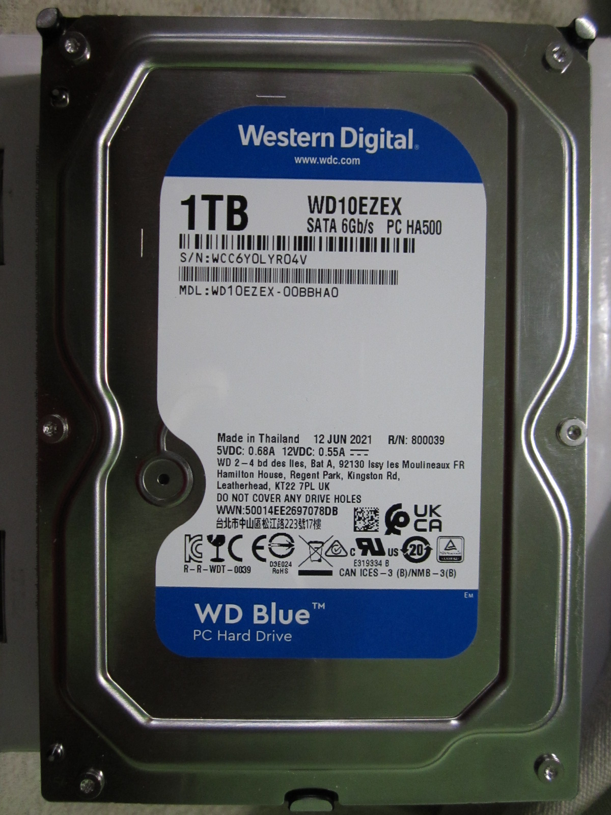

Lately, I have purchased a new HDD with an 1 TB of capacity. It is Western Digital.
And I have tried to save the SA modules and ROM just in case in the future the PCB may be damaged.
The HDD I have purchased is exactly the following model:
WD10EZEX-00BBHAO
Date of manufacture: 12th June 2021

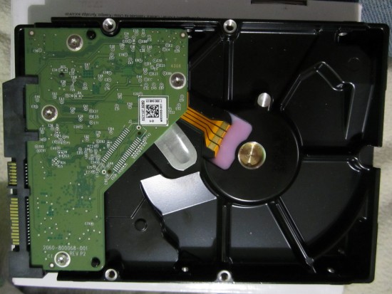

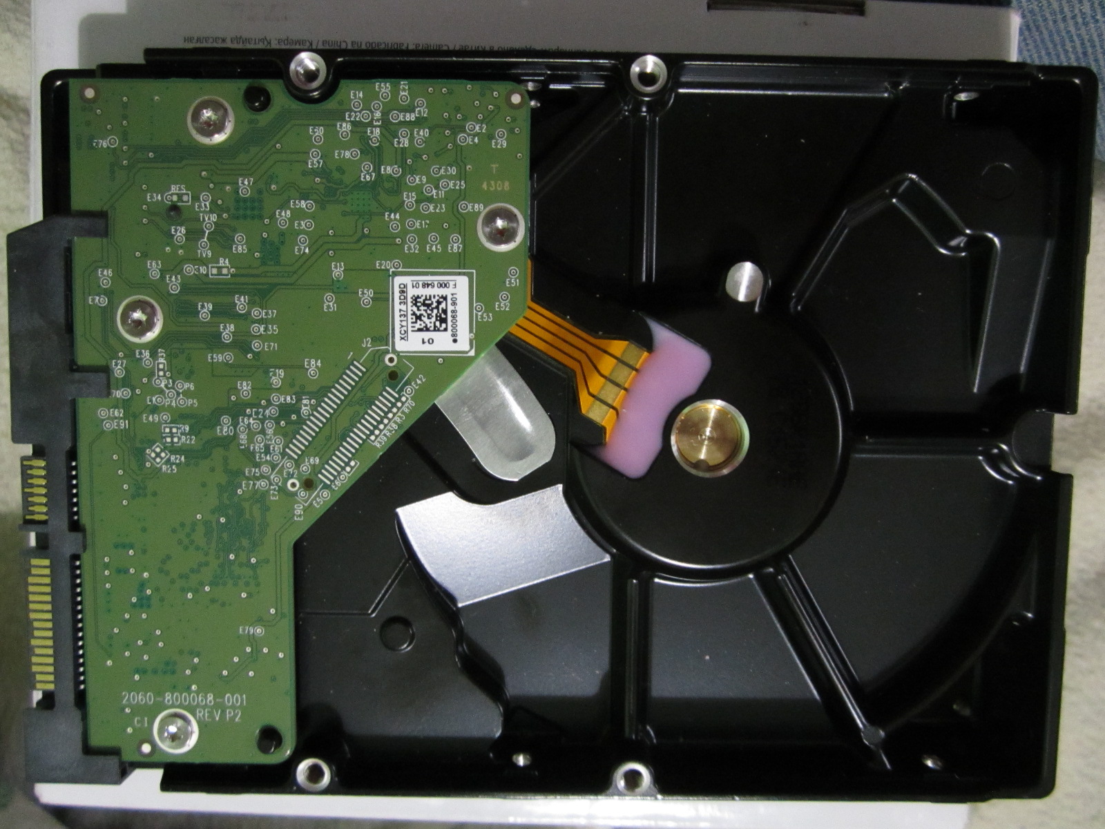

The PCB model for this HDD is as follows:
2060-800068-001 REV P2.

I have a copy of all the SA modules and the ROM I have managed to save. I hope they are really valid. And there are also two photos of the HDD (the front and the back views).

I suspect that you have a 1024KB ROM which is divided in two redundant halves. One half is a backup of the other half. I believe that WD does it this way to provide a recovery path in the event of a failed firmware update.
The "2060-800068" PCB is a locked 2.5" PCB whereas your drive is an unlocked 3.5" model. :-? That's strange.
The "R/N" code on the label is "800039" which would suggest that the PCB should be "2060-800039". Is this an error in the artwork ???
https://www.hdd-parts.com/18093027.html
WD's warranty checker identifies the drive as belonging to the "TRESUL" family (Tressels Ultra ???). You should see the family in SA module 0xC5.
    WCC6Y0LYR04V
    WD10EZEX-00BBHA0
    TRESUL

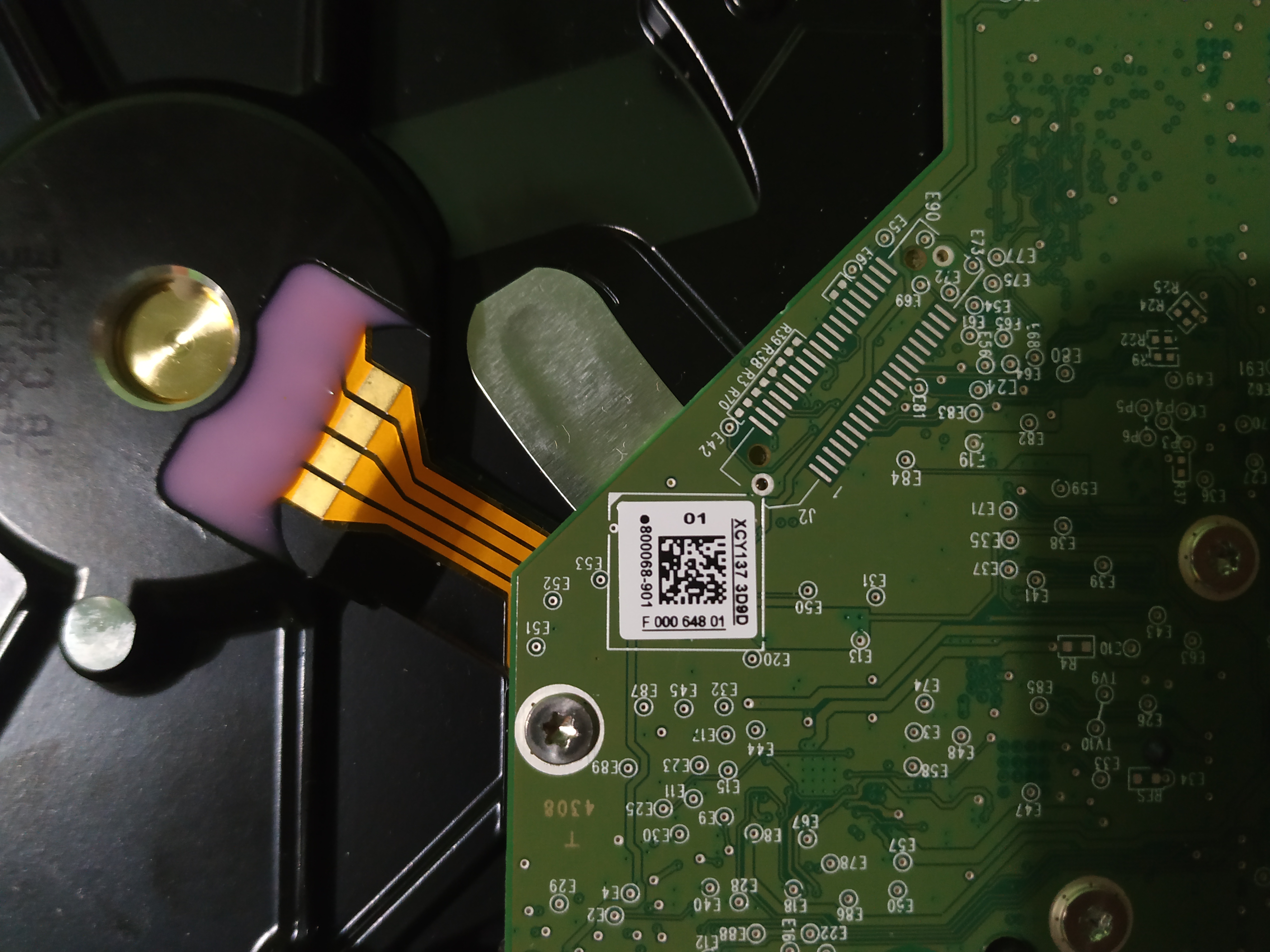

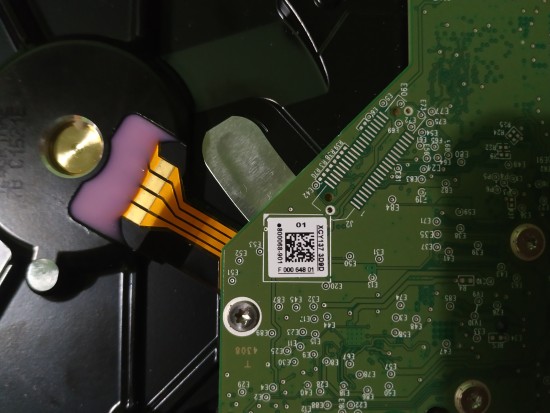

I have taken a closer photo to the sticker which is on the PCB.
And when scanning the QR code, I get this:
XCY1373D9DF00064801
It is also written the following on the PCB sticker:
"800068-091".
The just mentioned number is apparently the exact PCB model.
You can take a look at the photo of the PCB sticker enclosed with this message.
File comment: sticker on the PCB

It looks like Dolphin made a mistake.
Yes, the USB C 2.5" board is 2060-800086, not 68. Someone got dyslexic with the numbers and repeated the mistake throughout the entire article.
