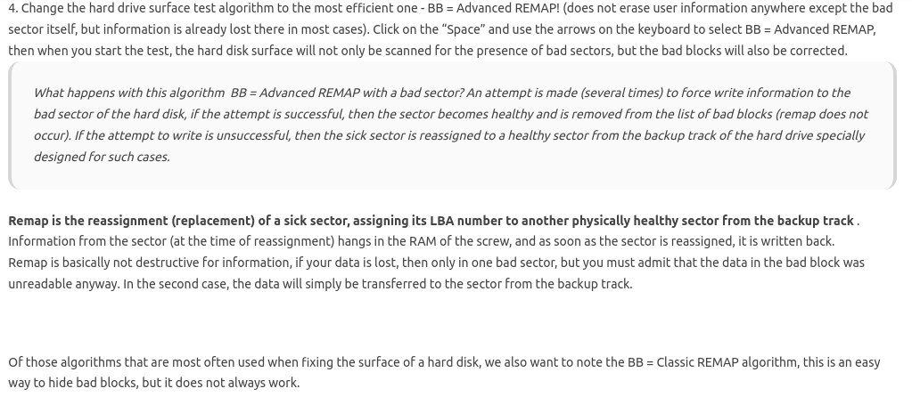

I've been using DOS Victoria to scan & remap my SATA 1TB disk. I've tried the Windows version but it simply stops at the first 'defect'. There are 2 options for remap in the DOS version (Classic & Advanced) but I can't find out what the differences are. Does anyone know?

I found the attached on a site in Russian & translated via Google, so am guessing that 'Classic' does not try to recover the bad sector.

Seems little strange those remap options, because as explained a classic remap is finally not a remap. (or perhaps it is just not forced to remap, like it let the drive doing what it want)
Can you share to us the url please :)

Here's the translated page I pasted from, section 4 has the remap description:
https://support-easysoft-ua.translate.g ... _tr_pto=sc
Original page:
http://support.easysoft.ua/diagnostika- ... -victoria/
Here's another translated page with a good explanation:
https://ab57-ru.translate.goog/hdd.html ... _tr_pto=sc
Original:
https://ab57.ru/hdd.html
