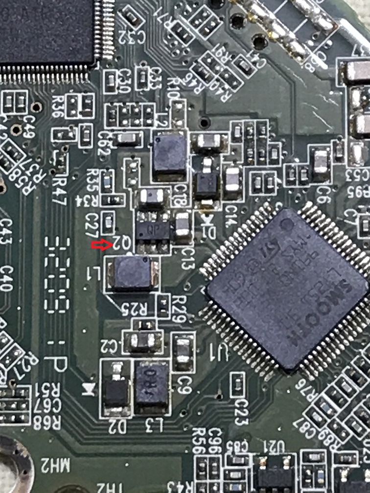

PCB:
2060-771668-000 REV P1
This is a known good working board.
I have a question regarding the Q2 MOSFET. Where is the "source" 3.5V generated from? Is it coming from the SMOOTH controller or another part of the PCB?
The 4 "drain" pins are all 1.2V and I suspect they are step downs to Vcore.
I ask because, on 2 boards that are malfunctioning, the source voltage is always lower than 3.5V, so who is making 3.5Volts?. Thanks!
Re: 2060-771668-000_P1 MOSFET question
February 23rd, 2022, 18:45
Without much checking, i think that should be 3.3 and it should come from another buck converter... but hey, isn't it possible to track it?
