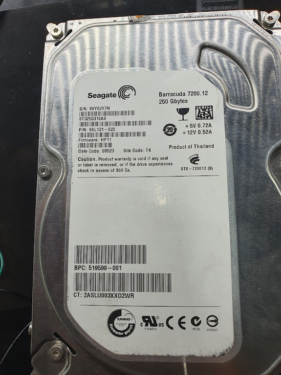

Hi all
I have a ST3250318AS firmware:HP11 SN:9VY0JY7N DateCode:09523 Thailand.
After a power surge it does not boot anymore.
Measured Controller board - without shorts.

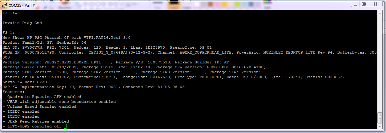

Dumped the SPI Flash. Measured coils resistance ~3.6ohm each.
Powering it:
- The sounds seems OK (motor speeding up, some reading noises).
- Plugged into USB-SATA adapter on windows (omg.. did i make it worse?) and it detected two partitions but can't retrieve partition names nor read data. On Linux read error messages, also detects partitions sdc1 and sdc2
Can someone please help me with this? Maybe some file on System Area? How to proceed?
Serial terminal access:
F3 1>
New Skews HP_PSG Pharaoh 0F with VTPI,RAP16,Yeti 3.0
Product FamilyId: 3F, MemberId: 06
HDA SN: 9VY0JY7N, RPM: 7201, Wedges: 120, Heads: 1, Lbas: 1D1C5970, PreampType: 59 01
PCBA SN: 00007951L7P0, Controller: YETIST_3_0(649A)(3-12-3-2), Channel: AGERE_COPPERHEAD_LITE, PowerAsic: MCKINLEY DESKTOP LITE Rev 94, BufferBytes: 800000
Package Version: PH0G2C.HPD1.DS022H.HP11 , Package P/N: 100573513, Package Builder ID: AT,
Package Build Date: 05/18/2009, Package Build Time: 17:02:44, Package CFW Version: PH0G.HPD1.00167620.AT00,
Package SFW1 Version: C23D, Package SFW2 Version: ----, Package SFW3 Version: ----, Package SFW4 Version: ----
Controller FW Rev: 05181702, CustomerRel: HP11, Changelist: 00167620, ProdType: PH0G.HPD1, Date: 05/18/2009, Time: 170244, UserId: 00236537
Servo FW Rev: C23D
RAP FW Implementation Key: 10, Format Rev: 0001, Contents Rev: A1 05 08 03

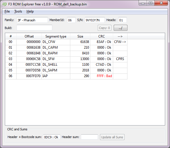

1) BIOS ROM seems to be OK. Is there any further check I can do in it (bitflips and other problems)?
2) This HDD has only one head. Using terminal I was able to read attached SA files. They seem OK (there are strings, patterns, and so on...doesn't look like garbage). Does it mean that the head is at least "good enough"? Are the adaptives files supposed to be the "same" as in the ROM (as per F3 Rom explorer CAP+RAP+SAP)?
3) Please point me on how can I try to read user data using terminal?

1. Flips and rot would produce checksum errors.
2. Reading the SA confirms the SA can be read and the head is not dead.
3. You're misunderstanding your problem.
