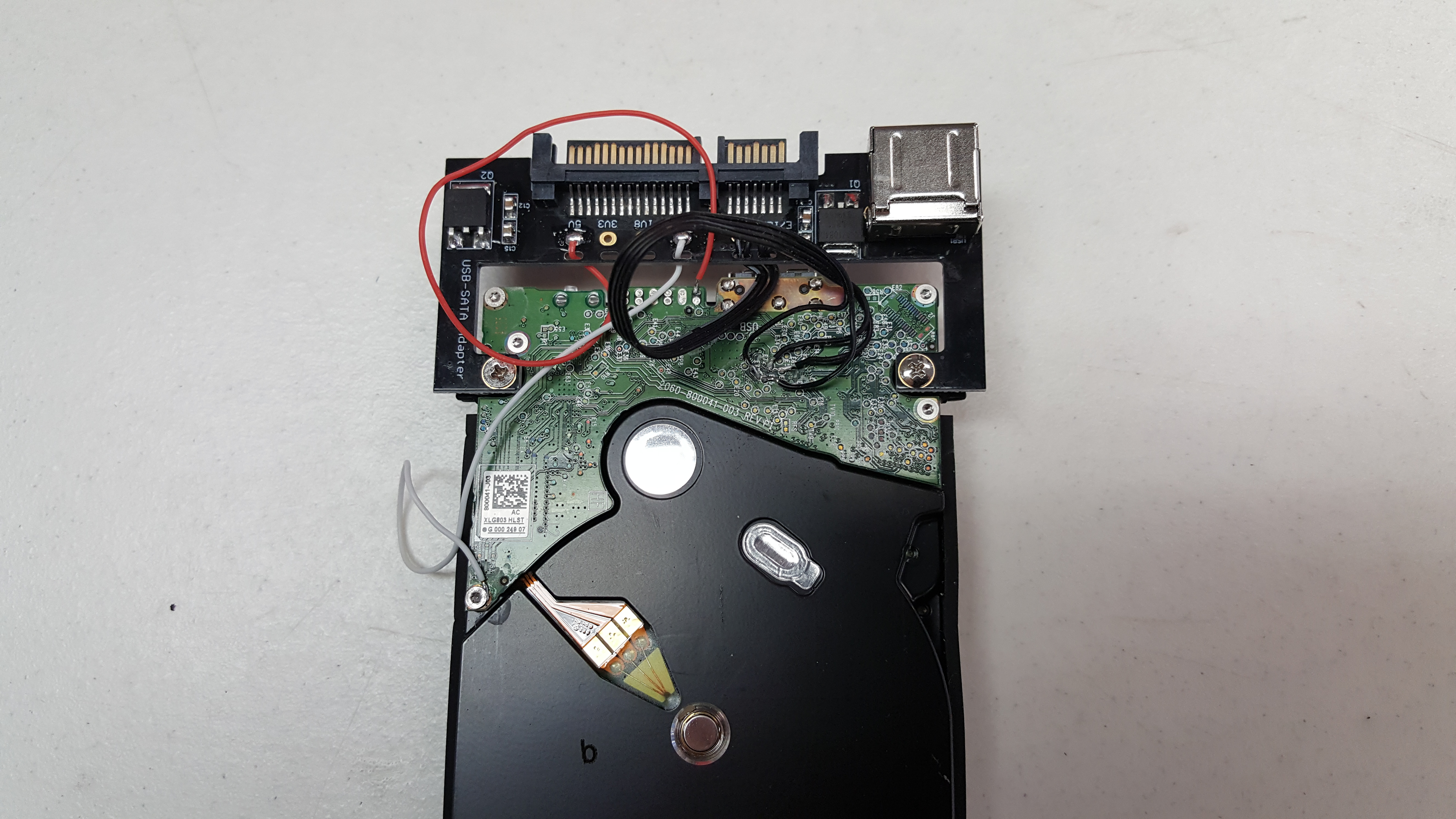

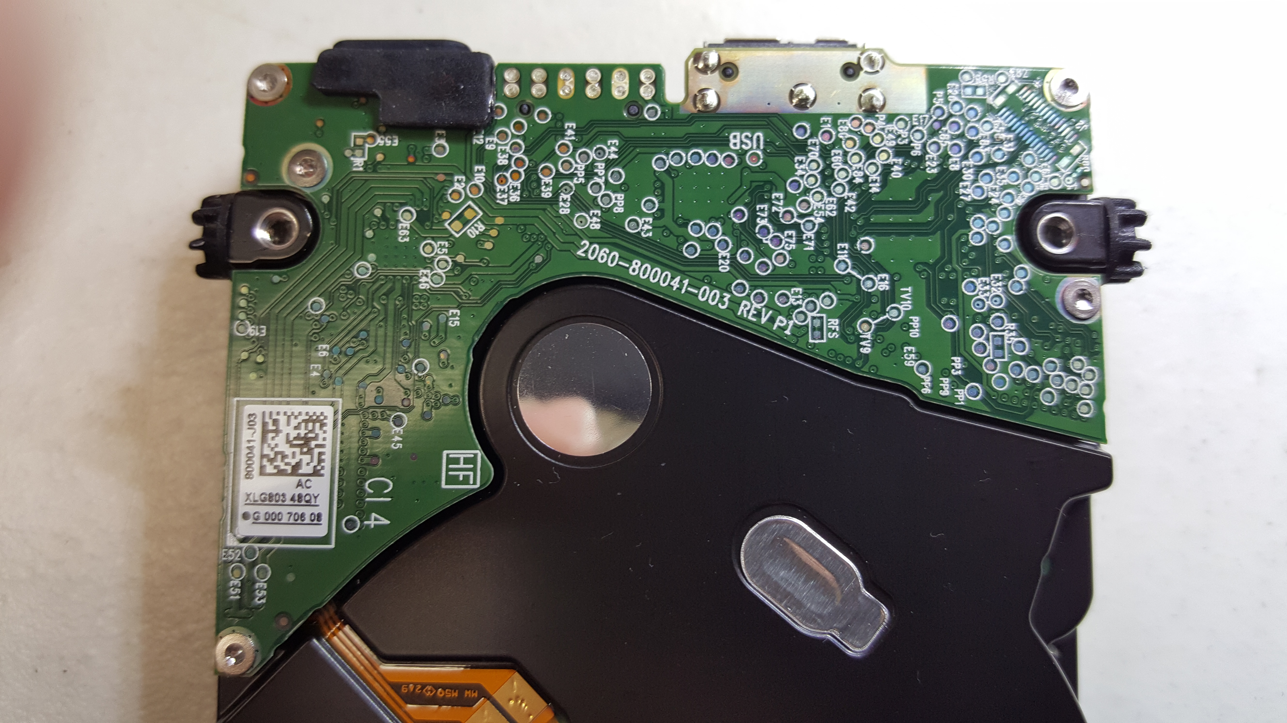

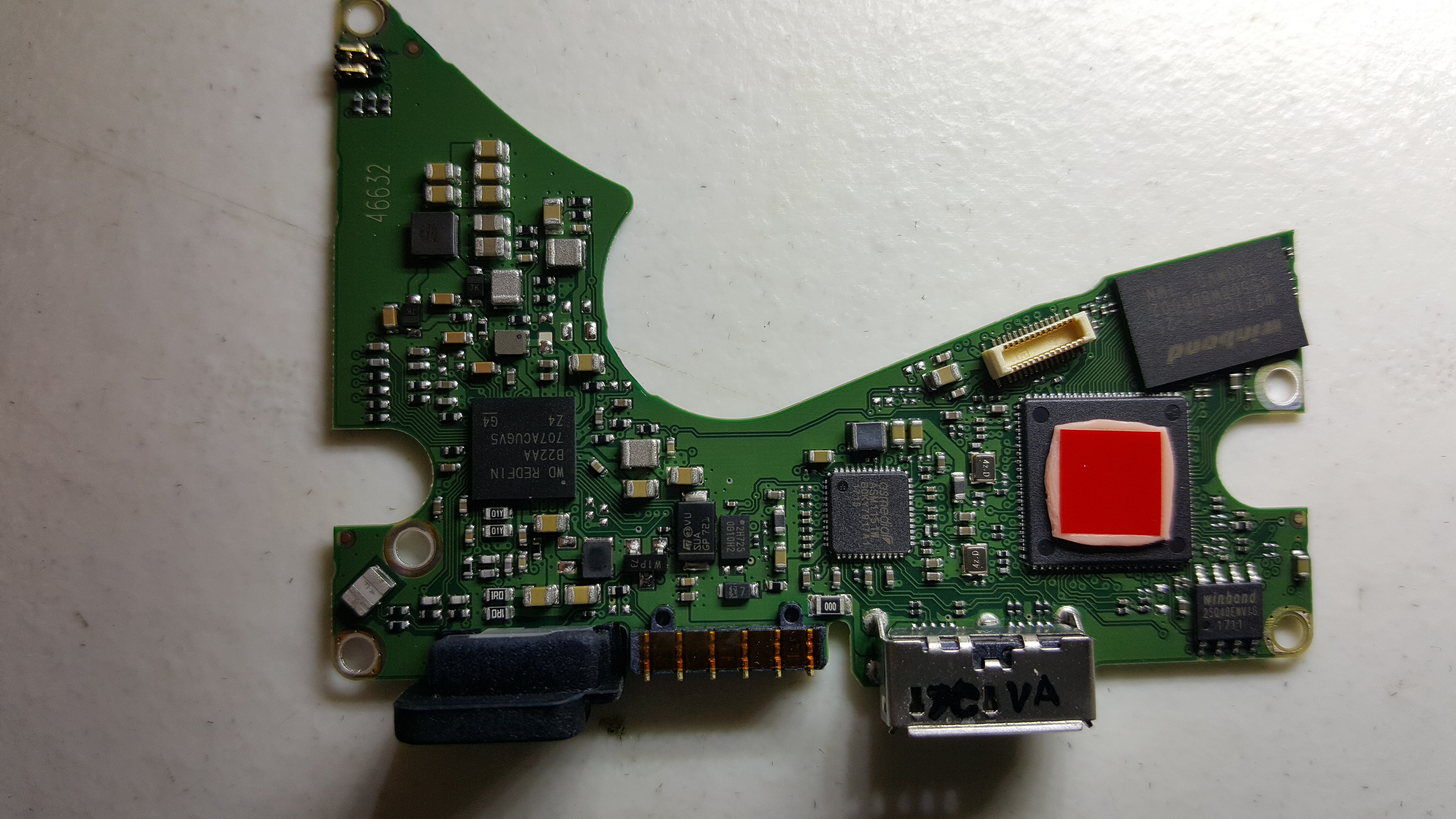

I'm using one of these "Flying Line Jump Wire Boards" to convert the WD USB PCB 2060-800041-003 to SATA for a recovery. Was wondering if someone could point out the 4 capacitors that need to be desoldered on the PCB as it is unclear to me on this board.

I think these are the ones.

Thanks fzabkar!
