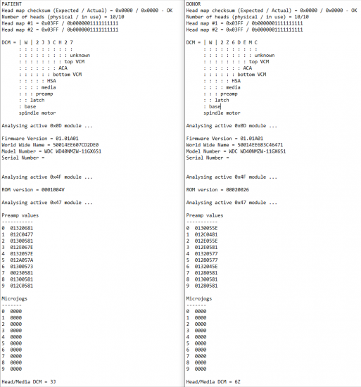

In the past, I've been always lucky with Spyglass HSA swap. I got a new case and instead of waiting for luck, I would like to find out what is important/critical for the donor to match. I find WD much easy to match than Seagate.
My donor have same pre-amp than patient, is this always enough ? Thanks to fzabkar for the ROM parsing tool.
Sam

You're looking for a definitive answer in a best practise environment. I'm sure you have already read these but in case you haven't :
https://www.blizzarddr.com/western-digital-head-swap-donor-drives/
https://www.data-medics.com/forum/threads/wd-hdd-head-swap-experiences.1249/

thank you for your post. Yes, I've seen this and it's always helpfull. For you what is the order from easy to difficult brand to find good donor ?
WD seems to be more flexible than Seagate.
I would say
WD (easiest)
Toshiba
Hitachi
Seagate
 Post subject: Re: WD Spyglass 4TB - HSA Donor Match
PostPosted: March 6th, 2022, 5:15
Toshiba is definitely the easiest.
Matching the model is good enough most times.

I don't do the volume of swaps larger labs do so it's difficult to say really, but it's certainly easier to find donors for most wd and seagate than it is for hitach, very rarely get toshiba drives in.

Matching HSA (third character past bracket) works for me.

I did the swap and it's working without problem, i am cloning. Those WD are not the worse. I have more problem with charger familiy
