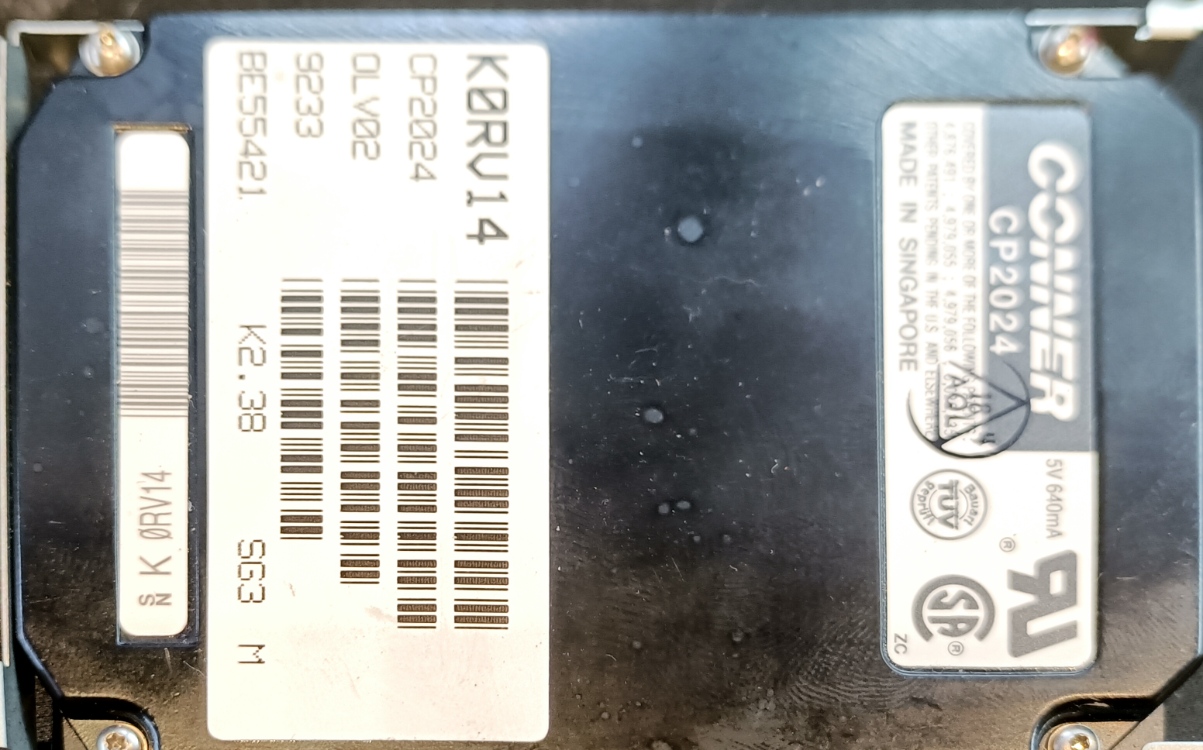

Hello - I've just got an Olivetti Quaderno 20 with a Connor CP2024 HDD fitted. The machine is completely dead so I have no way of confirming whether the drive works or not.
It appears to have a 48 pin SCSI2 connector (from research on the web). How do I connect this to my modern PC to test?

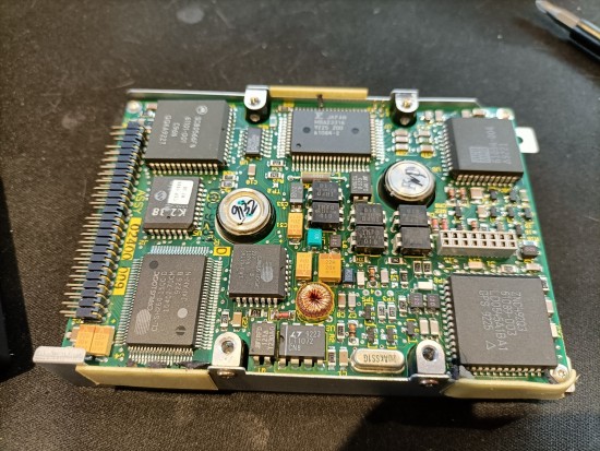

The interface controller is a Cirrus Logic CL-SH260 Enhanced PC XT/AT Disk Controller:
https://datasheetspdf.com/pdf-file/556284/CirrusLogic/CL-SH260/1
Is it a 44-pin IDE connector plus master/slave jumper block?
