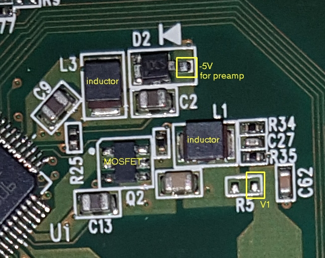

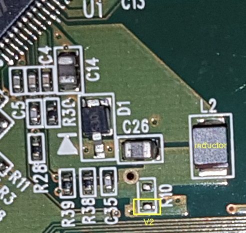

I have a 2tb western digital HDD that does not seem to spin up and is completely silent. It does not show up in windows, however it is detected in the BIOS and displays its correct model number but the capacity shows up as 0GB. The HDD worked fine prior to a power outage so I used a multimeter to confirm that the PCB wasn't damaged. Upon checking it appears that diodes D1 and D5 have failed. Is there any way to fix this drive to the point I can recover the data? I was thinking of replacing the diodes but I have no Idea the model or make to replace them with. I would appreciate any advice you guys can give me that can help fix the drive. Thanks in advance and hope to hear from you soon. Please refer to the links below for images of the PCB.

Nice clear board pics, D3 and R67 are worth checking as are D4 and R64. I'd be concerned if D1 is blown, I believe that's protection for smooths VCC although I don't have a datasheet for L7251. fzabkar has made a number of posts about the poor power protection design on WD's, are you sure it was power outage and not psu cable related?

D1 is a flywheel diode for the Vcore or Vio regulator. If it were faulty, then I can't see how the MCU would work, in which case the drive would not ID.
I have no idea what D5 does.

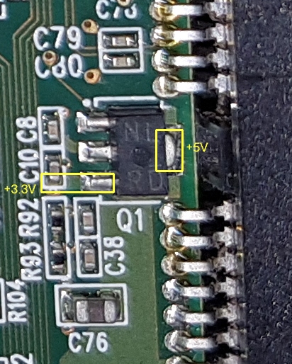

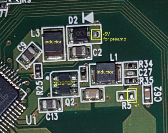

I would think all the supplies would be OK, but you can measure them just to be sure.
Is it possible that the drive has been configured to power up in standby (PUIS)?

Measure the voltages.
Launch HDAT2 with the "/w" switch, or boot from a live Linux distro.
If the voltages are OK, and the drive doesn't wake up, then transfer the ROM to a donor PCB.
