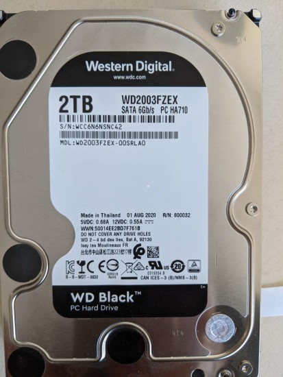

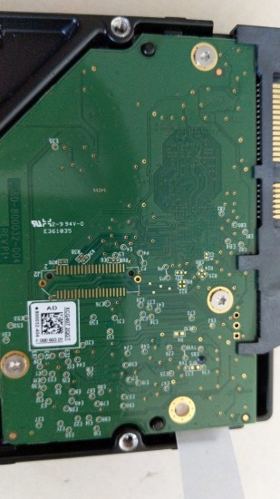

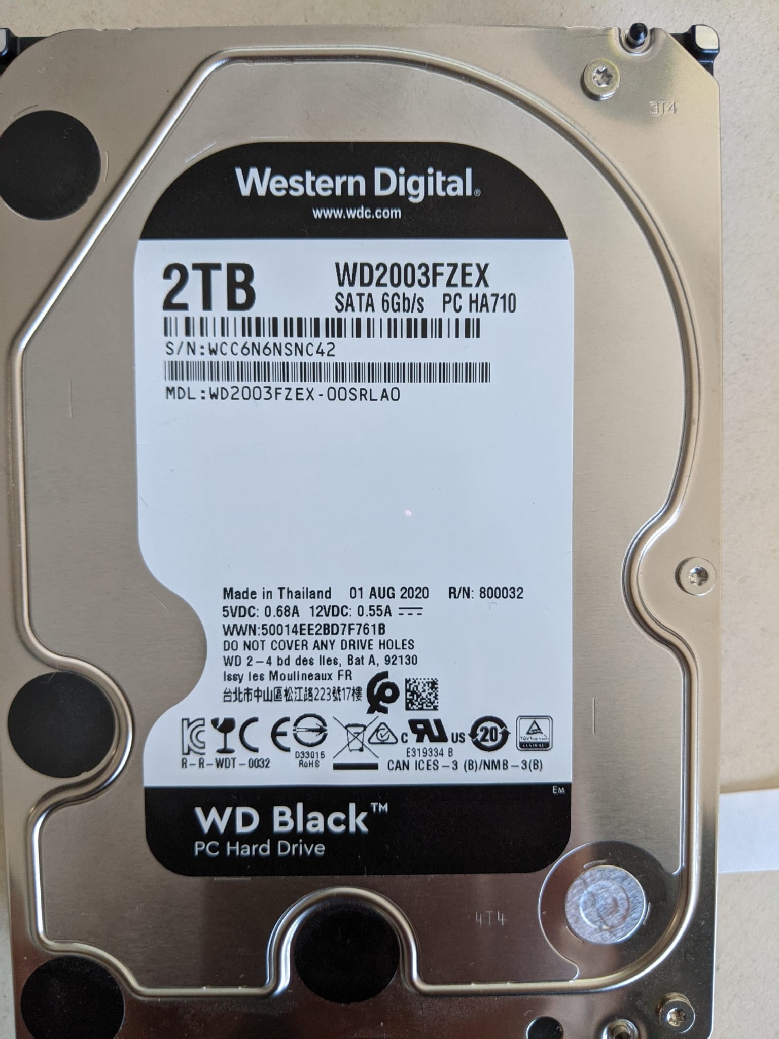

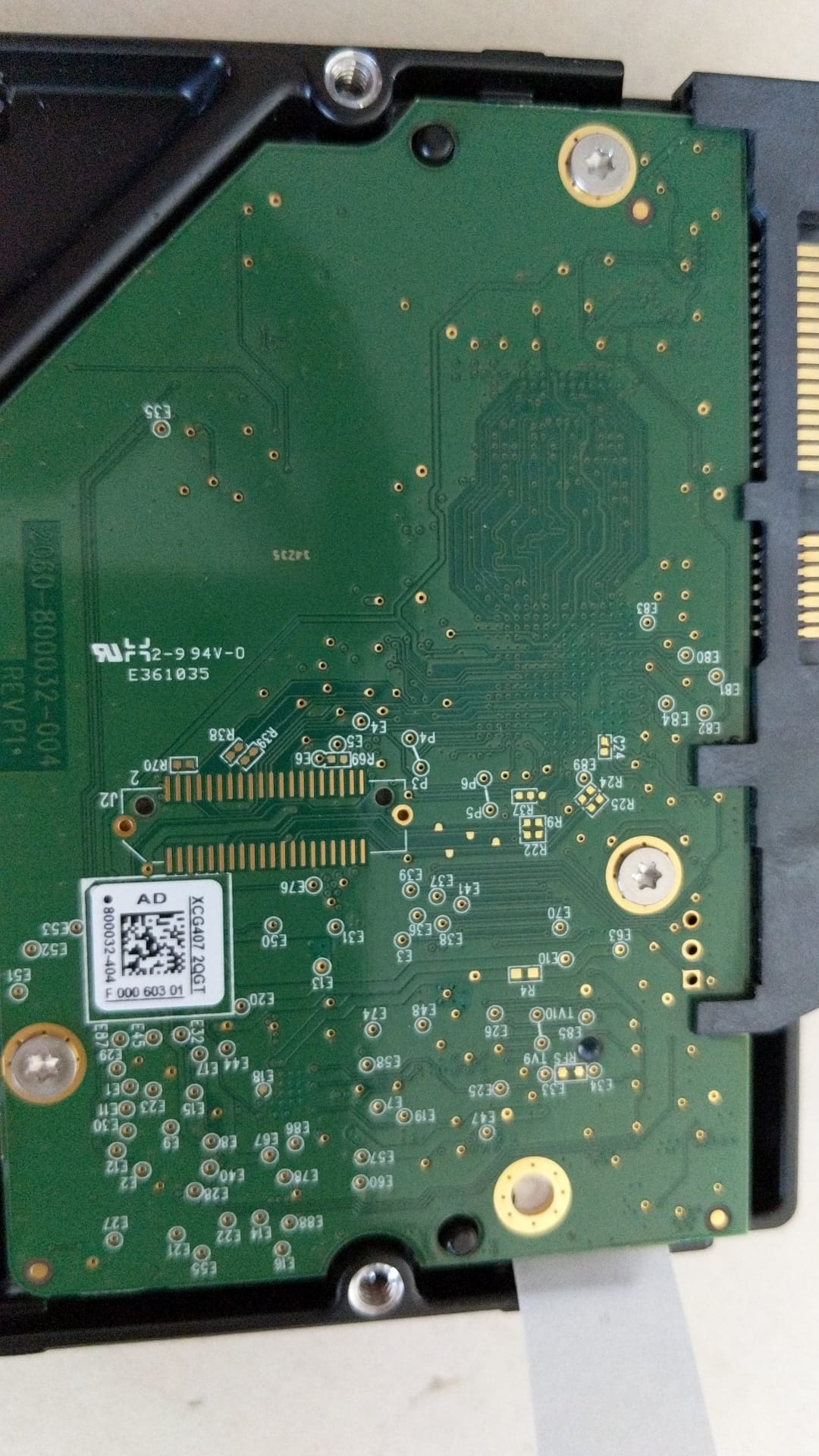

 Post subject: WD2003FZEX-00SRLA0 - Unknown family ?
PostPosted: March 23rd, 2022, 10:42
Posts: 191
Location: Switzerland
Who knows family name ?
 Post subject: Re: WD2003FZEX-00SRLA0 - Unknown family ?
PostPosted: March 23rd, 2022, 10:53
Posts: 1312
Serial Number lookup :
WCC6N6NSNC42 OUT OF REGION WD2003FZEX-00SRLA0 RAINIER 7200 64M SATA3 6GB/S 2.0 TB 4HD AF SHP STD 27-Sep-2025
PostPosted: March 23rd, 2022, 11:07
Posts: 191
Thank you. Is RAINIER family supported by MRT ?
PostPosted: March 23rd, 2022, 12:14
Posts: 17223
I believe Rainier utilises the new HPA (Arch 7) firmware architecture. If you dump the ROM, I will be able to tell you for certain.
