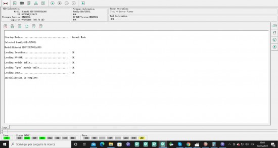

Hi friends I have this hard disk that behaves in a very strange way, when I try to read any sector the engine stops and stays in bsy. I replaced the pcb and also the heads but the result is identical. Do you have any suggestions?

i would take a look at translator/adaptive modules...

When i try to rebuild translator, the motor spin off
