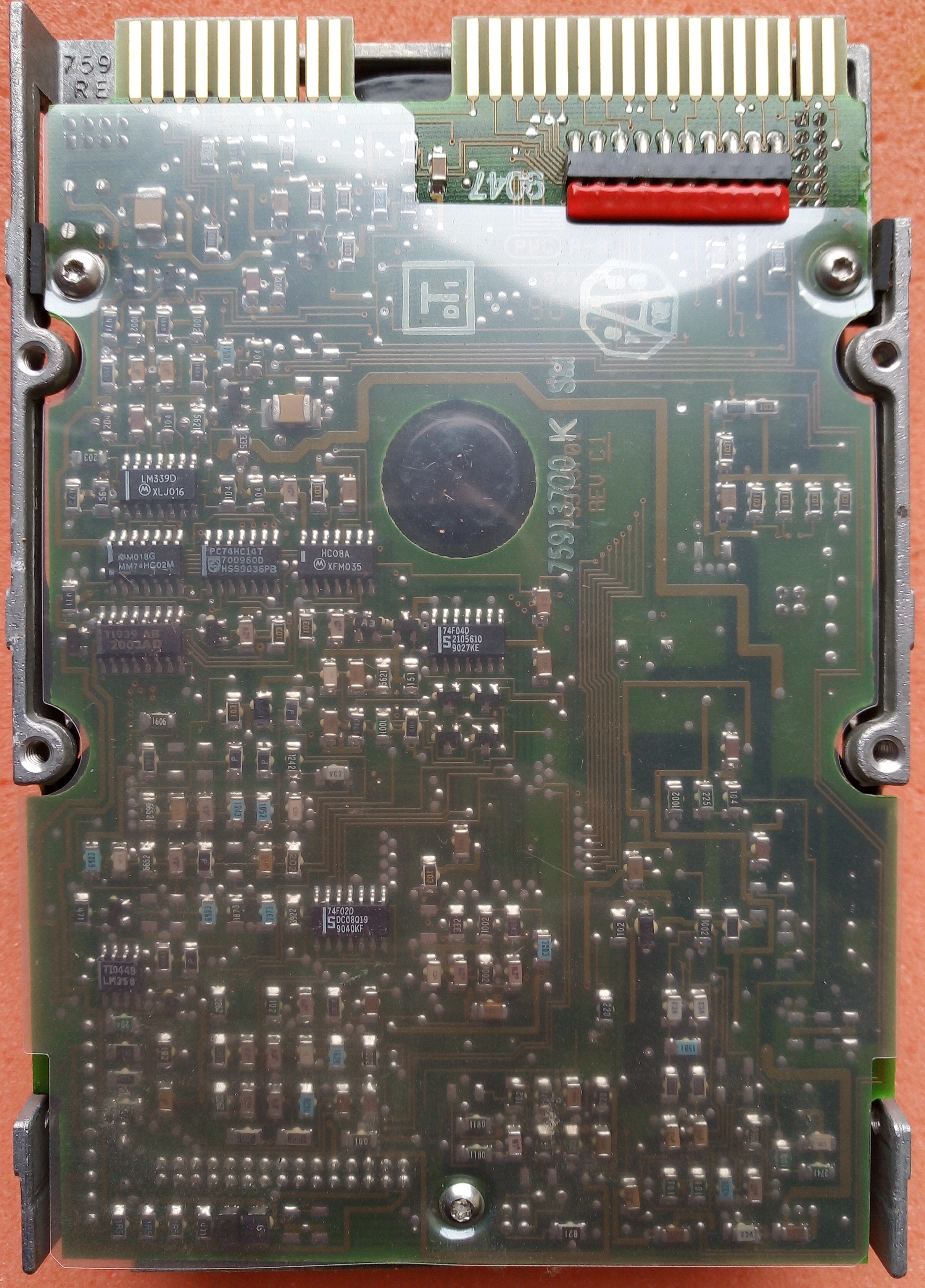

I'm trying to make a Seagate ST1100 83 MB MFM drive working.
It behaves in quite a strange way however; when I format with only head 0 it formats flawlessly without any bad sectors, but when I use more than that one head, it generates a lot of errors - SpeedStor even gives up because the error table fills up.
What puzzles me though, is the fact it throws such errors even when LLF'ing with head 0, which otherwise works flawlessly on my Myarc HFDC (TI/99 controller).
Also, when using a Seagate S11M controller on a PC, I'm not able to enter the correct parameters, so SpeedStor is only able to access the system defined 615 cyl/4 heads etc, not the 1072 (or 1024 for that controller) and 9 heads.
It seems to me it's a logic error, not a physical one, since it makes no sense it should have problems with every single head/platter except for the first one...and also the fact SpeedStor throws these errors at head 0 too, where the HDFC formats it flawlessly...?! (which, by the way, also works fine when writing files/dirs, etc.
Could it be the PCB perhaps?

When the drive and controller are idle, what are the voltages on the head select bits at the MFM interface? (HS0 - HS3).
What are the same HS voltages on the drive's MFM edge connector when the MFM control cable is left disconnected?
Is the terminator resistor pack installed?
When you say that "the HDFC formats it flawlessly", do you mean that this controller formats head #0 flawlessly but still has problems with the other heads?
Is it possible that some controllers treat HS3 as a "Reduced Write Current" signal, thereby causing the wrong head to be selected? What happens if you place insulation tape over this pin (pin #2)?

 Post subject: Re: Weird Seagate MFM drive
PostPosted: July 27th, 2022, 22:39
Posts: 17335
If this is your PCB ...
https://www.computerbase.de/forum/attachments/img_20201018_150803_5-jpg.1008787/
... then the odd pins (grounds) must be on the other side of the PCB.

Yes, that's the one. Now I've covered that pin, but it doesn't make any difference. Also, I guess it would only affect it if the program actually sends a RWC signal; otherwise the last head select should be low of course.
I'll try different combinations as well as measure the termination voltages and see what the outcome will be.
Thanks a lot for your suggestions etc! :-D

I got a bit further now. I what I've learned is correct, then the heads are inactive when the pins are high, and when they go to low, they become active.
My measurements reveals a slight difference between three of them; 2.99V on two and 3.20V on the 3rd. H3, however, is sitting at 0.16V which would indicate it tries to activate head 8 along with the others; if so, it's no wonder it won't format properly. c".)
That's the one I modified the output signal for... so either that's done incorrectly (which shouldn't be the case), or the other drive, which has the termination, sets it to low via the resistor pack.
Thus, I'll try again with that drive only, so it relies on it's own resistor pack.
Perhaps you have some suggestions?
