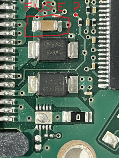

 Post subject: SATA power cable, continuity between +5volt and ground

On my failed drive, i'm measuring continuity between all the +5 volt pins and all the ground pins on the SATA power cable connector. Also, the +5 volt TVS diode has continuity in both directions. Would the power connector shorting between +5 and ground have blown the TVS diode, or would a shorted TVS diode cause this continuity on the SATA power pins? I recently measured another hard drive with a shorted TVS diode and I did not get continuity between +5 and ground on the SATA power pins.

the tvs is in 'paralel' with the power connector, with a fuse resistor added optionally. On an overvoltage event the TVS can get shorted and the fuse blown. If it is blown, the connector pins are no longer shorted, at least if the fuse is placed correctly. Which is not true for older WD boards, where the fuse protects the TVS, so once it is blown, the overvoltage can freely pass to the main circuit and to the preamp inside the HDA.
So, answering your question, it depends on what board you have in hand.

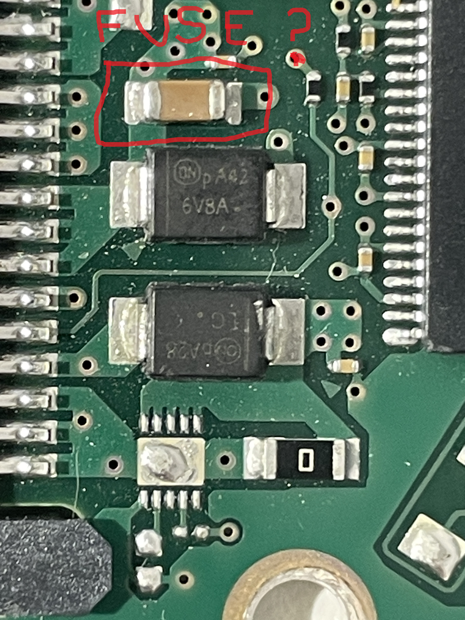

An older 2TB Barracuda. Sorry for the elementary question, i'm just learning about hard drive circuit boards and have not found a comprehensive diagram of components yet, but may i ask, is the highlighted component next to the +5 TVS the fuse? Whatever it is, is also shorted.

That's a capacitor, not a fuse, and it's a Samsung drive, not a Barracuda (Seagate).
Did you do this?
Warning: do not interchange modular PSU cables:
http://www.hddoracle.com/viewtopic.php?f=56&t=2545

Modular PSU cables do not have standardised pinouts. If you reused the cables from your old PSU with your new PSU, then that's what blew up all your drives.

I did manage to save my hard drive though, so all is well. Copying all the movies off it as we speak. Came across an older post by you on HDD Oracle website. I removed the +5 TVS diode and the short between +5 and ground disappeared, so i took a chance and plugged in the drive with an SATA/usb adaptor and it worked perfectly. Have a doner drive on the way so will just replace the diode with one from the doner drive and put it back into service.
