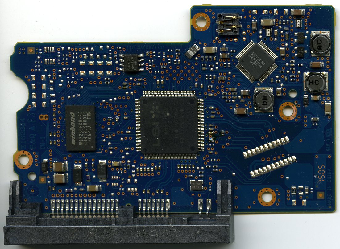

Posts: 17215
Can you show us the original PCB?
There are 4 components you need to measure so that we can tell which supply voltage, if any, was affected.
AFAICT, this model had two different PCBs. Are yours identical? (I don't know if it makes a difference)
https://sep.yimg.com/ay/yhst-14437584971410/91711049-6.gif (0A90381)
https://sep.yimg.com/ay/yhst-14437584971410/91711039-6.gif (0A90377)

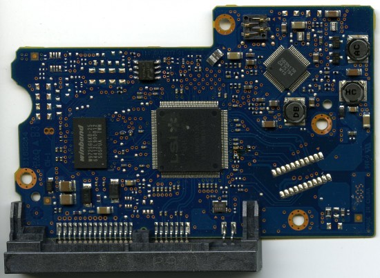

Thanks All,
The HDD was internal from a Lenovo ThinkCentre M81, running Windows 7.
The PCB (see attached) has the number 220 0A90377 01 as did the replacement.
Dennis
 Post subject: Re: Trying to recover data from DT01ACA100
PostPosted: February 7th, 2023, 23:06
Posts: 17215
Near the SATA connector you will see two diodes marked L14 and Z2. Can you measure their resistances with a multimeter? If either is shorted, then this will give us some idea as to what may have happened.

Neither of the diodes are shorted.
I'm concerned, that I tried too hard to get an audio recording with sufficient volume to hear the clicking. I believe folks are hearing a head crash sound when it is really just the motor as the microphone was placed at the bottom of the drive (frame side) close to the motor bearing.
With the naked ear right up next to the HDD, other than the slight whine of the motor you only hear clicking.
I'll try to make a more accurate sounding recording.
Dennis
PostPosted: February 8th, 2023, 18:26
Posts: 17215
Just to be clear, I'm referring to the original PCB, not the replacement.
