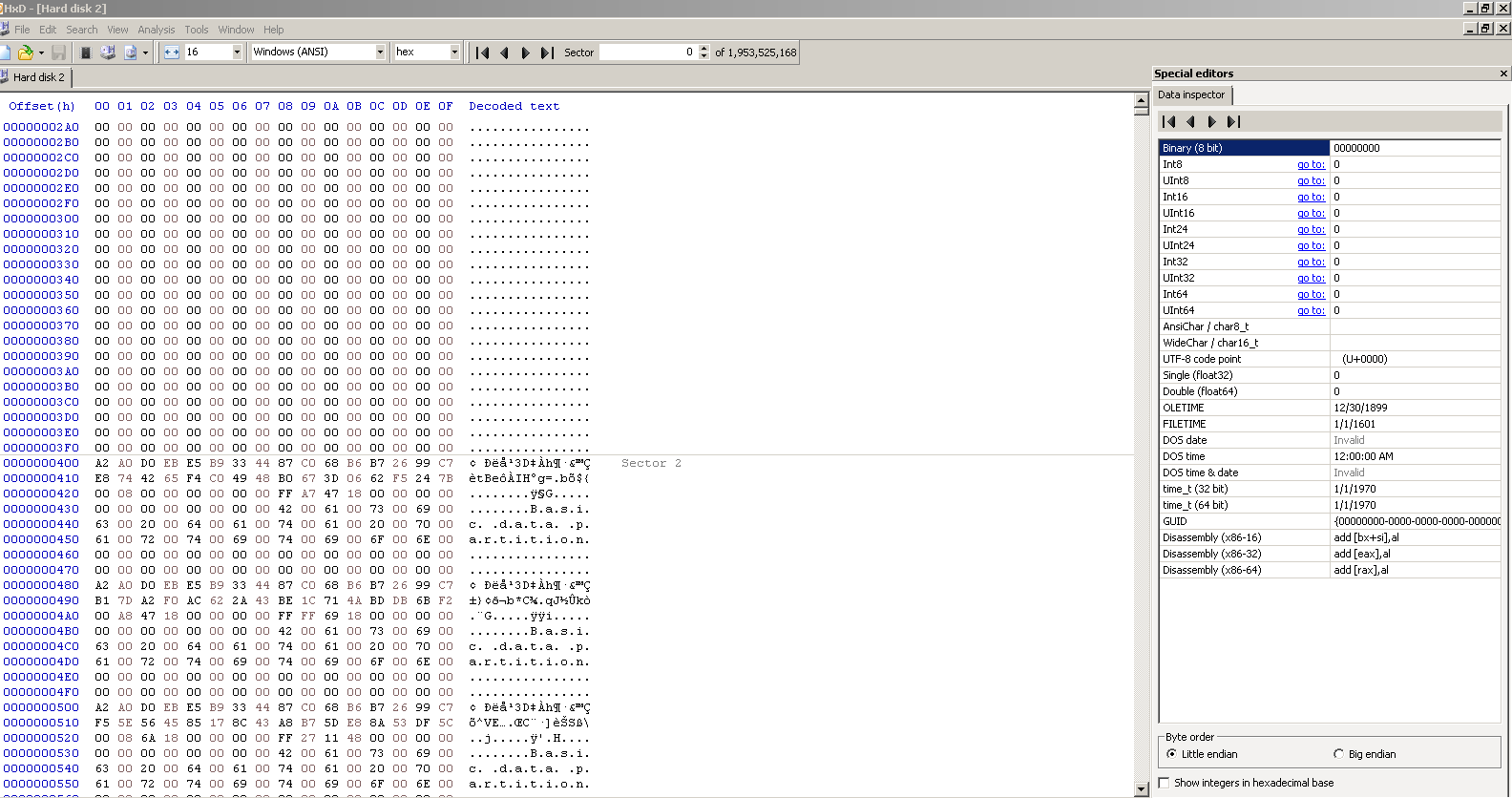

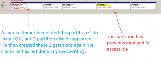

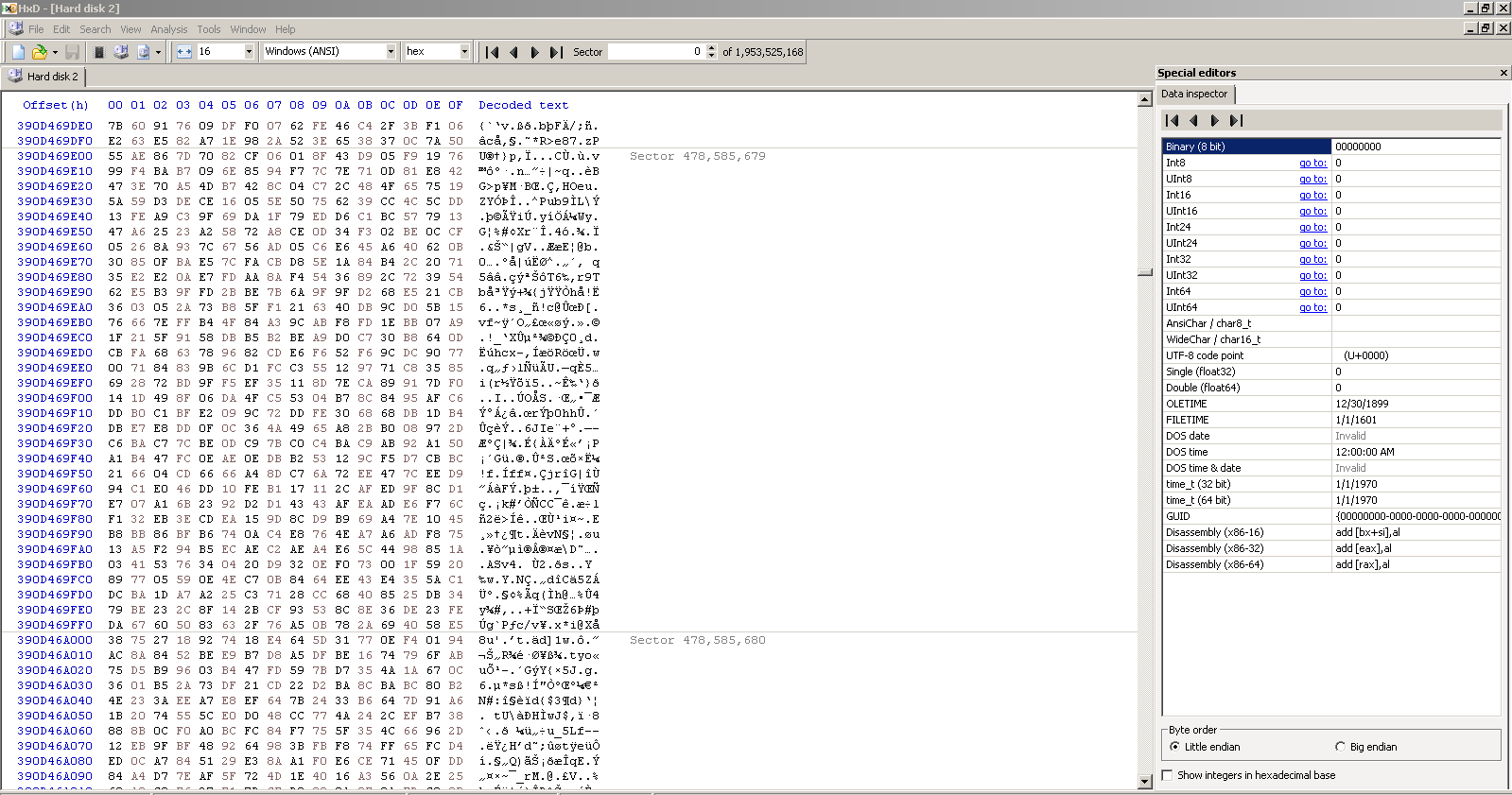

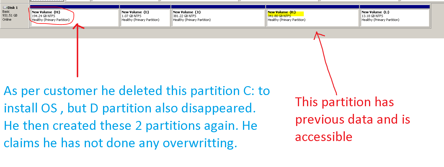

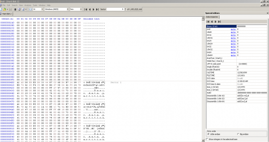

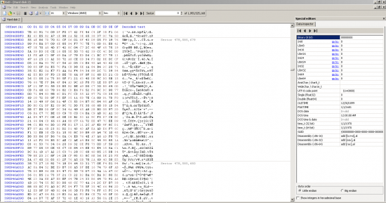

Hi Arch , Thanks for the help.
Customer (computer dealer) has given this disk , it came to him for installation of new OS. He has take backup of C: drive data and kept it in D drive.
Then he deleted C drive. However D drive also got missing . He has not done any overwritting later ,though he has tried to recover data using some tools.
He has copied all data in E drive which is intact and is accessible.
I am not getting either C drive or D drive as claimed by customer. He has created 2 partitions later but has not copied anything.
I am attaching few screenshots.

I do not understand scenario entirely. When he says he created new partitions, did he also format them? If he used disk management he might very well have. If there was a c and d drive, why do we see more partitions thatn those 2, why did drive letter assignments change?
Did he create partitions in exact same locations? What file systems did we have before the chain of accidents?
With all these unknowns, first thing 'd be doing is run full scan on entire disk using DMDE, I'd rather work with that than with too vague stories. Then see from results if I can figure out location of the old partitions. Easiest is, if DMDE detects file systems is top open those (open volume) and check if directories are the ones that can be expected.
