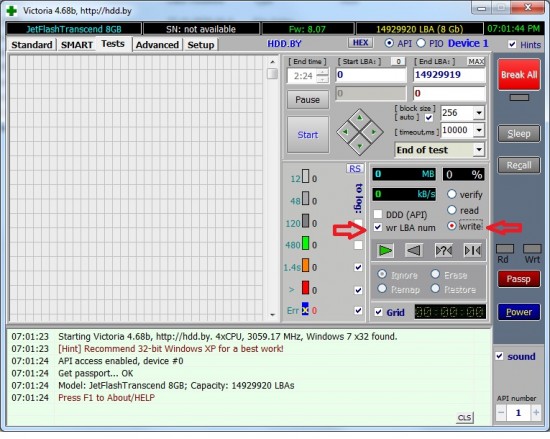

 Post subject: Re: LBA Pattern - To HDD
PostPosted: May 17th, 2022, 5:38
Posts: 347
Location: india

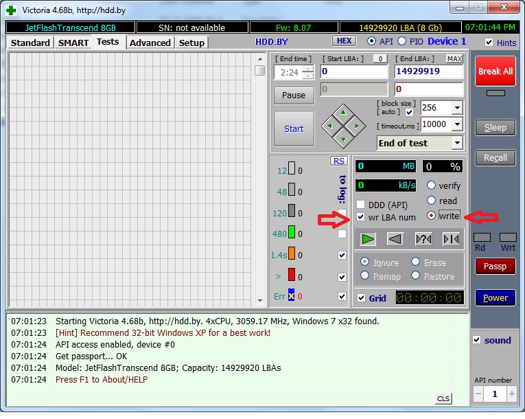

U may try Victoria to write LBA Number like this
May be Your Requirement is different
Note:
I Think you are trying to figure out PBA reading

Were is this setting in victoria GPS
PostPosted: May 17th, 2022, 9:34
Posts: 347
Location: india
IF u Choose to Write that option will be enable

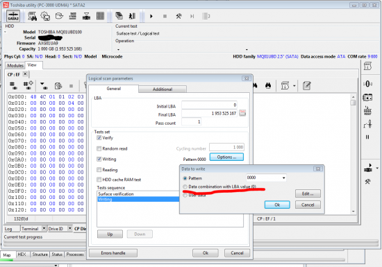

PostPosted: May 17th, 2022, 10:46

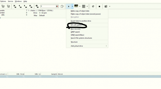

Posts: 4854
any util, logical scan, select writing and select data combination with LBA value

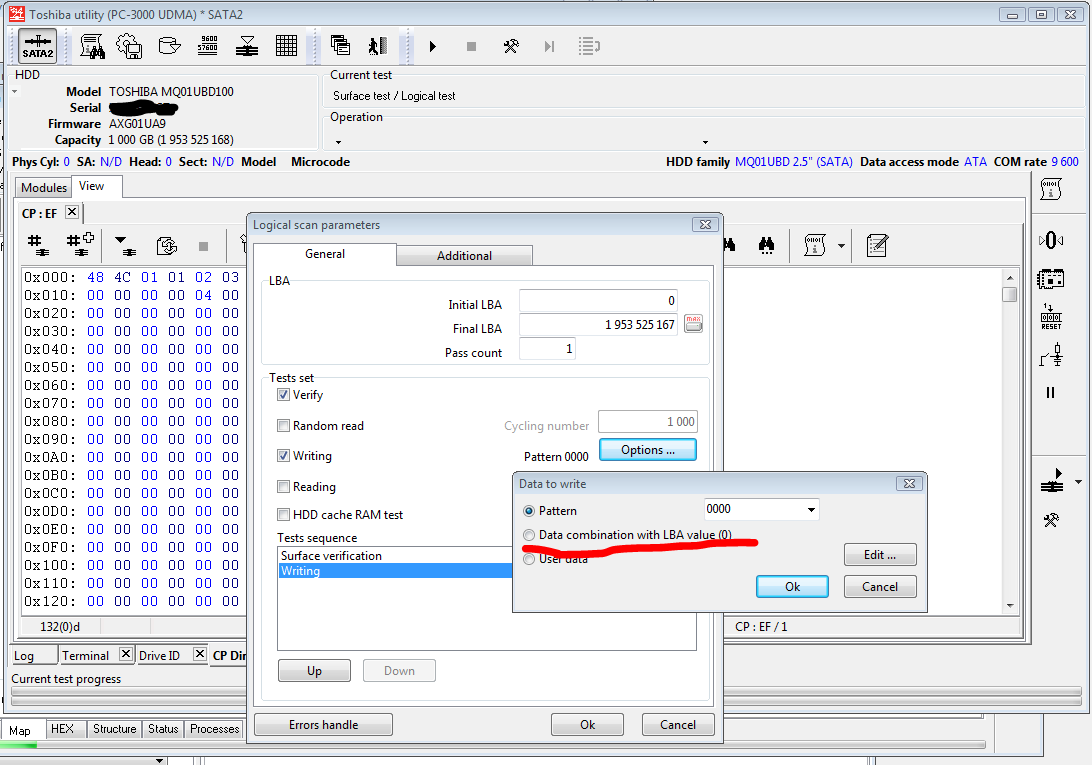

PostPosted: May 17th, 2022, 11:24
Posts: 3551
Also in PC3K,

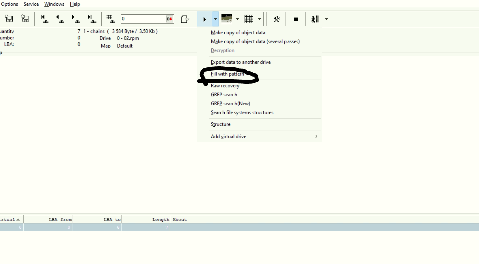

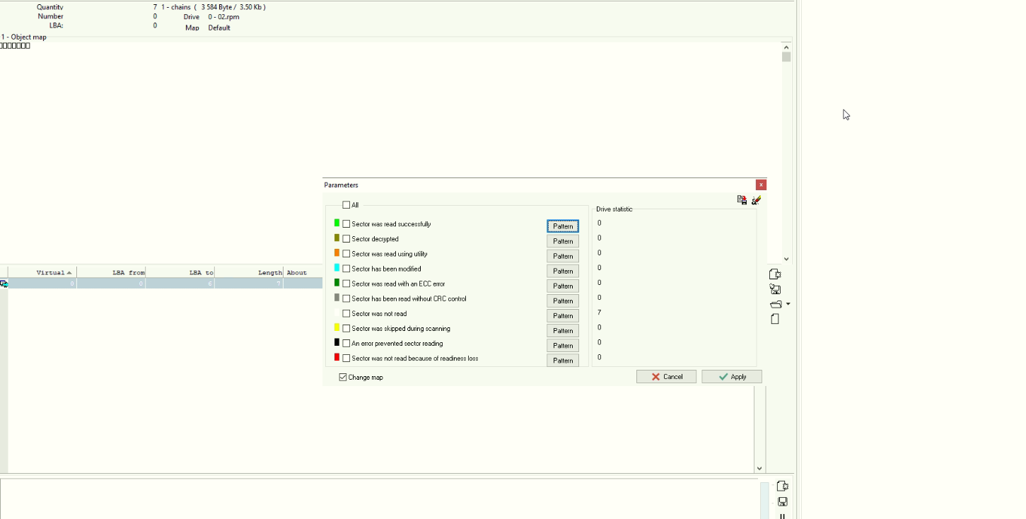

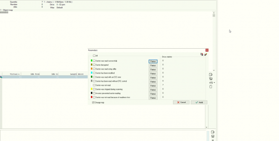

Dmitris, i can't see an option of LBA value there...
PostPosted: May 18th, 2022, 2:23
Posts: 3551
Hi pepe
I thought OP wanted to fill with just a pattern, not the LBA value per se'.
My bad.

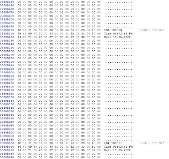

I seem to recall that one of the flash recovery tool vendors provides a freeware tool to fill each sector with the LBA number.
Is this it?
http://www.flash-extractor.com/downloads/Pattern_Writer_v7.rar

Frank ,
I know about this ,I will try my experiment
