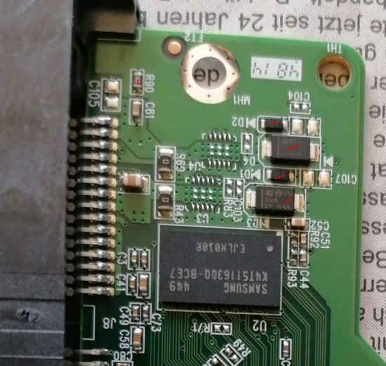

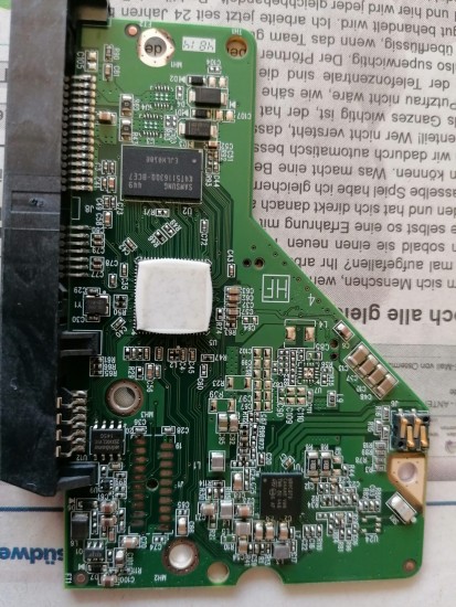

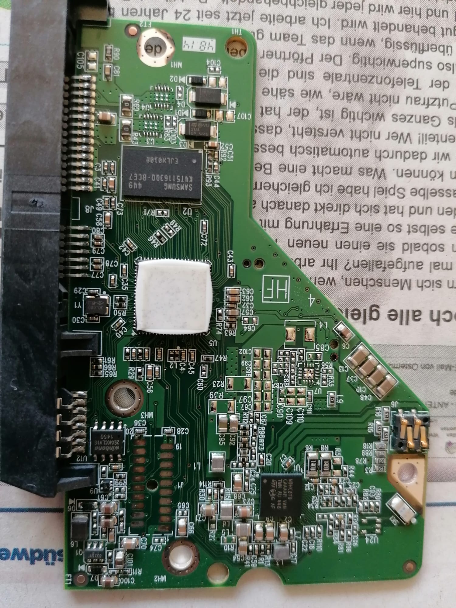

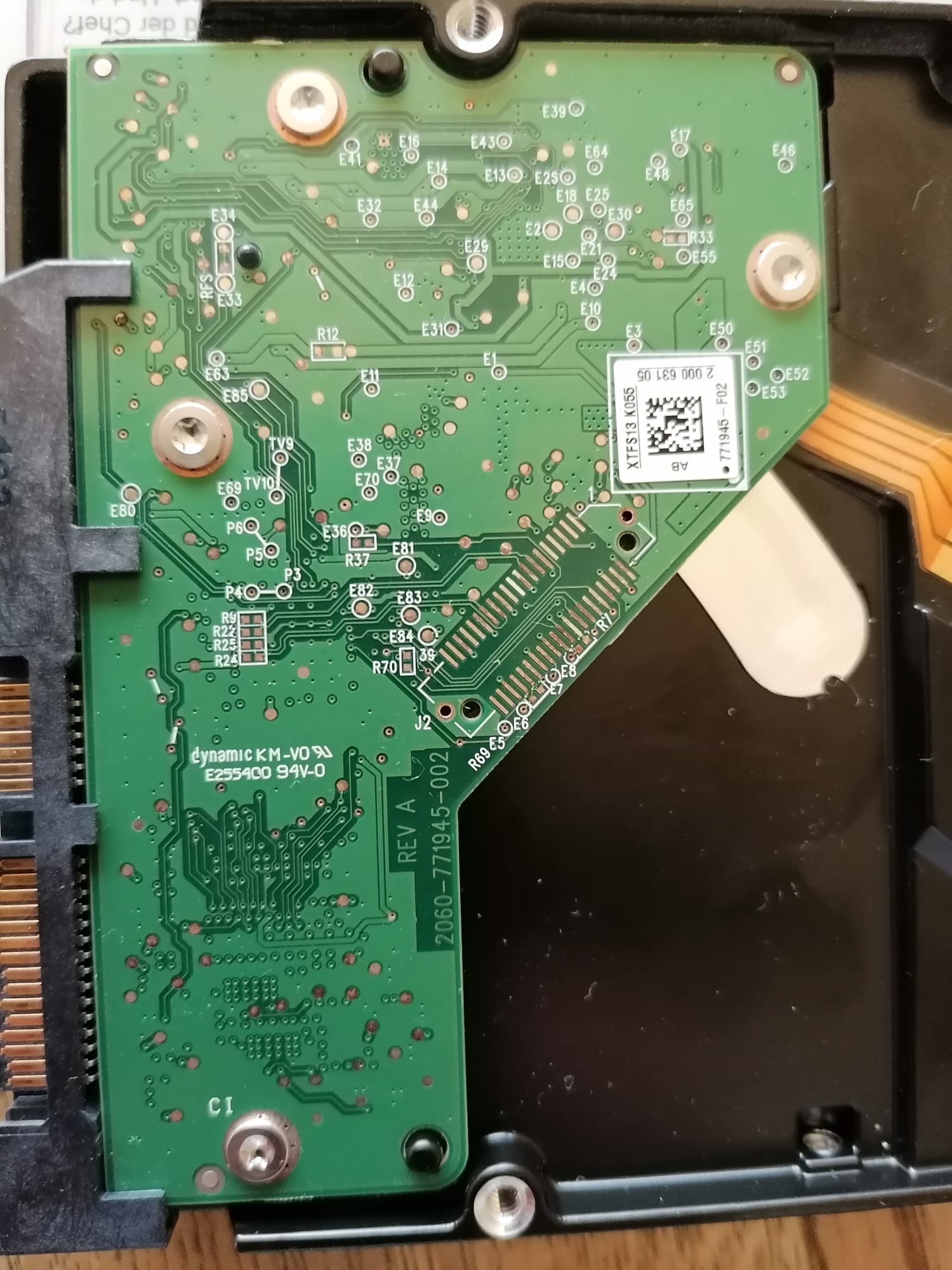

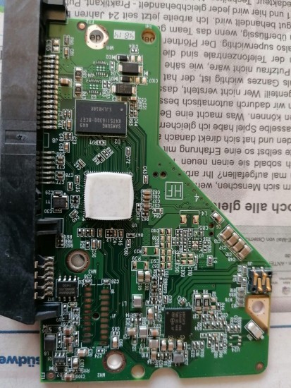

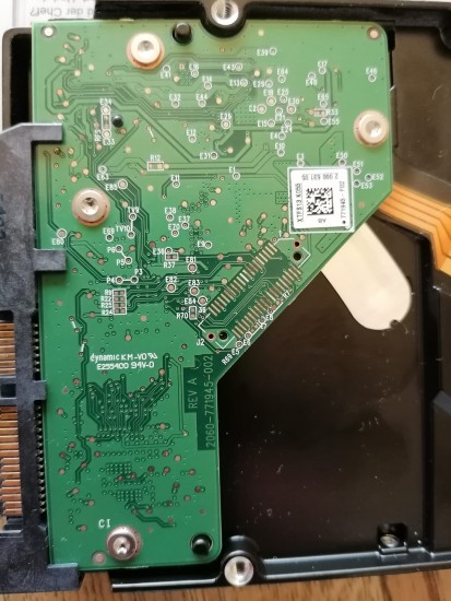

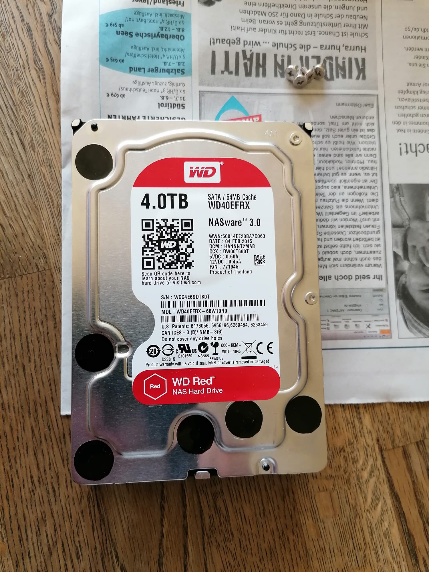

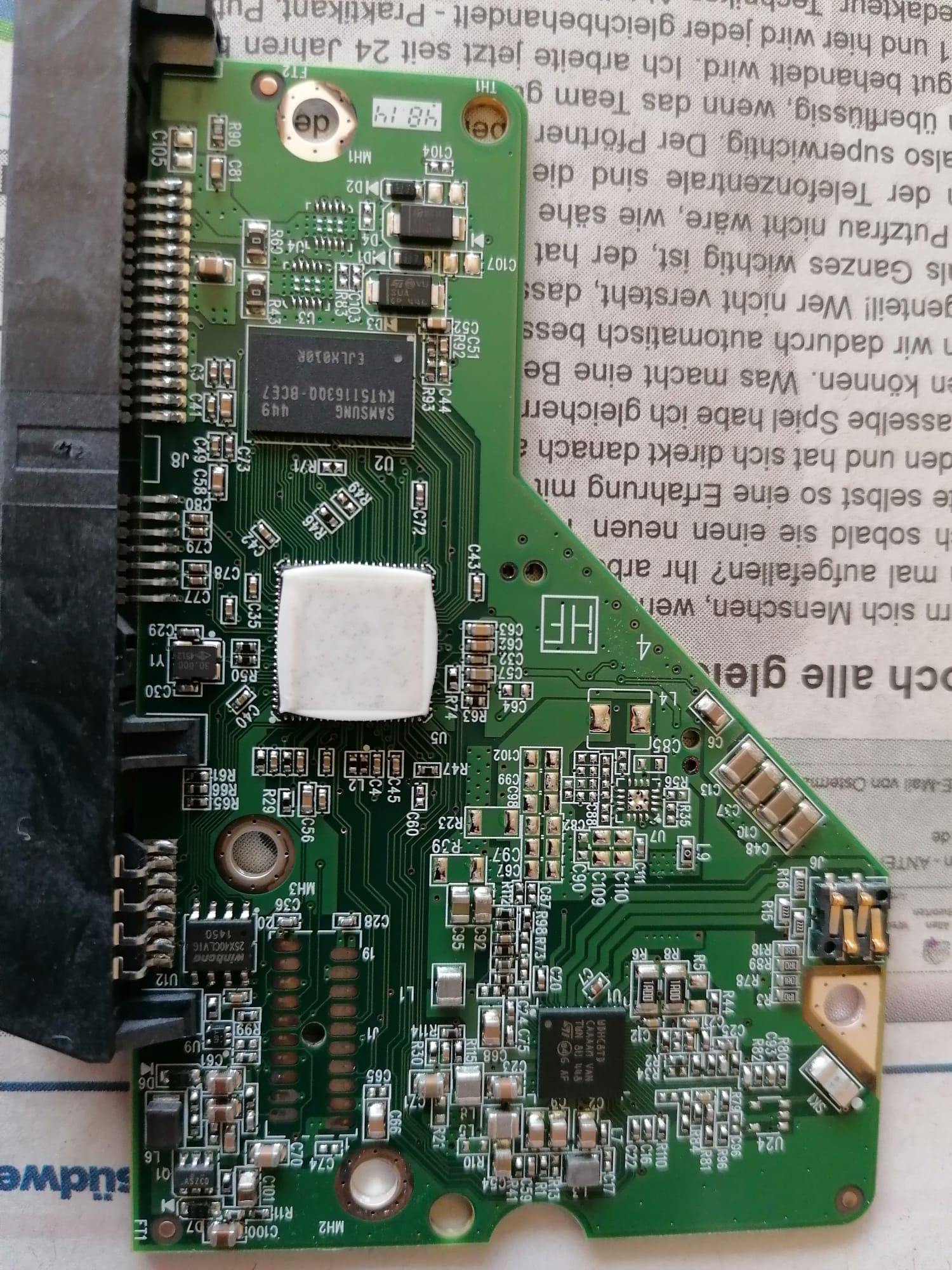

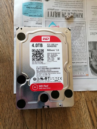

Here are phitos of the model of the hdd and of the platine. Is ther an error to see? But I think it would be better to buy an PCB board, or not?

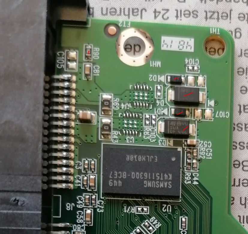

You don't need to get a new board if it's just a fuse or diode. New board means transfering ROM.
Check those in red.
 Post subject: Re: WD RED 4 TB does not work
PostPosted: July 3rd, 2022, 3:14
Posts: 927
Location: uk
And also check the 2 fuses, r60 and r43 for continuity.

O.K, i checked it with my multimeter. The multimeter was set to 200 Ω.
D4 = sound
D1 = no sound or less than 1 second
D3 = no sound or less than 1 second
D2= sound
R60 = 0
R40 = 0
R90 = 01,3
PostPosted: July 3rd, 2022, 12:17
Joined: June 30th, 2022, 13:07
Posts: 13
Location: France
Sorry,
r 60 = sound (continuity)
r 43 = sound (continuity)
PostPosted: July 3rd, 2022, 14:23
Posts: 17228
D4 is shorted. Remove it. Then check the PSU inside your NAS. It is overvolting your HDDs on the 12V side.

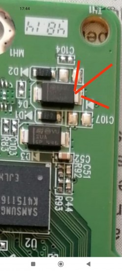

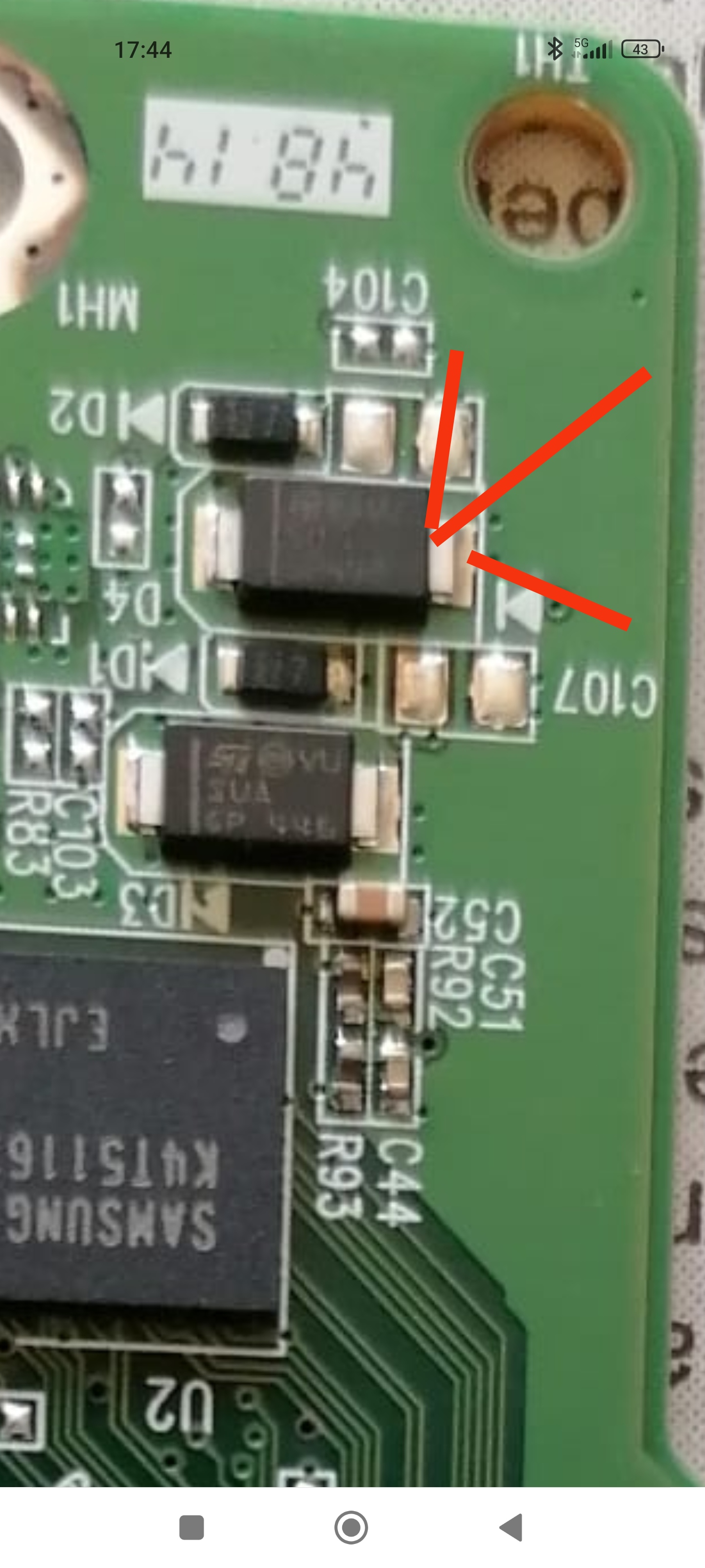

TO BE absolutely secure, the Diode which ist marked with an Arrow hast to be removed - right?
PostPosted: July 4th, 2022, 15:24
Posts: 17228
Yes, that's the one.
