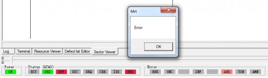

1. With 02 enabled Hdd restarted and goes to Bsy
2. With 02 disabled and loaded to ram hdd Ready. When try to read sector 0 (any Sector) hdd goes to Bsy
3. When Tried to Regenerate Translator, Hdd restarted and goes to Bsy ( 02 disabled and enabled in ram)
4. When tried with T2 Editor in MRT during Translator regen hdd restarted and goes to Bsy
5. When tried with T2 Editor without Translator option hdd keeps Ready. can only read zero sector, when tried any other sectors hdd restarted and goes to bsy

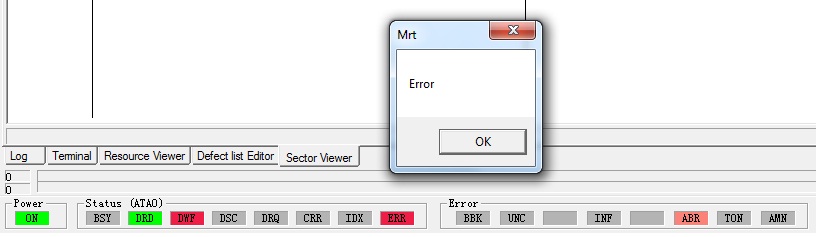

After Writing this 02.rpm Hdd gets ready without any problem. But when try to read any sectors then
Any Solution

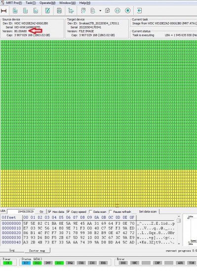

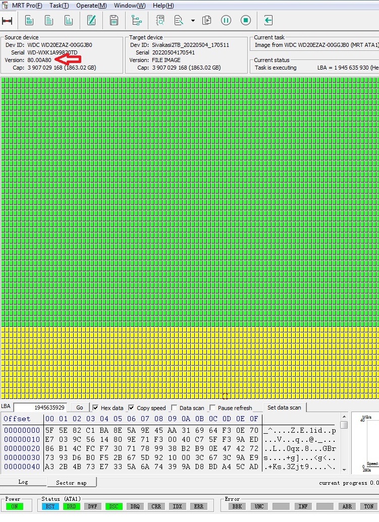

June 4th, 2022, 0:31
Nothing special
Just Used Mrt T2 Editor and uploaded to RAM
All sectors Accessed without any issue.

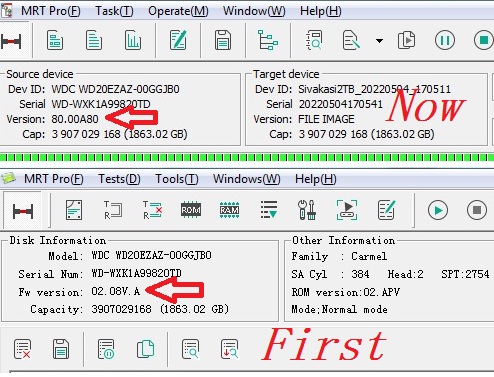

Re: WD20EZAZ-00L9GB0 F/W: 4.1TH No User Area
June 4th, 2022, 8:36
In This case https://forum.hddguru.com/viewtopic.php?f=1&t=42380
First means when i received it shows like that after it becomes as shown Now in Picture. I understand that your 4TB issue is like that so only i send PM.
In the above post discussed 0x190 is also full of garbage but that copy is worked for me
This hdd was first handled by one recovery firm and he too send the list of files and folders, Latter he returned it customer( i don't know what happened between them).
