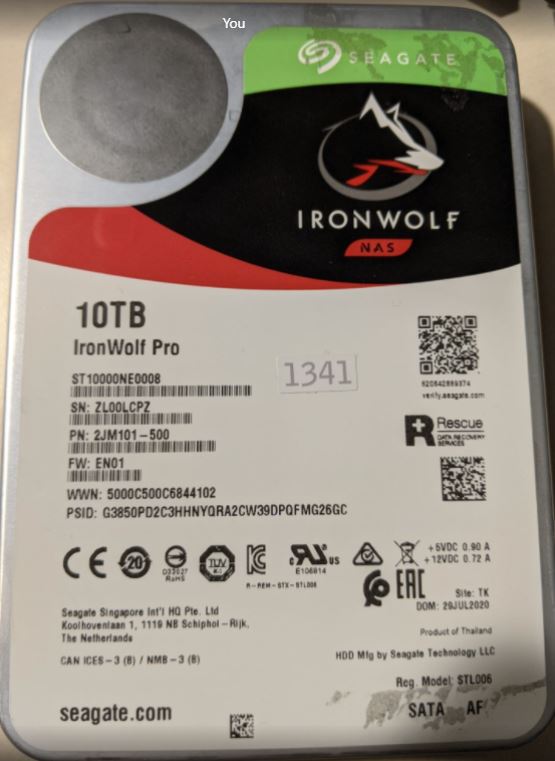

out of context....I had a Seagate 12TB Helium case, device dropped, HSA clicking.... It was under warranty, sent it to Seagate labs, they recovered data.

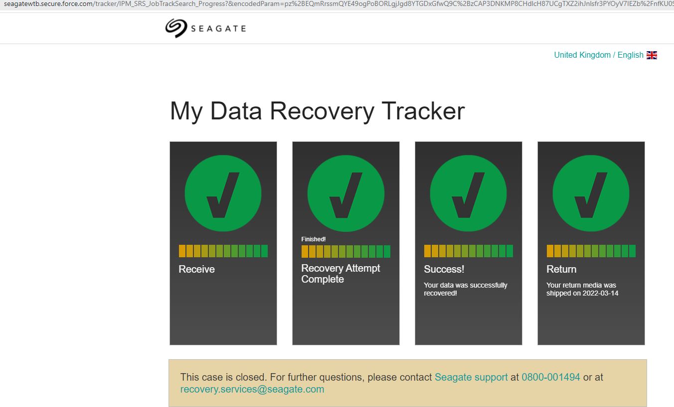

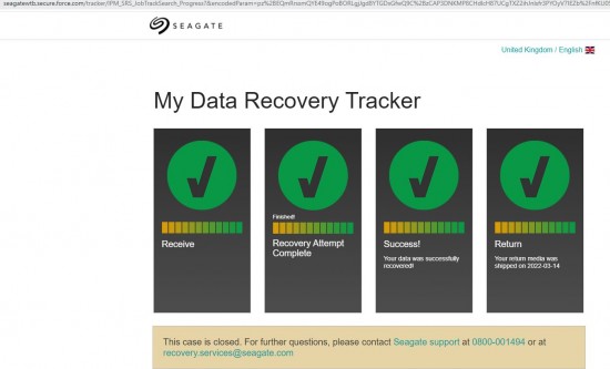

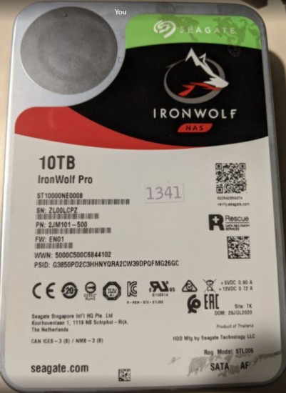

It was under warranty (I had to argue a long time as they were telling me it was not but the drive was from July 2020 and they give three years warranty), so it was free. I only had to pay for customs when they returned the drive with the data. Seagate doesn't offer DR for drive without warranty, their Lab in Netherlands is only to cover the "DR rescue 3 years program. When you sign the contract, you accept that if the DR is successful, they will keep and destroy the drive... so I couldn't get it back... If they fail, you can ask the get the drive back.
The drive was clicking, it was dropped from a table. They told me they recovered 99.5% of the data. They didn't provide file list and I couldn't check what they recovered before they sent the drive... it looks like they did a good job, they got 8TB of data. I told them to keep the drive until I confirm it was 100% ok.
When I shipped patient drive, they send me a new 12 TB to compensate (I had to pay customs 33 CHF) and they returned data on 10 TB HDD with bitlocker enabled and pw was sent by email.
So now I have 12 TB + 10 TB + DATA for 70 USD (customs) but I don't have patient drive to check what they did.

I saw someone questioning if my post is "true" on https://groups.google.com/g/datarecover ... 9EdF6I0lIk. Yes, it's 100%. That was the Patient HDD... the only bad thing in my case is I can't get Patient drive back to see what they did.
https://www.seagate.com/gb/en/products/ ... -recovery/
