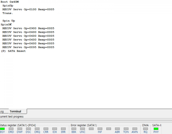

hello
I have ST3000DM001 drive.
power on, bsy
In terminal, "(P) sata reset" but I can't terminal access.
I tried head and pcb swap but same.
please help
thanks

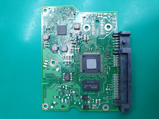

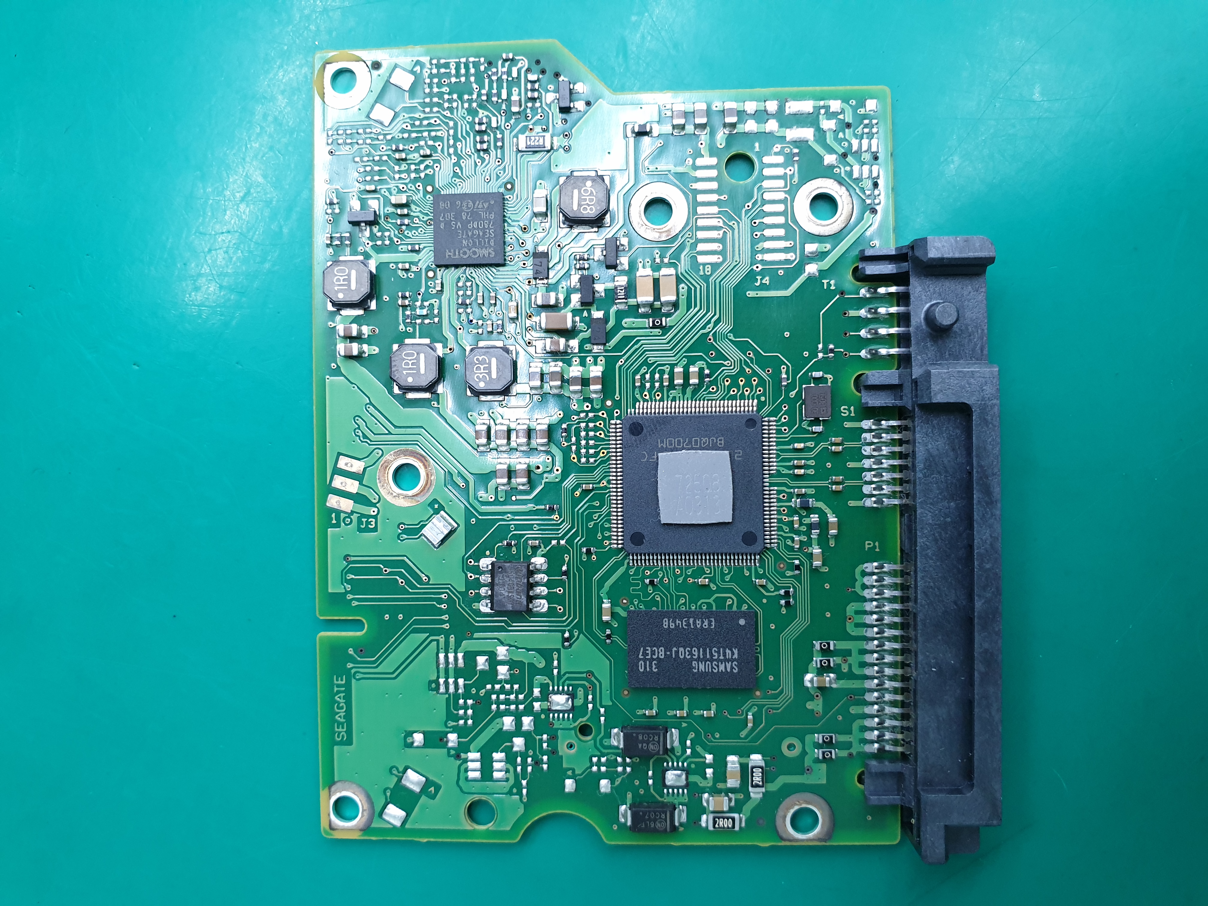

PCB number is 100687658 REV C
I need ROM patch?

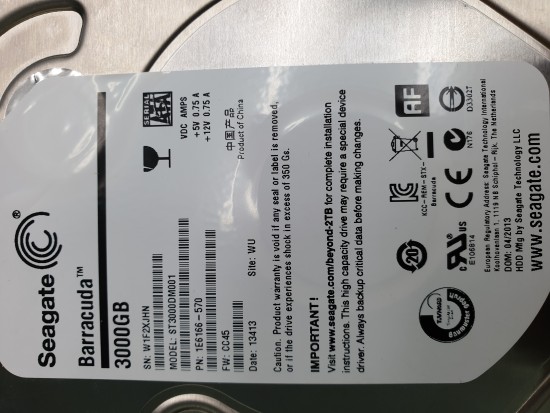

PostPosted: June 11th, 2022, 6:01
What's the PN (Part Number) on the label?

Posts: 4848
100687658 is for 1CH, not locked.

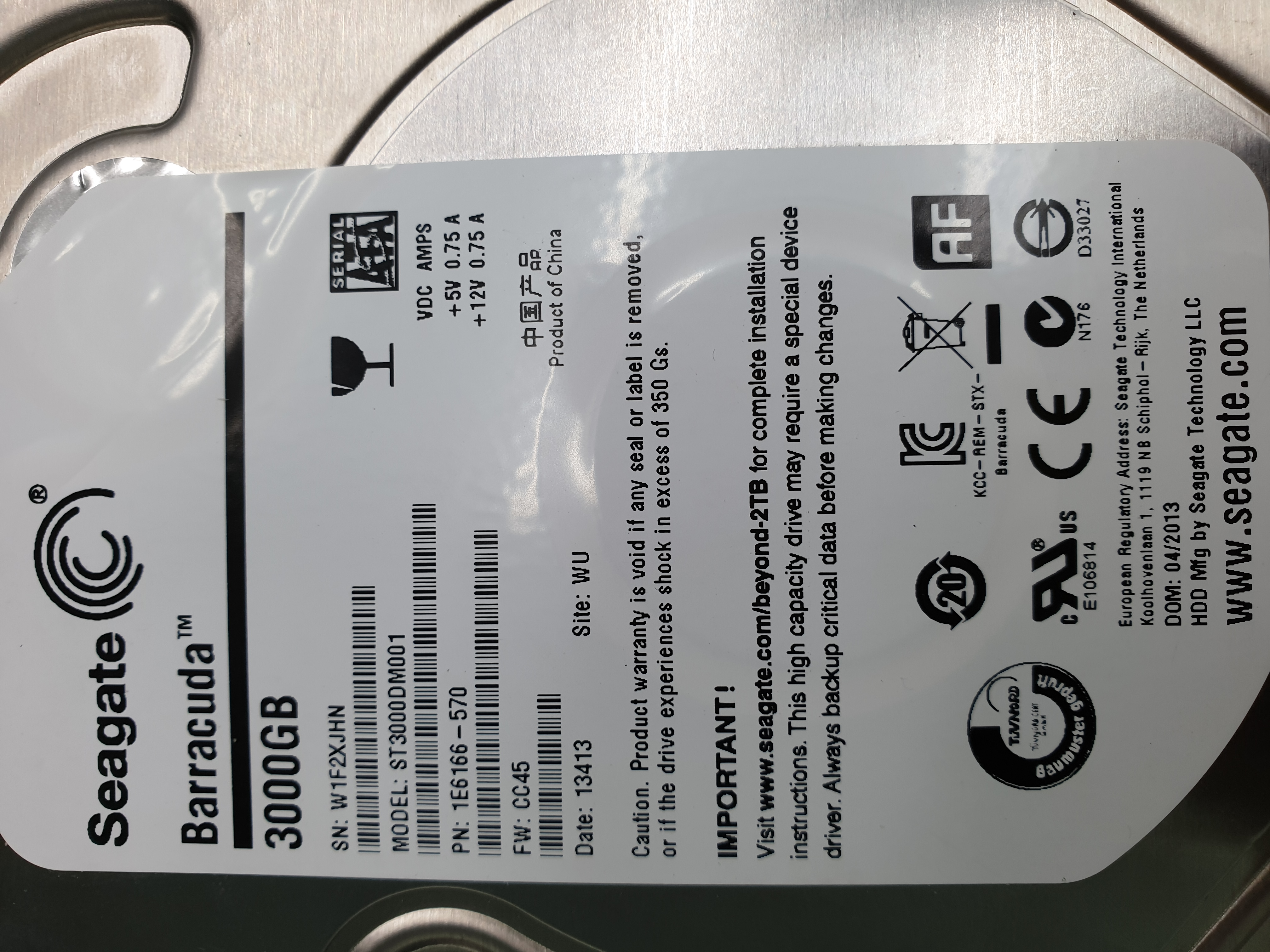

PN: 1E6166-570
 Post subject: Re: ST3000DM001 sata reset and no terminal
PostPosted: June 13th, 2022, 13:20
juhyuk wrote:
PN: 1E6166-570
I think you meant to say 1ER166-570.
I believe this drive requires ROM Unlock patch to get terminal access.

labtech wrote:
juhyuk wrote:
PN: 1E6166-570
no It's real haha..
PostPosted: June 13th, 2022, 22:49
Interesting, have not seen that one before.
Either way, if in the terminal it says "Diagnostic Port Locked", then it is a locked ROM based model.

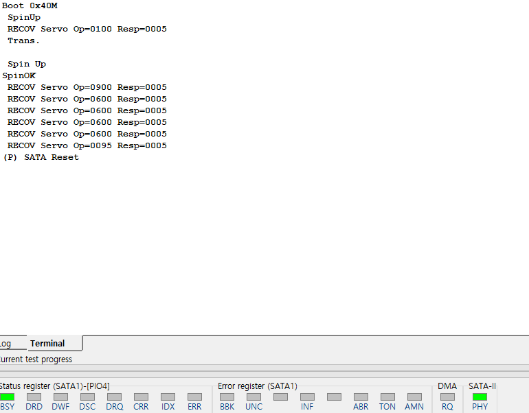

first picture only in terminal
still bsy and can't access terminal and no more code

It shouldn't be locked.
The locked Grenadas have a 'triangular' PCB shape, this is the old classic one, to my knowledge they weren't locked.

northwind wrote:
Did you try to patch ROM to pause boot after power on and then hit CTRL+Z immediately after you continue booting?
only tried CTRL+Z
T> is displayed on the terminal, but there is no response after (P)SATA reset.
