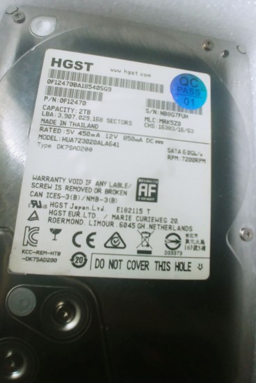

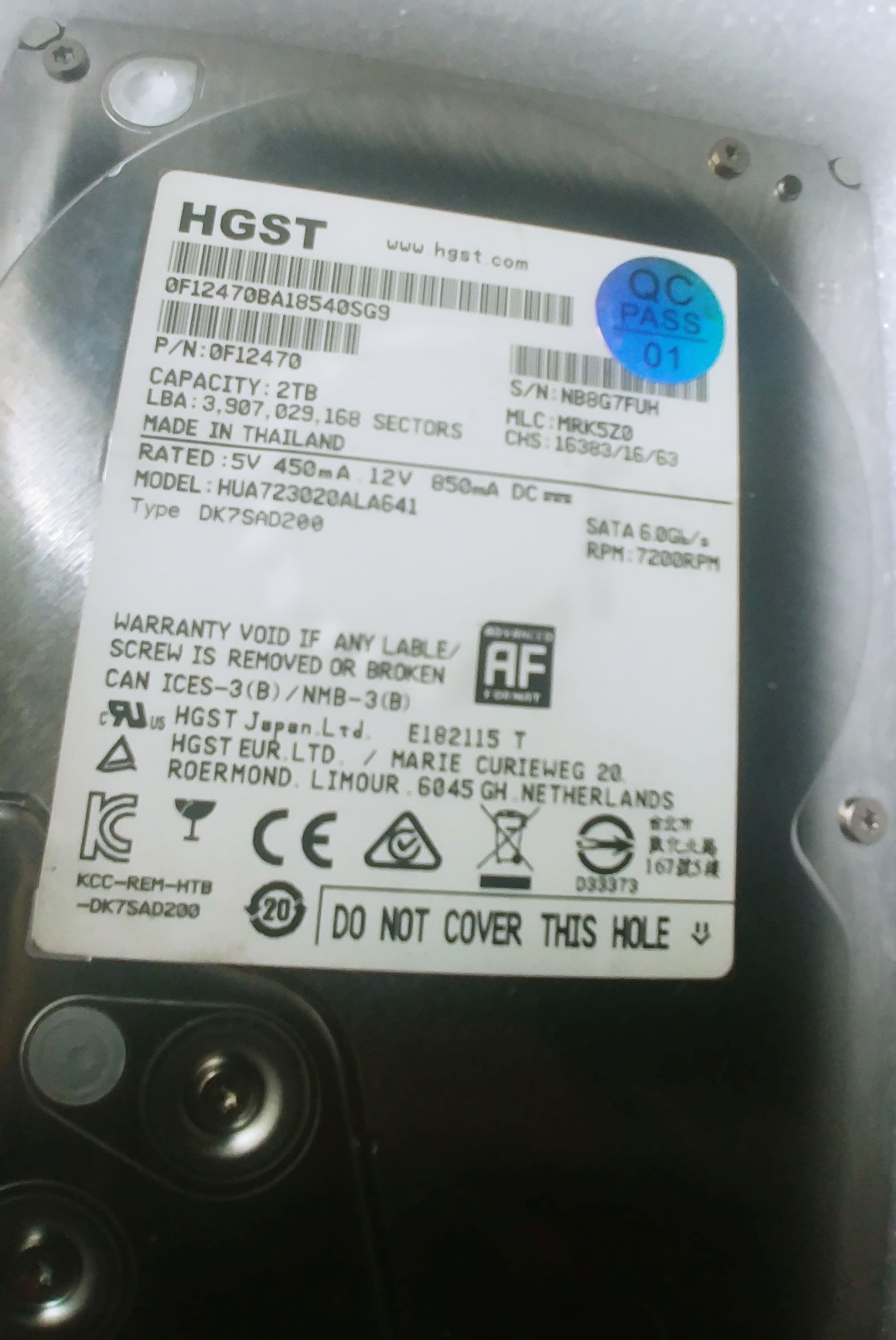

Hi guys.
my first time visiting and posting. quite a place this forum :D
Today I received a 3.5 HDD (assumed used/refurb) that I bought from a local online seller. The seller advertised the disk as 2TB Ultrastar HGST and I purchased it for 30usd. the drive came in with HGST label but bios reported it as TOSHIBA DT01ABA200. now I understand HGST and Toshiba had rebadges in the past but seems weird that why it use HGST label? I suspect a dishonest seller selling fakes.
I ran smart test. all good but perhaps too good. it says the Power On Hour Count as 19. if this is used / refurbed, could the smart value being tampered? the drive is at least 8 years old by now
I'm using this as parity drive for my JBOD nas + snapraid. copy all the parity from old drive (1tb) and run snapraid full scrub. All good. the copy speed also very consistent 140MBps (old sata II motherboard) However my biggest drive in the array is 1TB so the parity file won't exceeds 1TB at the moment
should I be concern and initiate refund? I don't mind its actually good deal anyway because the drive so quiet and cool.
sorry for my bad english :oops:

Yes, it's fake, HGST Ultrastar looks different. And yes on DT01ABA200 SMART can be reseted

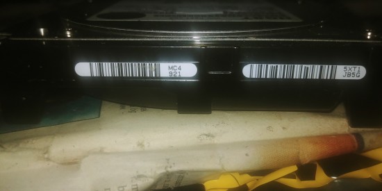

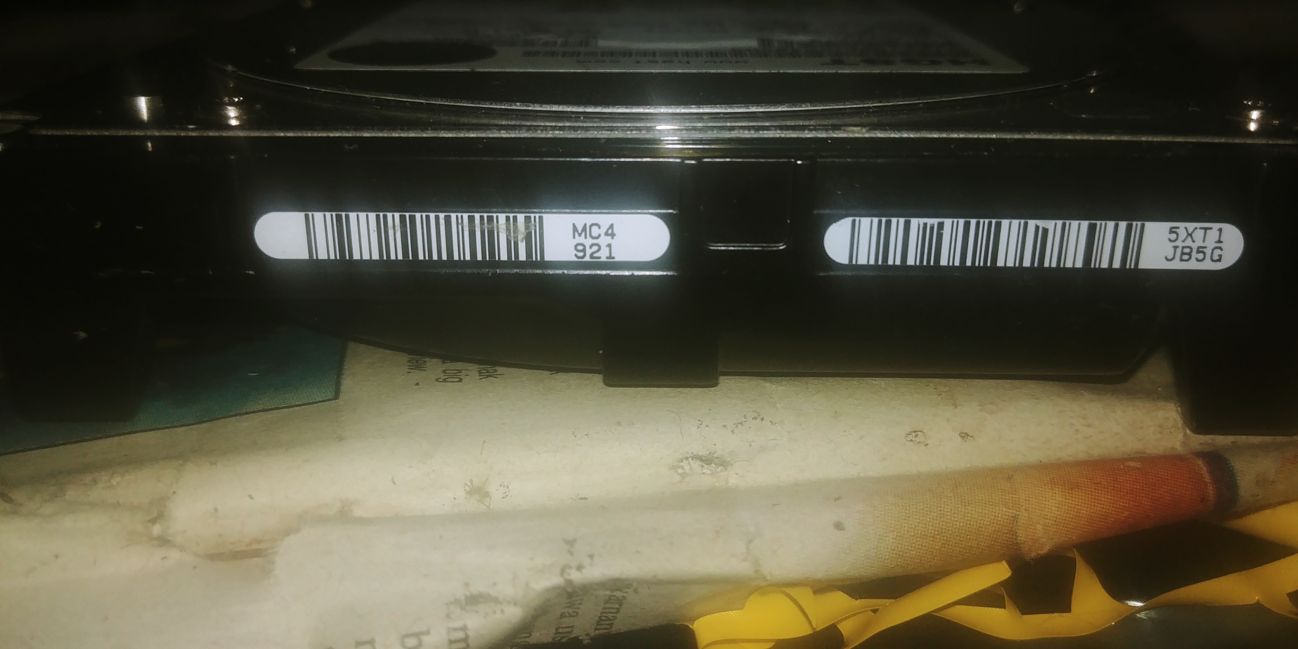

this label?
 Post subject: Re: used HGST in label but TOSHIBA DT01ABA200 in bios
PostPosted: July 18th, 2022, 10:07
myfairx wrote:
this label?
Thanks.
On the chassis, the small label on the right is the drive's Serial Number, which does not seem to match with the SN on the label located on the cover.
It is possible that it was a branded Toshiba drive with the DT01... model and someone slapped a new HGST label on the cover.
However, from a firmware architecture perspective, it is a Hitachi/HGST drive, which I assume it is confusing to you.
Reason being is WD, who owns both the Toshiba and Hitachi HDD lines of products, few years ago, began rebranding Hitachi drives with a Toshiba label.

I'm pretty sure it's actually Toshiba drive and the seller (or middleman) just slapped the hgst label to get better brand recognition. searching for MC4 921 only add to the confusion since it is supposedly designated to Toshiba 3TB drive and not 2TB (MC4 721).
My concern at that time is, do I return the drive or risk using it, knowing the seller's misleading advertisement. But after doing some tests I decided to keep it.
another curious question.
if MC4 921 is really 3TB drive, can someone flash 2TB firmware thus rendering 1 platter inaccessible, leaving only 2 (in case of bad sector in 1 platter for instance)?
