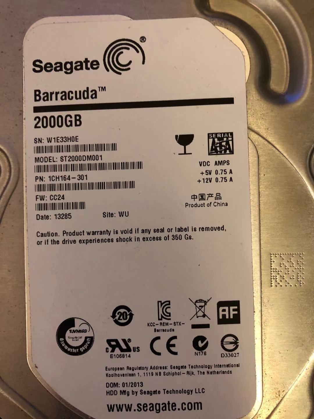

Does anyone know are those two drive's heads compatible??
The drive need heads replacement:

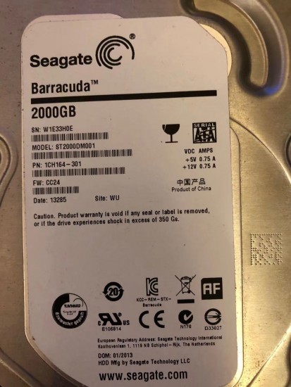

The donor drive:
 Post subject: Re: ST2000DM001 heads replacement
PostPosted: July 27th, 2022, 1:26
Joined: May 29th, 2011, 8:47
Posts: 141
Location: Russia
must be compatible
PostPosted: July 27th, 2022, 19:40
Posts: 413
Yes they are.
Pro tip: if data is valuable send it to a pro.
PostPosted: July 27th, 2022, 22:56
Posts: 3598
Location: Chicago
These are compatible
These drives are also infamous for developing media damage.
PostPosted: July 28th, 2022, 0:32
Joined: March 17th, 2022, 21:24
Posts: 48
Location: Melbourne
Just make sure the heads map and PCB are the same.

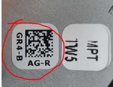

If possible, you should check the little white sticker on the head connector (need to open the drive). If it's similar (Patient AGR, donor AGR... and not LSI) it will work.
PostPosted: July 29th, 2022, 12:29
Posts: 3598
Location: Chicago
AG means Agere, which actually was purchased by LSI, which was later purchased by Broadcom
AG=LSI=BR - it's literally the same thing.
PostPosted: July 29th, 2022, 16:50
Posts: 191
Location: Switzerland
I have two patient, one donor.
Patient 1 ST2000DM001, 1ER164-044, Z8E preamp B6
Patient 2 ST2000DM001, 1ER164-044, Z8E preamp B6
Donor 1 ST2000DM001, 1ER164-021, Z8E premap B6
All are TK.
Patient 1 head connector sticker= GR4-B AG-R
Patient 2 head connector sticker = GR4-C LSIB2-M
Donor head connector sticker = GR4-B AG-K
Donor is working for Patient 1, not with Patient 2. Back to patient 1, still working. Took a donor with LSIB sticker, it works.
Is Texas Instrument part of it as well ? Maybe I am wrong but it's something I look after and so far it really helps, maybe just luck then.
PostPosted: July 29th, 2022, 17:11
Posts: 3598
Location: Chicago
Seagate changes heads (the actual RW elements) periodically, so this could be the reason why, check the DOM. Unfortunately this information can only be obtained through trial-and-error or through Seagate's internal database (which is not for us mortals).
