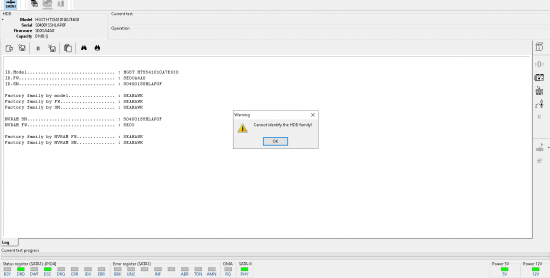

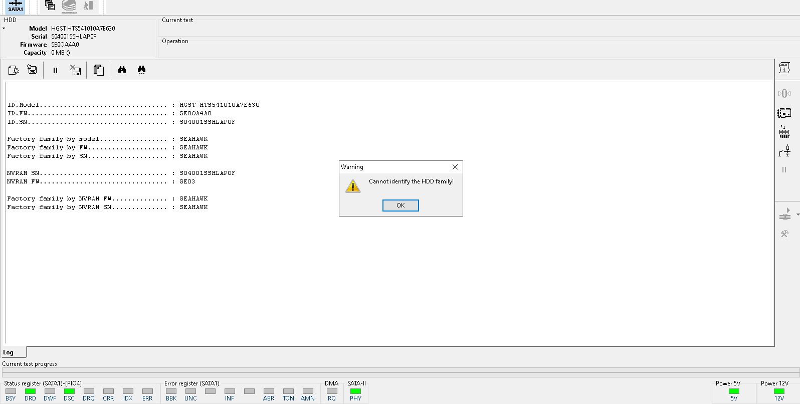

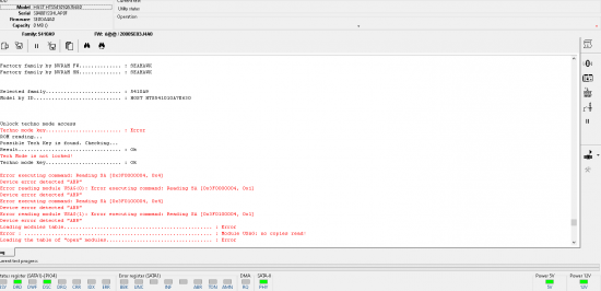

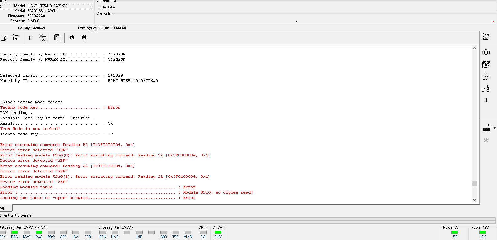

I have got HGST HTS541010A7E630 / Type TT5SAF100 / ( Z5K1000-1000) / FW 4A0 / MLC DA6439 / P/N- J42231 16 DEC 15
In PC3000 it is not detecting in Hitachi family , If I select 5410A9 it gets detected as 0MB.
Is there any additional steps I can take for further diagnostics ( whether its heads or FW issue)

Looks like a firmware issue to me. I would swap the PCB and ROM, just in case.
If these don't work, change the heads. Difficult say more based on this information.
Does the drive spin without clicking?

Thanks. Though drive is not clicking and spins normally ,it is head issue. I have ordered donor .
