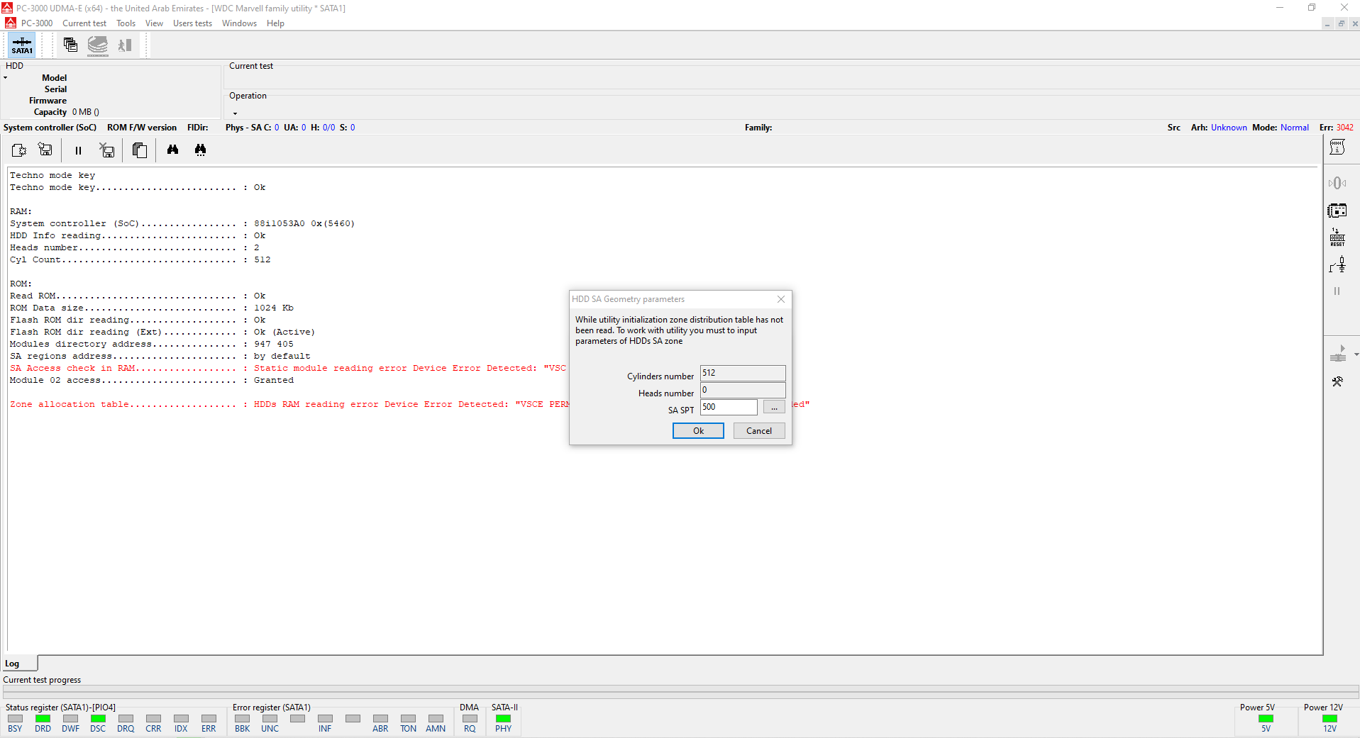

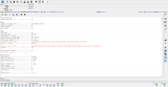

hi
I have a hard drive
have WDC WD10SMZW-11Y0TS0 Palmer Family
I unlocked its rom (SED locked)
But after unlocking, it does not read the ROM completely
And the size and model of the hard drive is not specified

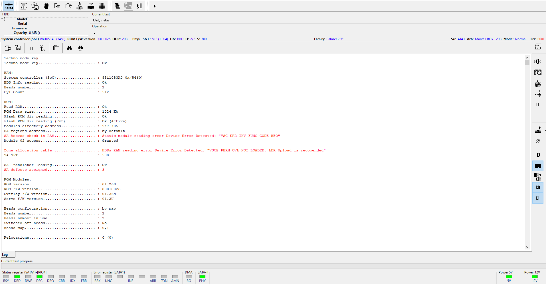

Techno mode key
Techno mode key......................... : Ok
RAM:
System controller (SoC)................. : 88i1053A0 0x(5460)
HDD Info reading........................ : Ok
Heads number............................ : 2
Cyl Count............................... : 512
ROM:
Read ROM................................ : Ok
ROM Data size........................... : 1024 Kb
Flash ROM dir reading................... : Ok
Flash ROM dir reading (Ext)............. : Ok (Active)
Modules directory address............... : 947 405
SA regions address...................... : by default
SA Access check in RAM.................. : Static module reading error Device Error Detected: "VSC ERR INV FUNC CODE REQ"
Module 02 access........................ : Granted
Zone allocation table................... : HDDs RAM reading error Device Error Detected: "VSCE PERM OVL NOT LOADED. LDR Upload is recomended"
SA SPT.................................. : 500
SA Translator loading................... : Ok
SA defects assigned..................... : 3
ROM Modules:
ROM version............................. : 01.26N
ROM F/W version......................... : 00010026
Overlay F/W version..................... : 01.26N
Servo F/W version....................... : 01.2U
Heads number in use..................... : 2
Switched off heads...................... : No
Heads map............................... : 0,1
Relocations............................. : 0 (0)

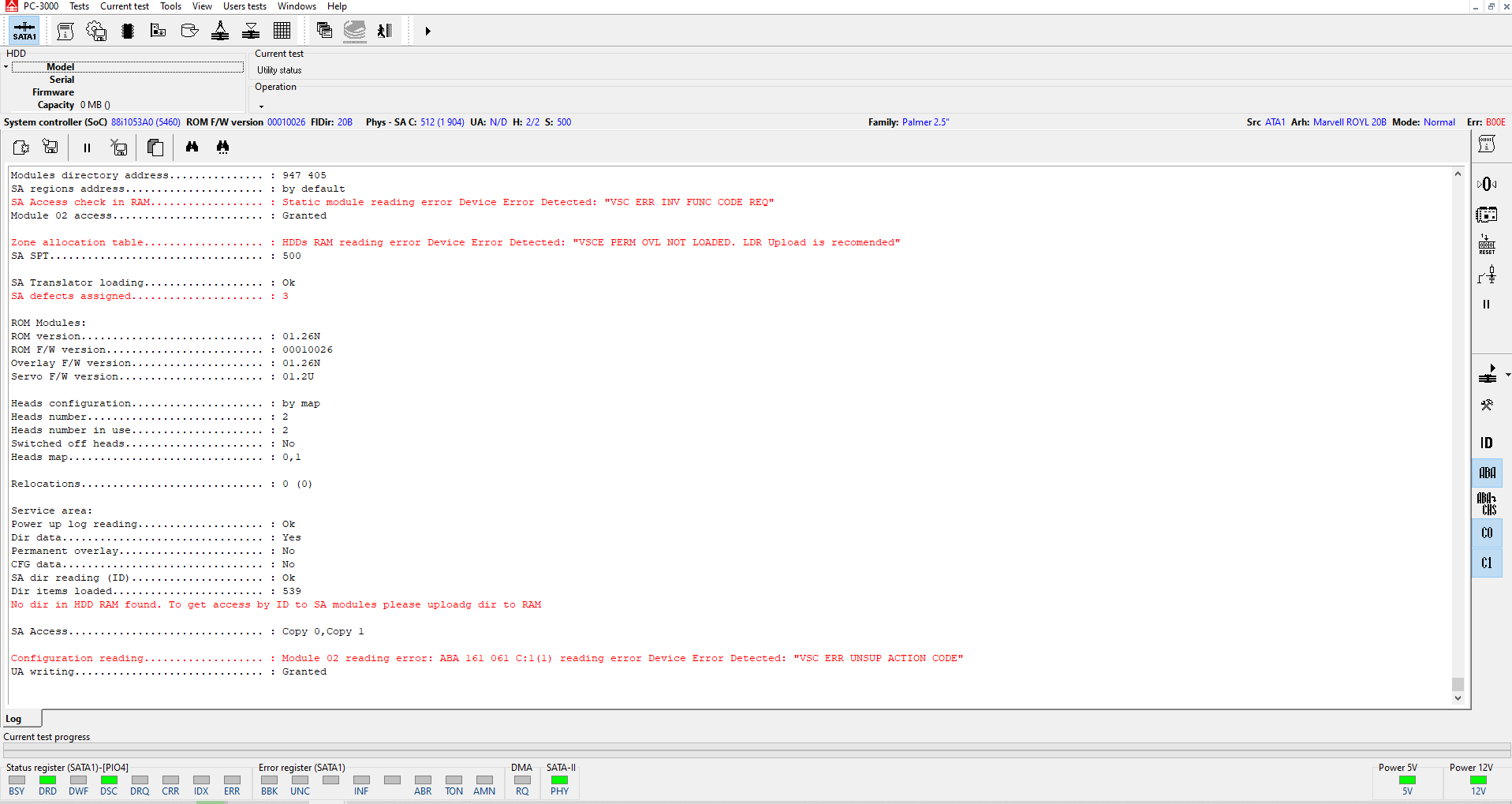

Service area:
Power up log reading.................... : Ok
Dir data................................ : Yes
Permanent overlay....................... : No
CFG data................................ : No
SA dir reading (ID)..................... : Ok
Dir items loaded........................ : 539
No dir in HDD RAM found. To get access by ID to SA modules please uploadg dir to RAM
SA Access............................... : Copy 0,Copy 1
Configuration reading................... : Module 02 reading error: ABA 161 061 C:1(1) reading error Device Error Detected: "VSC ERR UNSUP ACTION CODE"
UA writing.............................. : Granted
File comment: 3
