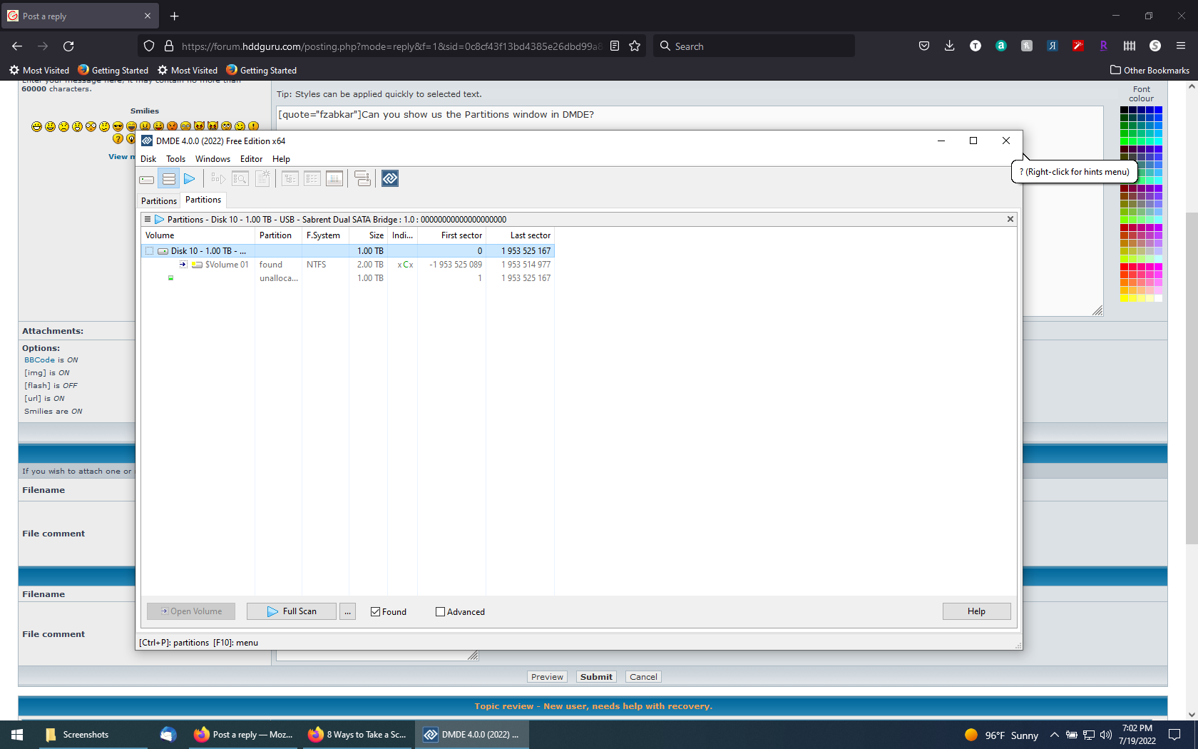

Hi, I have 2 WD1001FALS 1TB drives that I had in an external enclosure. Windows saw the setup as one 2TB external drive. Unfortunately my enclosure Stopped working, so I purchased a Sabrent USB Docking Bay EC-HD2B as a replacement. Unfortunately my drives are now seen as "unallocated space". I have performed numerous scans in Gentoo, and can see that there is data there, and that the file system is NTFS. Is there a way to recover these disks, mainly the data, and render the disks usable again? I do have a new 1TB solid state drive on the way to use as possible storage for each of the disks in case I need to have a place to stage the data while the other disks are being reformatted...
Any and all help is appreciated!
Thanks!

Can you show us the Partitions window in DMDE?

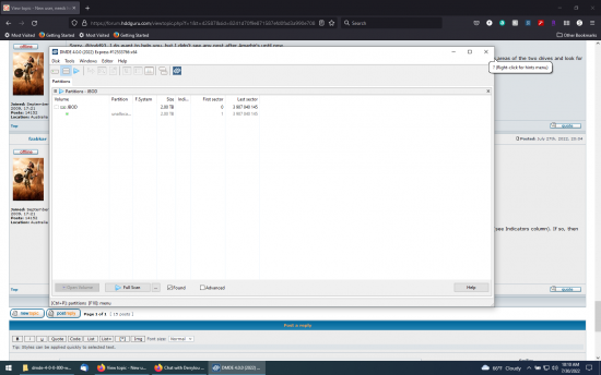

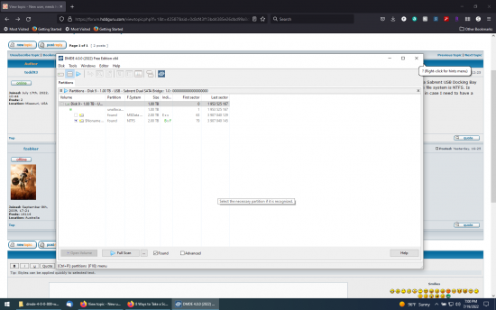

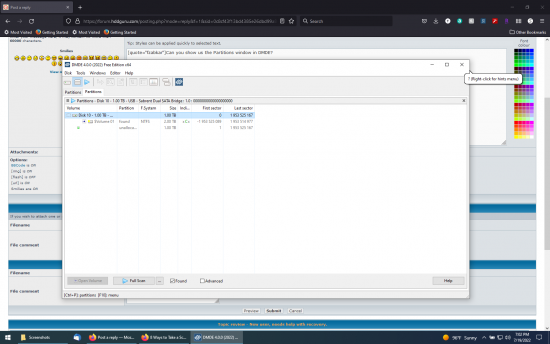

This is my first experience with DMDE, if I need to do a different scan, then please let me know! As you see, it's seeing the NTFS partition on both drives, and you see it's reporting as 2TB, which is what it did in the previous enclosure, 2 1TB drives showed up as one 2TB...
Todd

 Post subject: Re: New user, needs help with recovery.
PostPosted: July 19th, 2022, 20:58
Posts: 17323
The first screenshot is the second drive in your RAID pair. The second screenshot corresponds to the first drive.
If you can install both drives inside your computer, DMDE should be able to assemble the 2TB RAID and give you access to your data. Playing around with your new enclosure may be risky.
Edit:
I'm wondering whether the two drives constitute a JBOD, in which case you may be able to recover some data from the first drive. If you d-click the NTFS volume, do you see your file/folder tree under the $Root? If so, r-click a large test file (eg a large graphics or multimedia file) and recover it to another drive. If the test file plays or displays correctly, then you have a JBOD.

Ok, I successfully recovered a large media file! So I apparently have a JBOD? Is there a way to get this all back like it was? Or is it best to recover everything to one drive, and just reformat the old drives for future use?

It looks like you have a JBOD (a spanned volume). DMDE should be able to stitch the two halves of the NTFS volume together.
Select Disk -> Construct RAID, and then select RAID Auto Calculate (Scan) from the drop-down list.
Then select Menu -> Add Disk and add each of your two disks.
If this doesn't produce a spanned volume, we can still select the start and end LBAs manually.
In any case, if you work only with the first drive, you can recover all the files which exist on this drive, as long as none of their fragments also exist on the second drive.

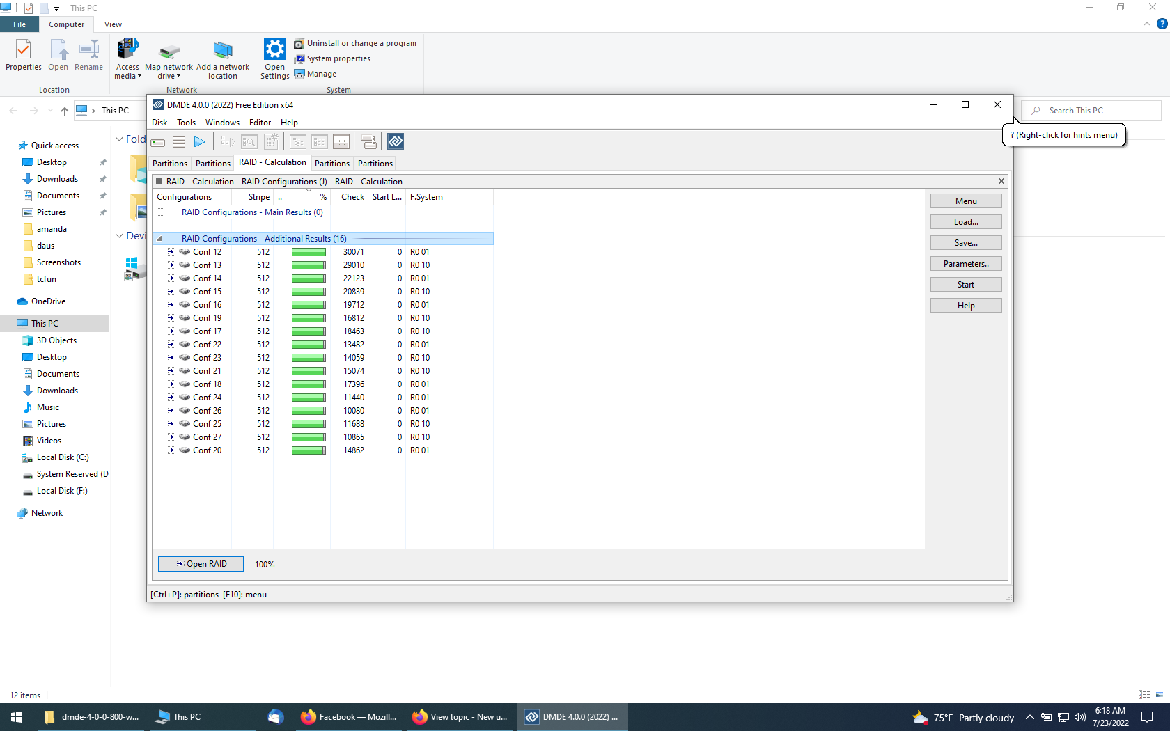

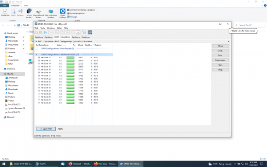

Thank you for the help so far... Here is what the scan produced from the steps you laid out:

Sorry, @todd93, I do want to help you, but I didn't see any post after Amarbir's until now.
It appears that DMDE did not detect the spanned volume, so you will need to find where the first half ends and the second half starts. To this end you could examine the relevant areas of the two drives and look for discontinuities.

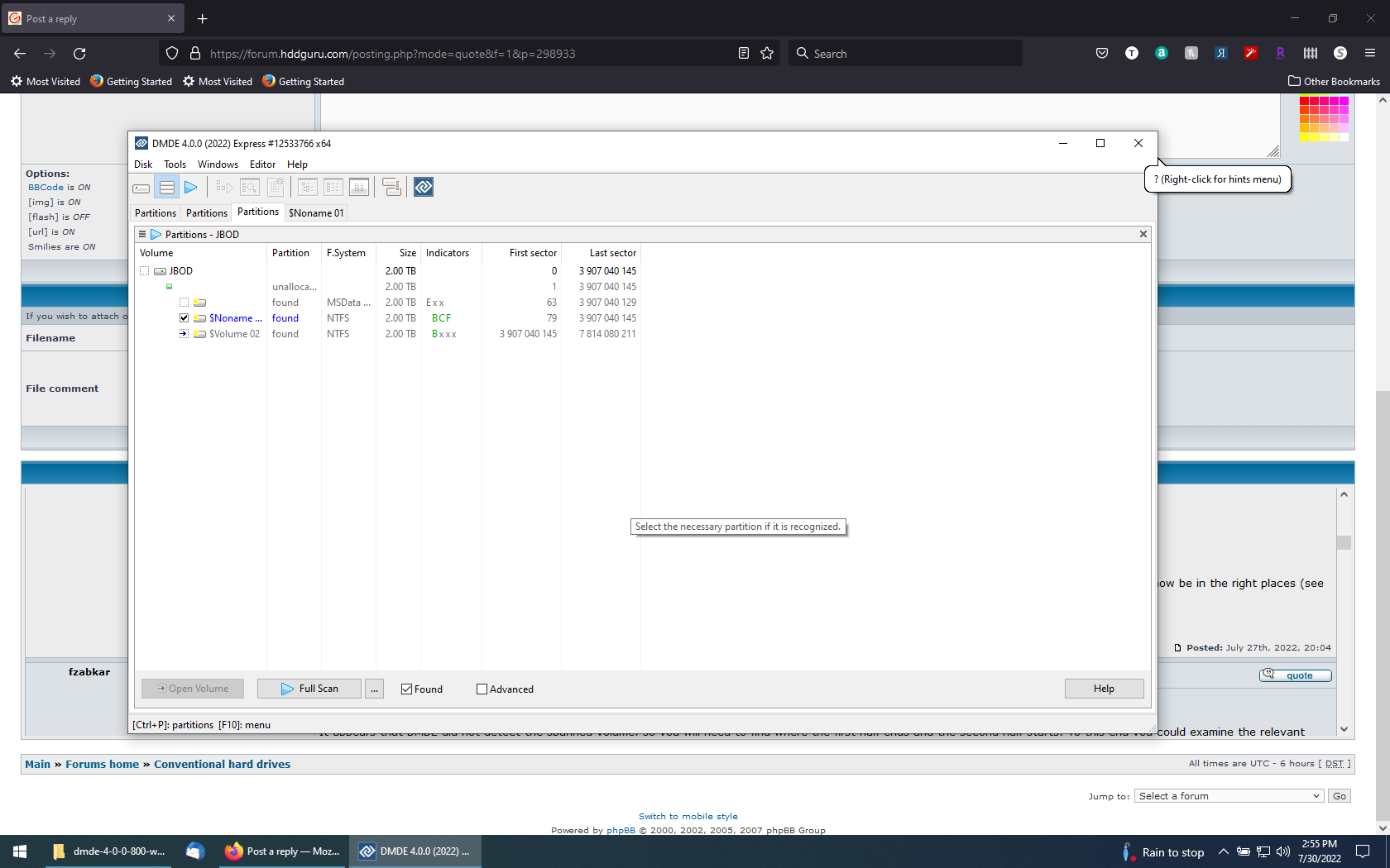

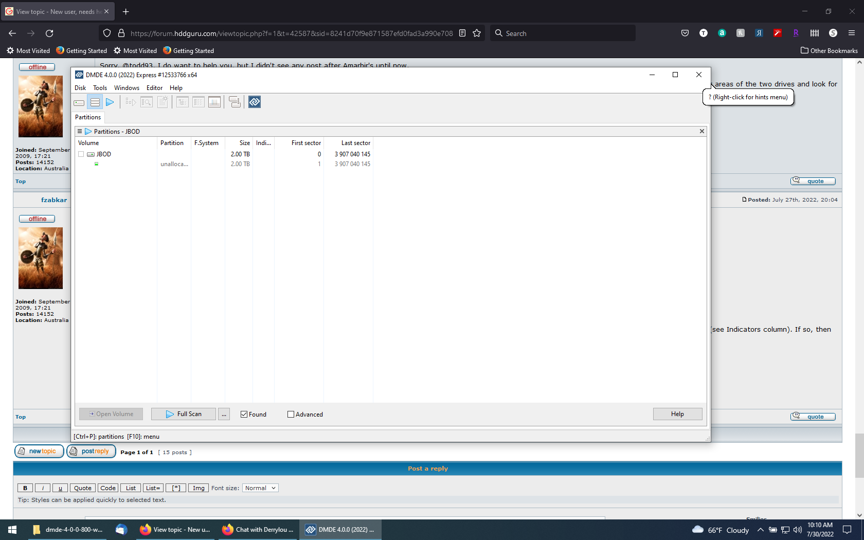

I get the following.. Do I need to perform a scan? Or is this the assembly?
PostPosted: July 30th, 2022, 15:33
Posts: 17323
The first drive is the one in your second screenshot. The second drive is the one in your first screen shot. Did you mix them up?

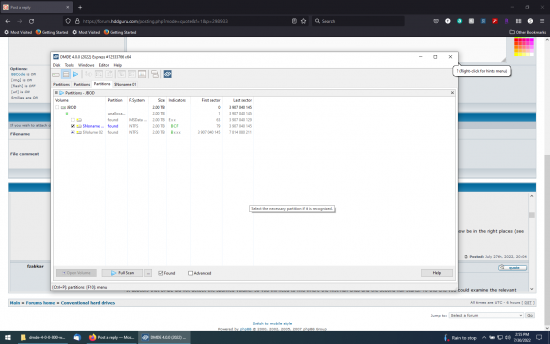

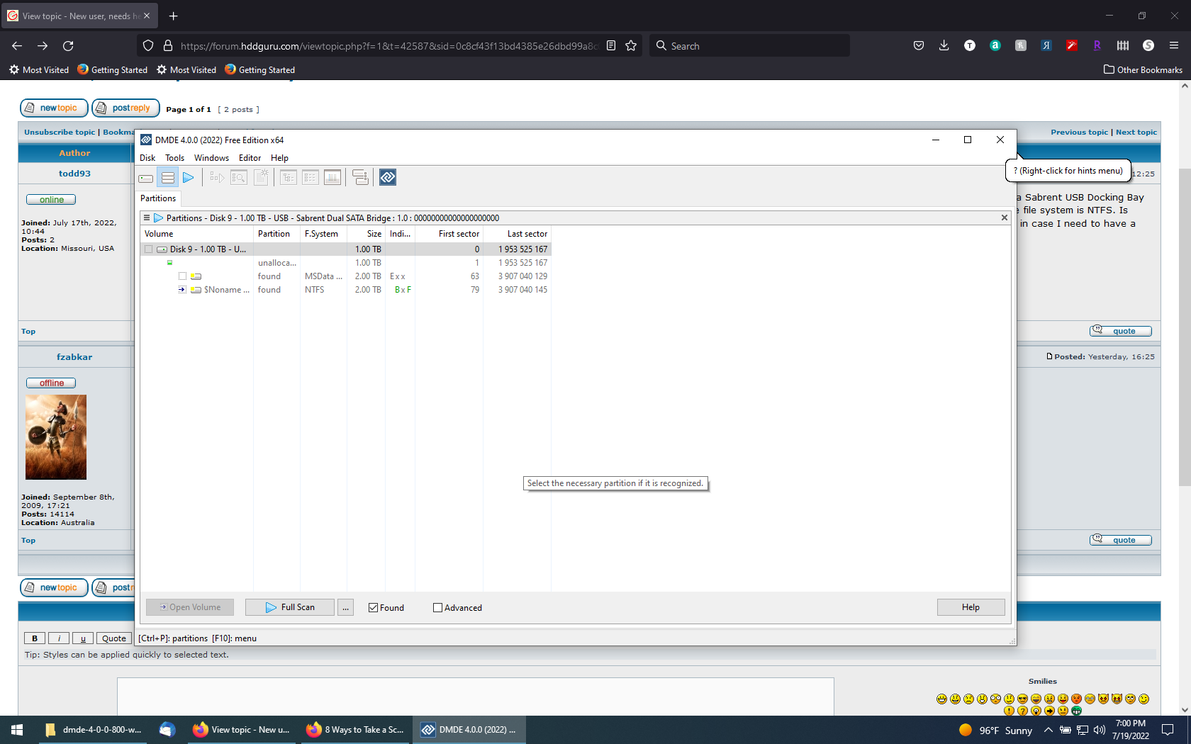

I think I did, I reversed the drive order from what I previously did, and I get the following:
PostPosted: July 30th, 2022, 16:07
Posts: 17323
The BCF indicators are in the right place, but the partition table points to sector 63 rather than 79. That's an anomaly, but it's not a problem.
D-click $Noname and expand the $Root. Those should be your files. You can now recover them to another drive (r-click and Recover). The free version of DMDE is limited to 4000 files from any one folder per session. The standard version costs US$20.
