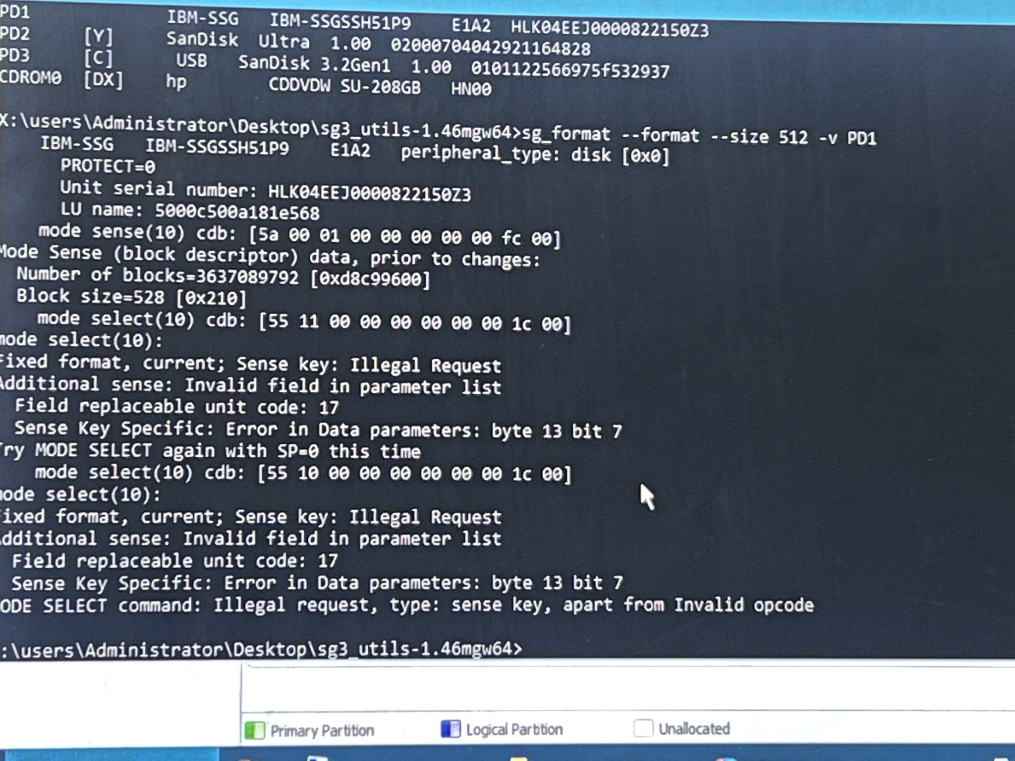

I have problem for hdd put up from eBay store I tried to reformat scotor size from 528 to 512 because need use this hdd in normal server please can you send me frimware to return Seagate because can't reformat this is part number for hard disk XS7680SE70113
IBM FRU: 01ML224 this is for IBM

https://www.mankier.com/8/sg_format
# sg_format --format --ffmt=1 --size=512 /dev/sdd

I tried also this but not working

I tried this but not working

Your drive is actually not a seagate it is HGST . Try Cli tools from HGST resources
The WWN is 5000C50...
That belongs to Seagate :-?
https://en.wikipedia.org/wiki/World_Wide_Name#List_of_OUIs_commonly_seen_as_WWN_Company_Identifiers
XS7680SE70113 is a 7.68TB Seagate Nytro SSD :-?
SSGSSH51P9 has a capacity of 1.92TB.

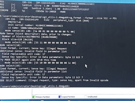

Yes I have 1.92tb sas ssd and 7.68tb sas ssd twice not working

Some firmwares prevent 512 formatting.
