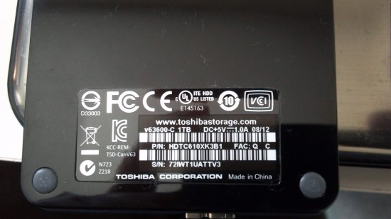

On the back of the enclosure, it's labeled:
v63600-C 1TB
P/N: HDTC610XK3B1
S/N: 72IWT1UATTV3
KCC-REM-TSD-CanV63
E145163
I have no idea which one is the model number.
I attach a picture of the label for you guys to identify.
File comment: HDD label

 Post subject: Re: HELP !! Hard drive failed after low-level formatting
PostPosted: January 19th, 2015, 16:30
No, if you formatted the drive it won't have any viruses. Most likely it's a failing hard drive (very common for externals) causing the system to hang. Or it's an issue with your computer.
Try formatting from another computer. If that doesn't work, throw it in the trash and get another.
PostPosted: January 20th, 2015, 13:04
I don't recall precisely whether internally this is a SATA or USB interface drive. If it is SATA, then testing in a non-windows environment is much more recommended and likely will have better results.
The failures on this can be of different flavors, bad sectors, firmware, possible mechanical, or a combination of those.
Careful with how much you tamper with it. These are not forgiving.
