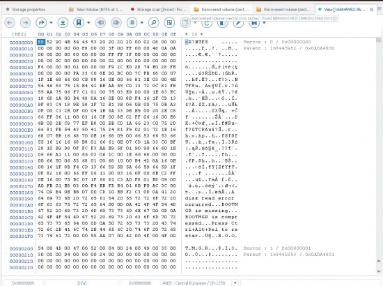

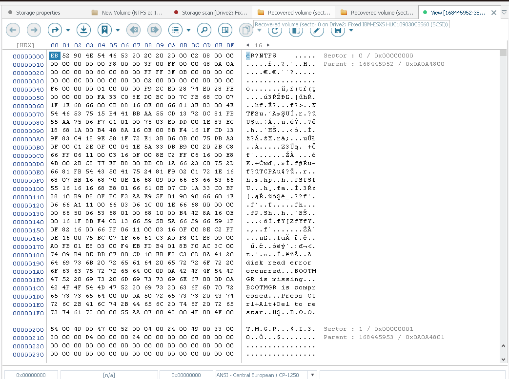

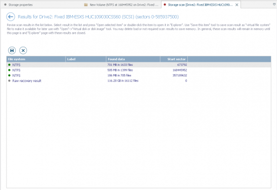

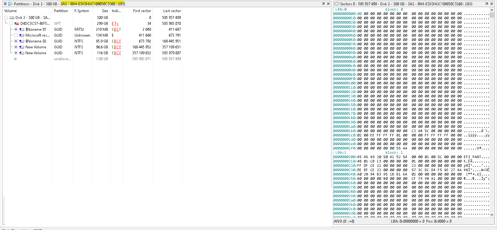

I have got a 300GB SAS disk from a malfunctioned server . In disk management it is showing unallocated space.
I have tried R-stdudio & UFS explorer (both trial) to scan the disk . But I think NTFS boot record is missing so though data is present file system reconstruction is not successful.
What should I try now ? Attached is first 10000 Sectors of the disk.

It's almost as if 504 bytes/sector. All 55 AA signatures are 'off' by 8 sectors.

It seems to me that the beginning of the data area is laid down as follows:
    write 500 bytes, drop 8 bytes, write 500 bytes, drop 8 bytes, write 500 bytes, drop 8 bytes ...
This results in the next sector rolling into the previous sector.
However, there is a FAT32 boot sector at offset 0x100000. Its BIOS Parameter Block points to sector 0x800 (= 2048), which means that this boot sector is in the right place. This means that the sectors are correctly synchronised at this point, at least at the beginning. However, once again the previous pattern repeats after 500 bytes.
The BPB indicates that there are 0x19DE reserved sectors, which means that the first copy of the FAT should be located at offset ...
    0x100000 + (0x19DE x 0x200) = 0x43BC00
However, the two FATs are located at 0x43B504 and 0x49D67C, which once again points to dropped bytes.

Yes raw recovery shows large no of files ,some of them are working while others have lost integrity.

I "repaired" the first 13 sectors beginning at offset 0x100000. That's where the FAT32 boot sector is located.
The procedure I used was ...
    read 500 bytes, insert 8 pad bytes, read 500 bytes, insert 8 pad bytes, read 500 bytes, insert 8 pad bytes, ...
Obviously the data is corrupt, but the sectors are correctly aligned. I tried other approaches, but this was the only one where the text in both boot sectors was correct.
