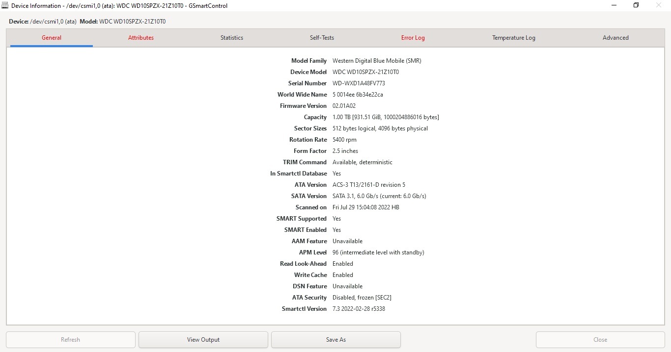

Thank you for your attention and time in helping me @Northwind. I also appreciate the program tip to test on my HDD. This Smartmontool is for Linux. I even downloaded it and installed it on my Windows, but it has no icons, it's just via command line. I didn't find videos showing its use on Windows either. So I installed and I'm using GSmartControl. The image I'm sending is from him. And, the test done with it also failed! There may even be some workaround for this problem, but I can't see it at the moment.

that's a WD plamer family drive, can be both heads and fw problem, you will most likely kill it in some way by torturing it with Easeus.
The only way to try to recover my data, I guess, is through Easeus Recovery Technician
wrong guess here, it will most likely kill it for good.
The cause of the problem needs to be determined and treated, then clone it on specialist hw with appropriate settings.

The picture ist pretty useless. Just naming the drive would have been sufficient. :roll:
Read here and post your logfile:
https://forum.cgsecurity.org/phpBB3/vie ... =5&t=10910
