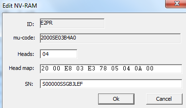

Confusing Head Map Info:
The HDD has no ID, ready in a sec
What would you say?

Corrupted NVRAM perhaps???? Have you tried editing it to be something more typical like 00 01 02 03 ?
More likely I'd guess it's just not properly reading the headmap from the family given how new it is.

Yes, I changed the HEAD Map like 01 02 03 04, still no id, it ids by utility (Unknown family)

This looks like the head map:
00000690                          00 01 02 03 0F 0F 0F 0F
000006A0  0F 0F
The software is expecting to find it here:
00000680              20 00 E8 03 E3 78 05 04 0A 00

So, the tool is not working properly to access the Head Map correctly.
That's right. You probably corrupted your NVRAM. Can we see what it looks like now?

I restored back the bytes to its original status (as attached nvram), and the original one shows like the op picture.
Now the hdd is in its original form it came.
So, if i m not wrong, according to your analysis, the tool is reading incorrectly this one. N in the original state the rom/nvr is ok.
What would u suggest?

I have no idea what to do. All I'm suggesting is that perhaps your model has a slightly different structure for the NVRAM.
FWIW, here are the head map bytes from an HTS725050A7E630:
00000680              00 01 0F 0F 0F 0F 0F 0F 0F 0F
They appear to be at the same location where your tool expects to find them in your HTS541010A7E630 dump. Perhaps you have selected the wrong family?
