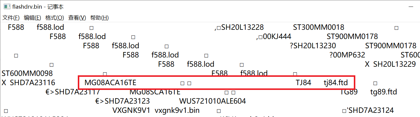

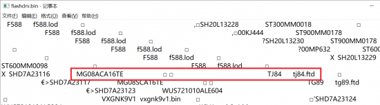

3. Go to extracted folder, open flashdrv.bin with Notepad, Ctrl+F to search your drive model, then you will see the updated version number and corresponding FW file (*.ftd for Toshiba).

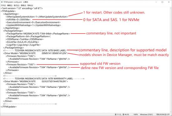

4. Download my modded Toshiba updater and extract it with WinRAR or 7-zip.

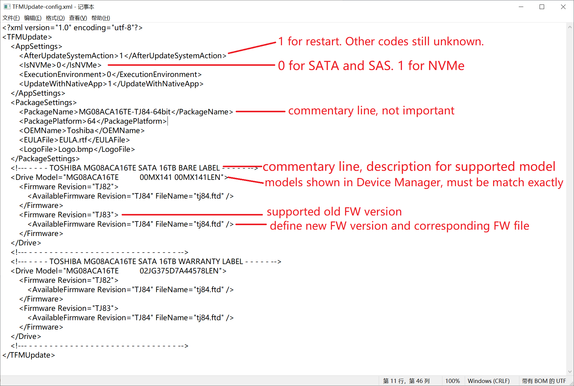

5. Put your FW file into extracted folder, open TFMUpdate-config.xml with Notepad and you will see the updater config.
Just modify it referencing my explanation, then save and close it.
6. Turn off your antivirus/HIPS software (since the updater needs to temporily register a boot driver), then run update.bat.
7. Accept the license, choose your drive and confirm. Your PC will be rebooted.
Before the logon screen appears, it will boot into updater and begin to flash.
It will show your drive model and update progress “97%……100%……”, then a FAIL message. Don't worry.
After reboot you can detect your drive with AIDA64/CrystalDiskInfo/Hard Disk Sentinel or whatever you like - to see if update is successful.
Since the drive itself does not accept an incorrect FW image, a FAIL message does not mean your drive bricked.
