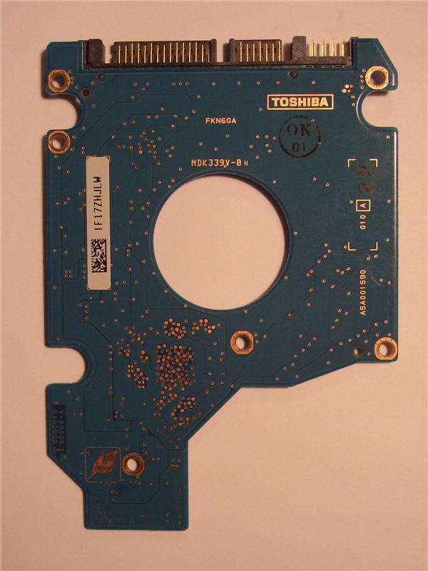

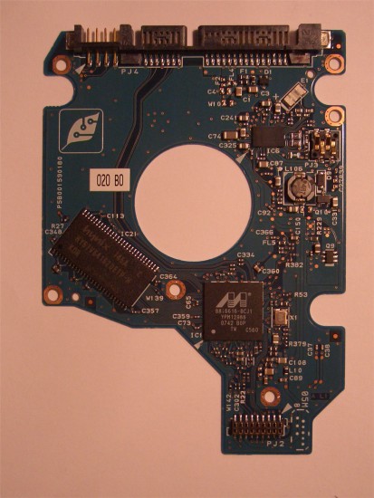

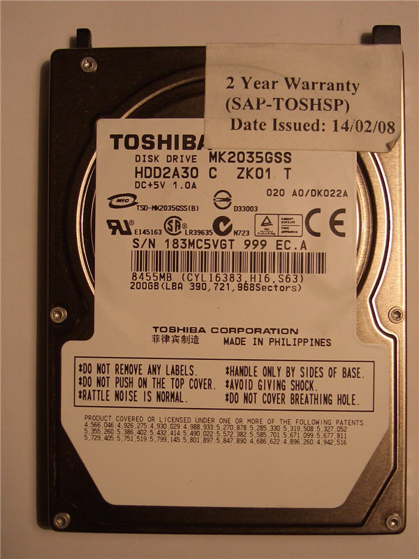

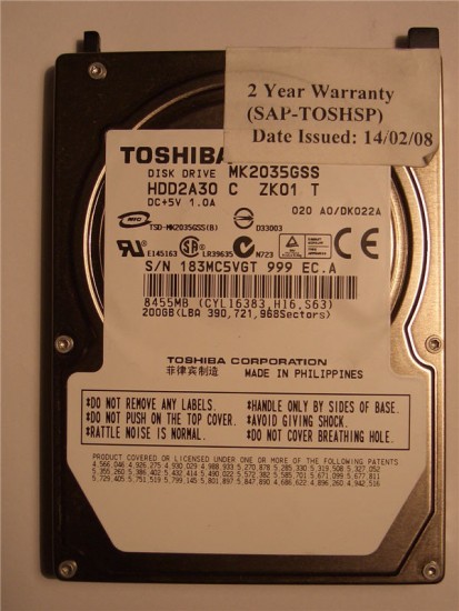

The numbers on my drive are (see also attached photos):
MDL: MK2035GSS
HDD2A30 C ZK01 T
FW: 020 A0/DK022A
made in Philippines
PCB: 020 B0
(white label on the component side of the PCB)

So I would like some advise on finding the most compatible drive for a PCB swap...
I've read that some people just match the MLD# (MK2035GSS) and the productions site (ZK01 T), so drive #1 and #2 would both do the job.
Someone else claims to match PCB number (020 B0) and FW (020 A0/DK022A), so (if PCB numbers matches) drive #3 would be my choice...

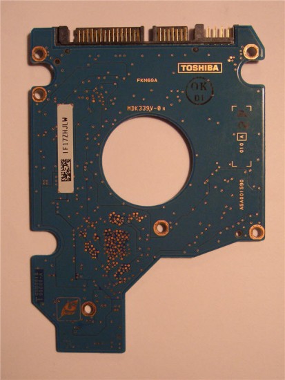

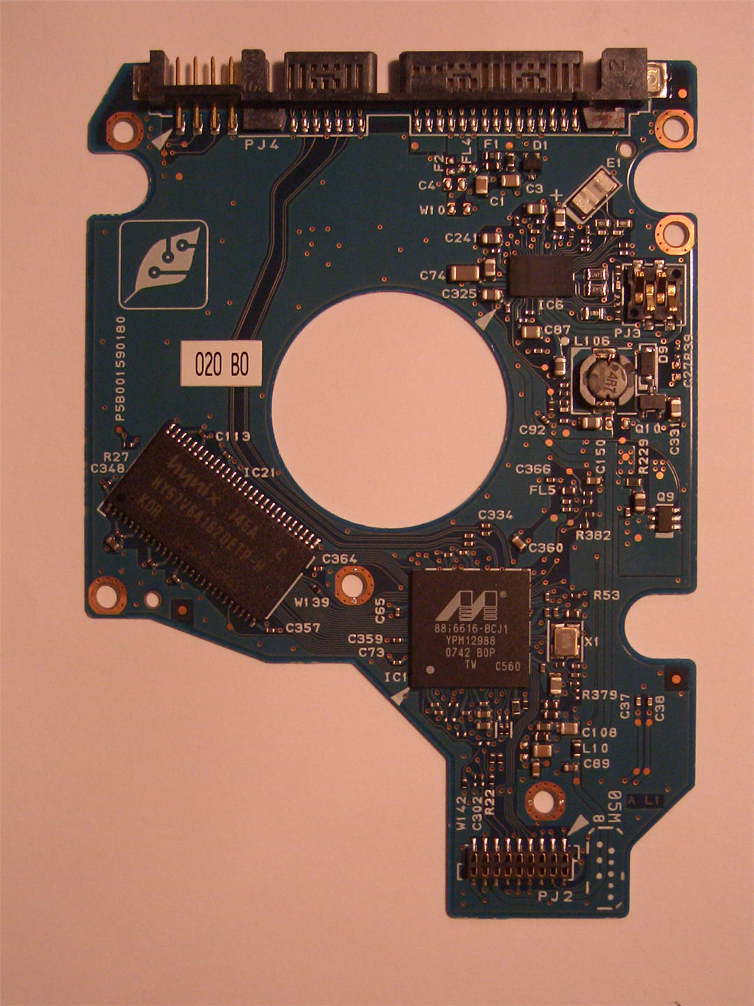

You need to match PCB PN (which is FKN6GA on your PCB)
After that you will need to swap CPU (It's MicroBGA and it's not easy)

So all the other numbers are not important anymore, as long as I find a PCB with PN# FKN6GA?
I know the difficulty of CPU swap...
I won't do this myself, I'll look for an expert used to do BGA soldering.
Olaita

doomer is right, transferring the CPU is difficult, and without transferring this then adaptive data on donor PCB will likely be different.
If data is important to you, consult a professional. Could be easily repaired with the right tools, maybe the fuse is dead. Are you sure no power is going through the PCB? Maybe it is powering but heads are parked incorrectly on platters causing resistance. this could potentially be dangerous for your data.

just check the FUSE ... position F1 in think ;o) Probably more.....
