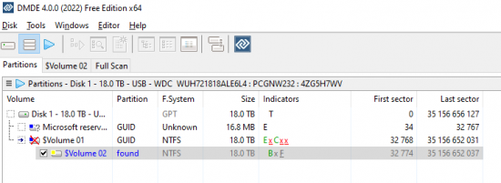

Can you show us the Partitions window in DMDE?
https://dmde.com/
Something like this ...
http://users.on.net/~fzabkar/DMDE/DMDE_Elements-8TB_Partitions.jpg

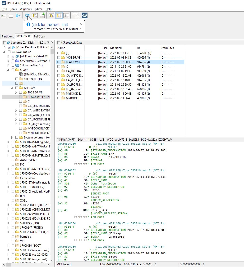

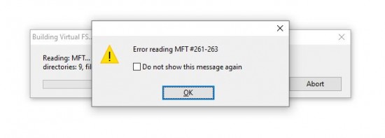

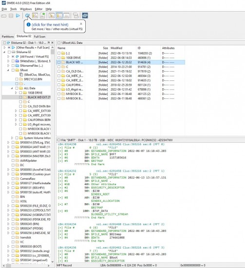

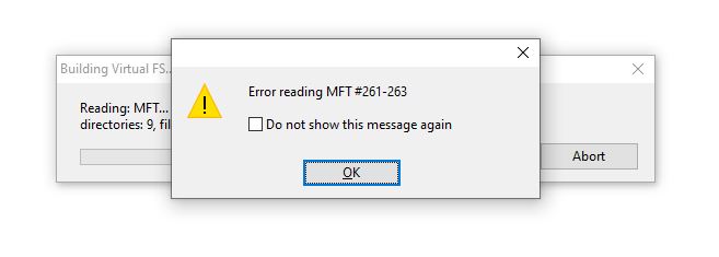

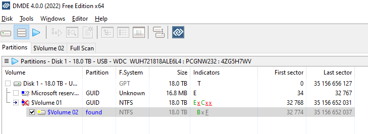

Here are some screen shots from the drive. I was unable to match the view that you brought up in the newer version, I hope some of these though will help, and I'll go back in and get whatever info is necessary to help you all help me : )
I'm pretty sure I set the drive up as a full size default single partition, GPT/NTFS. I have another fully working drive of the same model and setup here that I could reference if it helps to get information/layout from that. I made a typo before, it's an 18TB drive, WD HGST.
DMDE began a full scan which at the rate it was going will probably take a couple of days, so I interrupted it and pasted some screen shots. If the full scan is needed to get the required info for your help, I'll do that and circle back in a couple days!
Thanks in advance, Frank

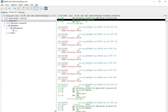

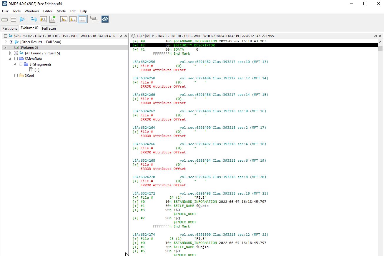

Volume 02 has a file system, but the $MFT appears to be damaged, probably due to bad sectors. Assuming the damage is confined to only a few MFT records, most of the files should be recoverable with their original file names. Ideally you should clone such a drive with HDDSuperClone or ddrescue.
Examine the drive's SMART report and look for reallocated, pending or uncorrectable sectors. GSmartControl will probably have a useful error log as well. If you see bad sectors, then cloning would be highly recommended, if not mandatory.
Assuming you can successfully clone the drive, a DIY solution should cost no more than US$20, if the free version of DMDE isn't already sufficient for your needs.

MFT records 13 - 20 are unreadable. The first 24 records contain NTFS metadata, therefore the volume will not be mountable. It shouldn't affect the data recovery, though.
Each MFT record occupies 2 logical sectors, so each bad physical sector will knock out 4 MFT records.
