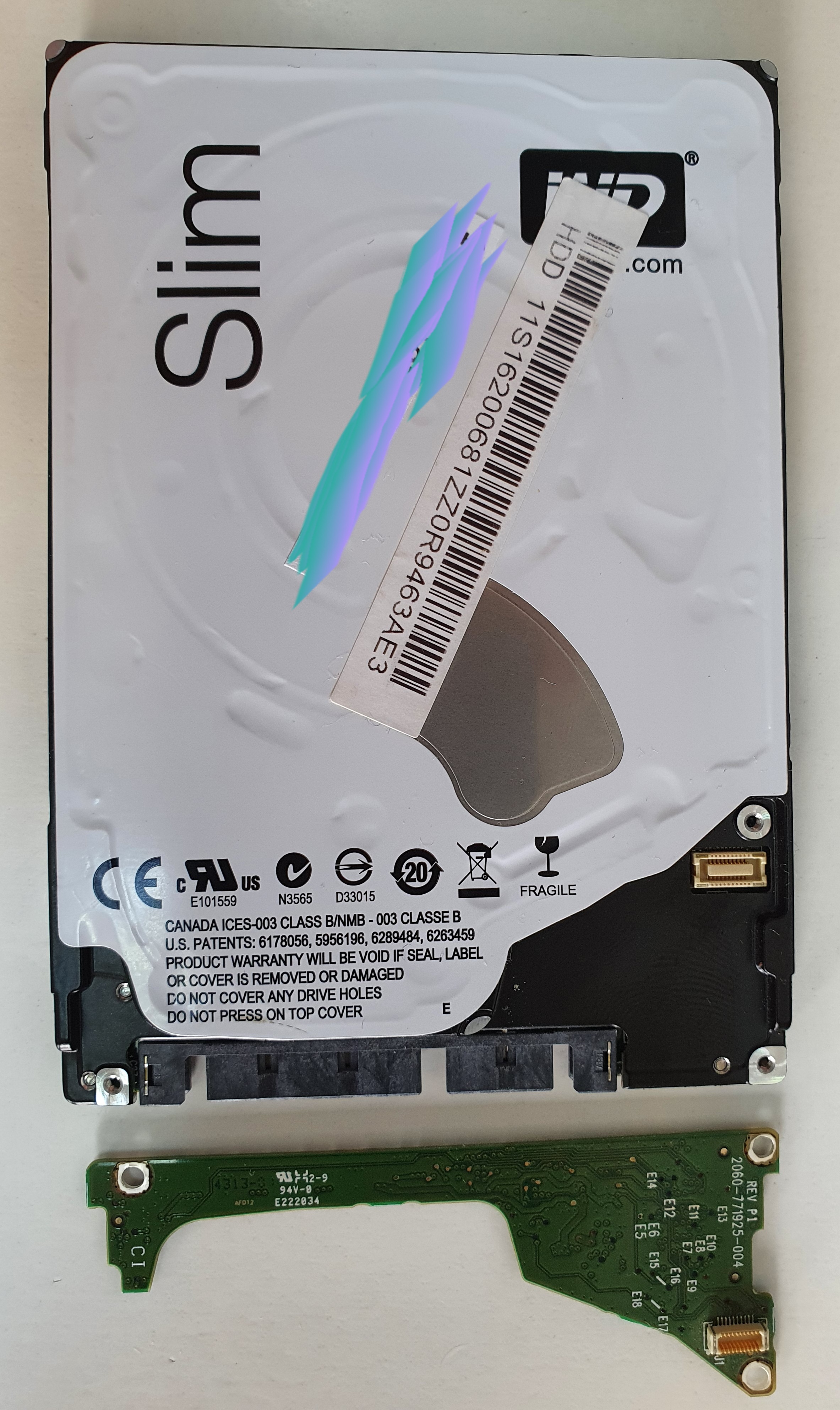

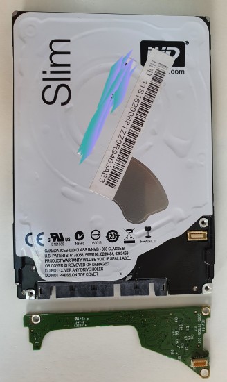

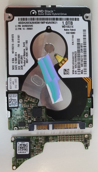

I have WDC WD10S21X-24R1BT0-SSHD-8GB drive, Big BearH 2.5" family, basically it's a WD SSHD, taken out of a PS3 console.
It's the first one that I receive this model for recovery and has other problem than Slow Responding or heads.
Drive is always BSY. I don't hear motor spinning.
I blocked SA access in ROM.
I noticed drive gets ready if i disconnect pcb with NAND otherwise always BSY. So i guess NAND or it's content is bad.
I uploaded dir into HDD RAM from SA and I get this:
SA dir reading (ID)..................... : Ok
Module 02 uploading..................... : Ok
Drive identification reading ........... : Ok
Servo overlay........................... : LDR already loaded
ID is not ok, as it does not show serial, capacity etc.
Drive starts spinning and stops short while after loading ldr.
I discovered that I can read all modules by ID and made full backup. Motor starts when i try read modules and stops after read is done.
Unfortunately I cannot write modules. I get "Unknown error code: 3745". So can't change anything.
If I allow SA access in ROM and NAND pcb disconnected, drive never gets ready, and motor never spins.
Anyone has experience with this model?
Ace TS said they don't know of any way to clear nand like in seagate or turn it off like in toshiba.
Anyone tried to swap NAND pcb only? How the drive behaved? (considering that the donor's pcb NAND will have donor data inside).
I don't have a donor for this model so any tips would be much appreciated prior to buying one.
Any ideeas are welcome. Thanks.

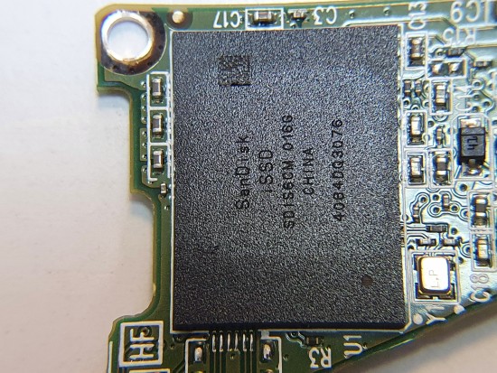

And some pictures:

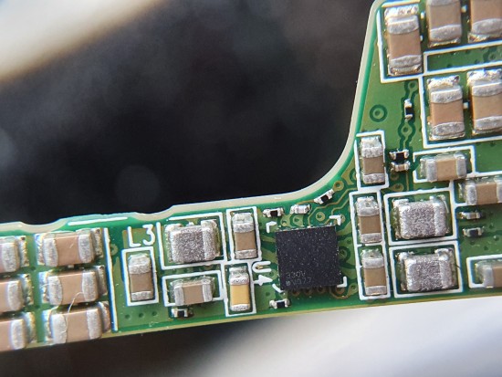

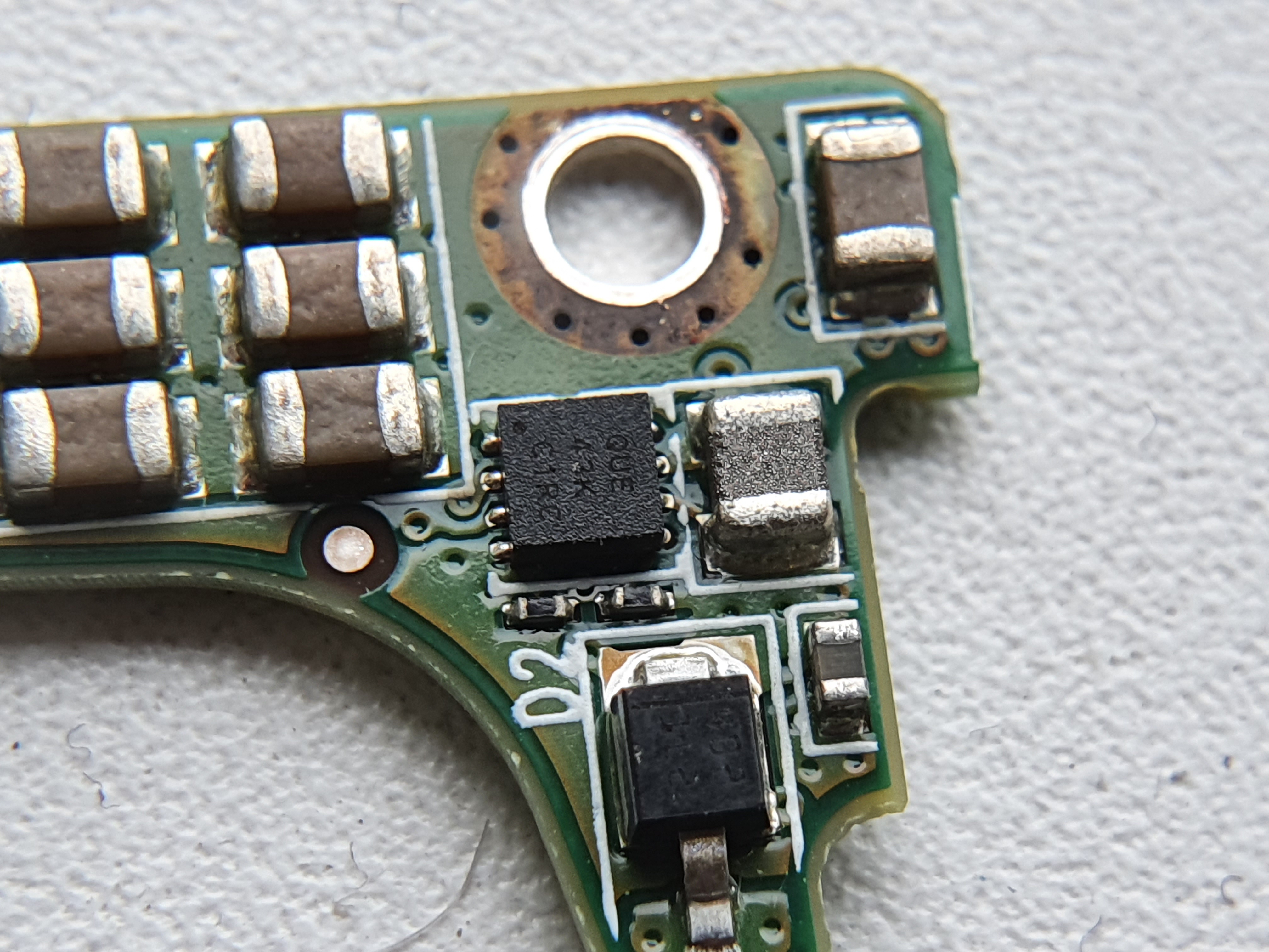

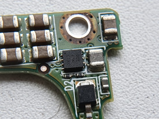

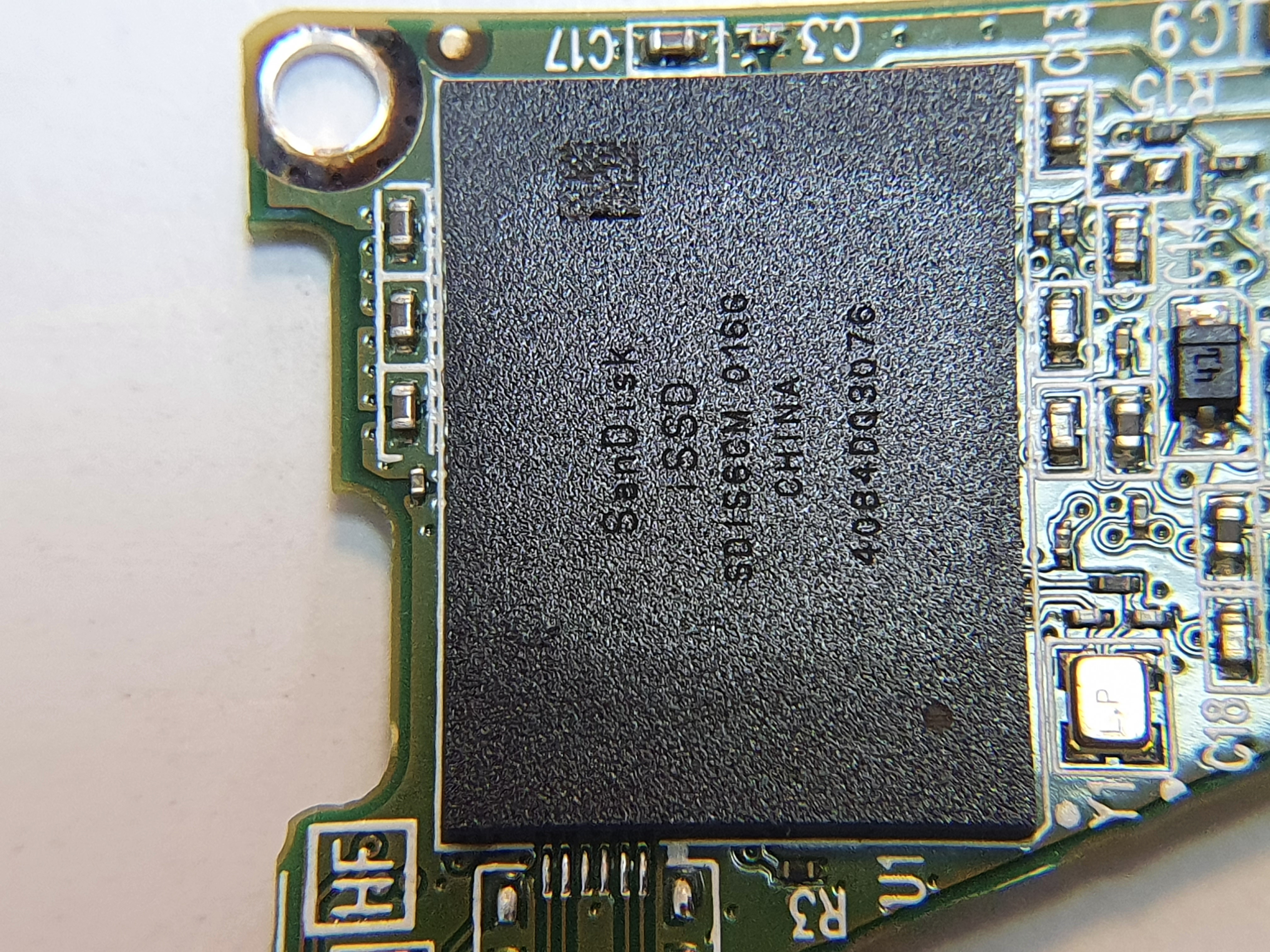

If U1 on the daughter board is a NAND flash IC, then why does it need a crystal (Y1)? Why does the board have 4 (or 5?) power supplies?
The large array of capacitors would suggest that these are for power loss data protection.
Is the same MCU used in non-SSHD applications?

Close-up picture:
 Post subject: Re: WDC WD10S21X-24R1BT0-SSHD-8GB
PostPosted: August 25th, 2021, 5:18
Joined: May 9th, 2017, 11:33
Posts: 155
Cannot find any info about these codes, but as it states and considering the power supplies I guess this an SSD not just a NAND.

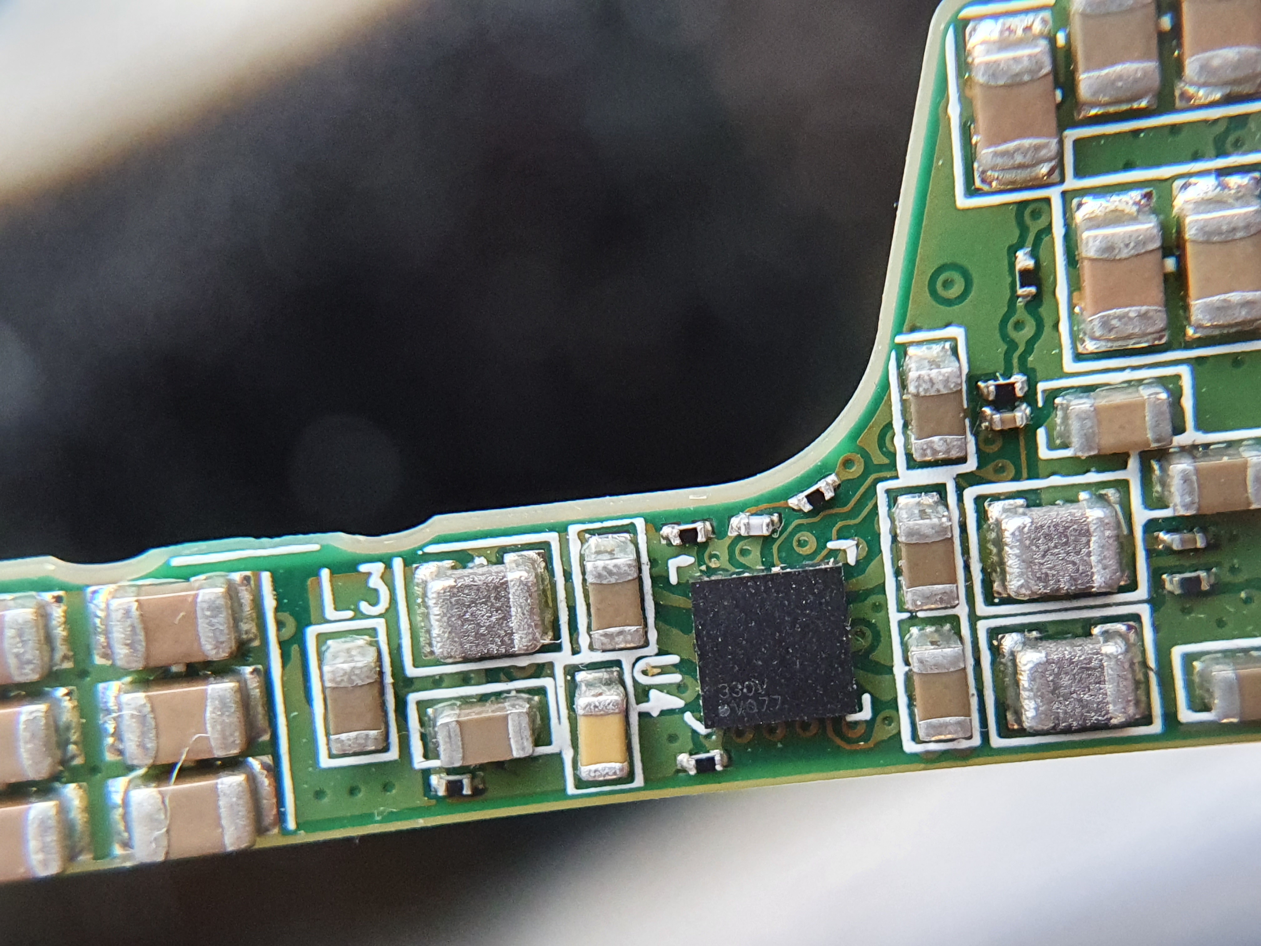

More photos:
yes, it interfaces to the other pcb through 2 differential lanes, which turn out to be a SATA interface. It connects to a 88SM9642, which appears to be a port multiplier. So the drive should work perfectly without the SSD board, perhaps with some modifications...

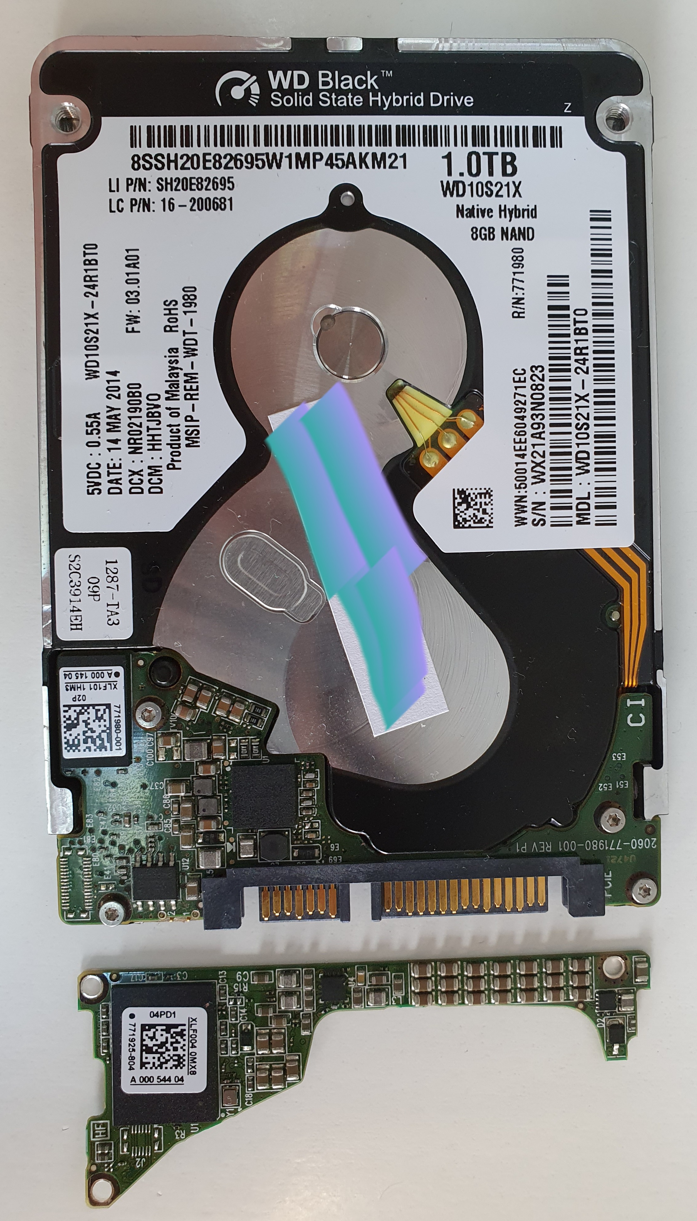

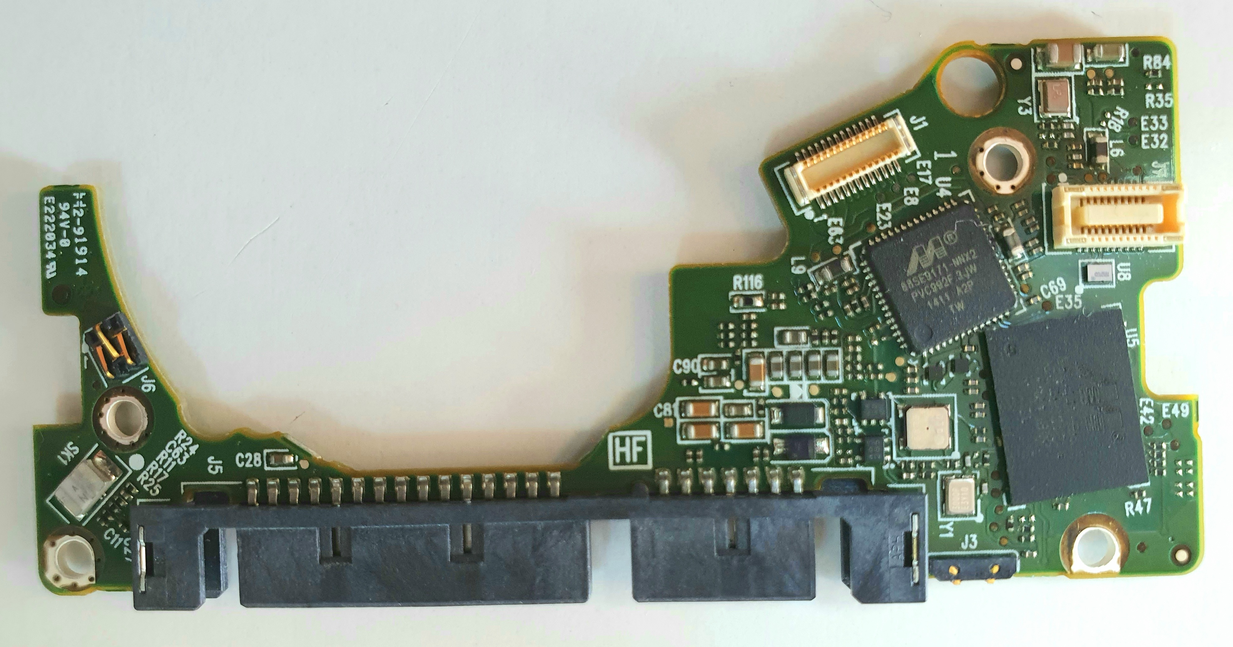

Sorry, this doesn't make sense. The ROM wouldn't see the SSD since it exists on a port multiplier. I think only a hardware modification would make sense. To this end we would need to see the other side of 2060-771980.

Other side of 2060-771980.

Now this is pretty odd. The above pic shows a 88SE9171, which is a PCIe-SATA controller, with one sata port.
Just noticed this is a BigBearH, what i have is a BigBear, with a different design, having a 88SM9642 on it, which is a port multiplier indeed.
So this drive must have considerably different design than mine and the guy at https://community.wd.com/t/disappointed/16880/3 .
I can't read the part number of the main controller on the pic, it must be something like 88i944x-xxx
mine is 88i9446-BRL2.
The SSD board is almost the same on mine, 771925-504, layout is similar but the CAPs are not populated. The SSD chip is the same, so it is a SATA intf that goes to the PCIe-SATA controller. Which is probably interfaced to the MCU with the PCIe lane and more integrated into the HDD, probably not accessible as a separate device from the outside.
And as such, the FW must be aware of the SSD part.
One could attach a prefilled sata drive on the SSD port as a cheat, i suppose...

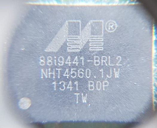

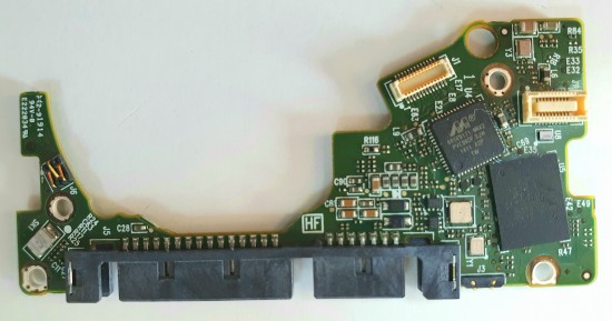

Controller is Marvell 88i9441-BRL2:
PostPosted: August 26th, 2021, 12:35
Posts: 4816
yeah, so it is different, as i expected.
can you check where the main sata port is routed? I suppose it is to the 88i9441.
(it is routed to the 88SM9642 as a main difference)
pls also check routing of the SSD sata lines, i suppose it goes to pins 21-22 and 24-25 of 88SE9171
and i would also make sure that the PCIe signals of 88SE9171 are routed to 88i9441 but i think it will be hard to check due to the burried traces.
https://www.marvell.com/content/dam/marvell/en/public-collateral/storage/marvell-storage-88se9171-datasheet-2015-11.pdf
Anyway, the cheating can work on this one too...
