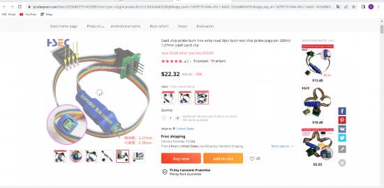

Its 208 Mil I think.

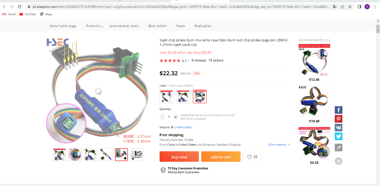

I have a unique requirement of on site rom transplant on a defense client site. So instead of taking hot air gun I am planning to take pogo rom reader probe.
I have checked aliexpress but there are different probes for different chips.
Currently I am looking solution for Desktop Seagate / WD hard disks starting from 160GB to 2TB . I think most of the chips on these desktop hard disks are SOIC8 TSOP IC's.
I want to build excel sheet of all eeprom chips ever used in drives , there voltage ratings etc.This will help new technicians .
I am also looking for safe & reliable ROM reading techniques. There are less risks involved in solderless rom reading.
So I want to know distance between pins of SOIC8 ROMS so that I can choose right probe.

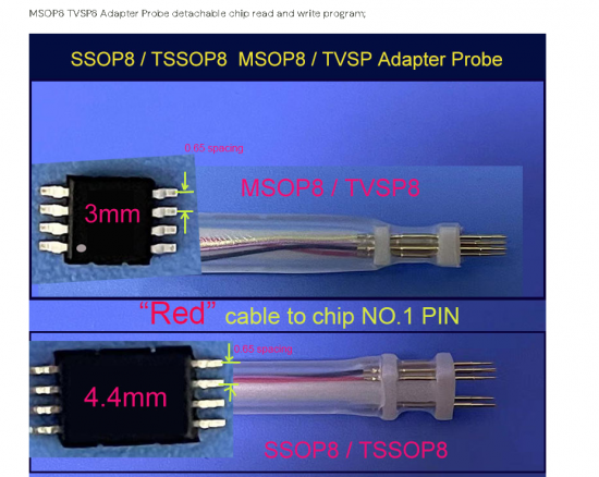

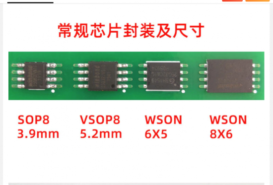

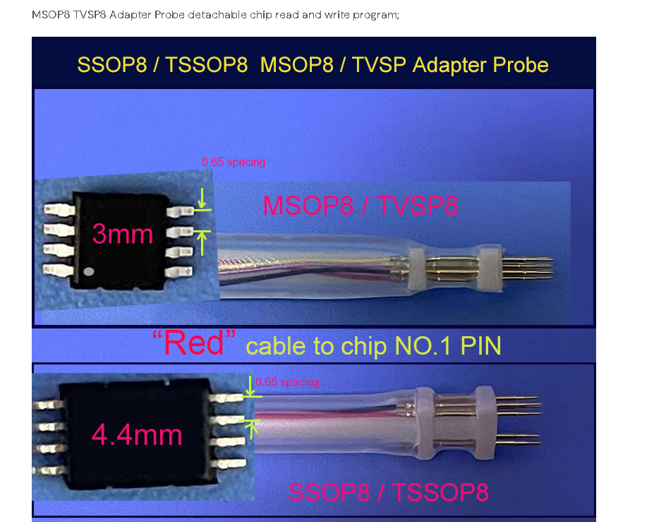

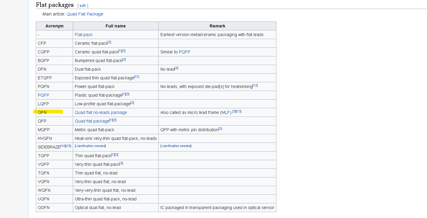

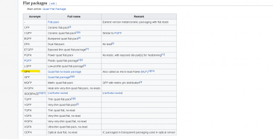

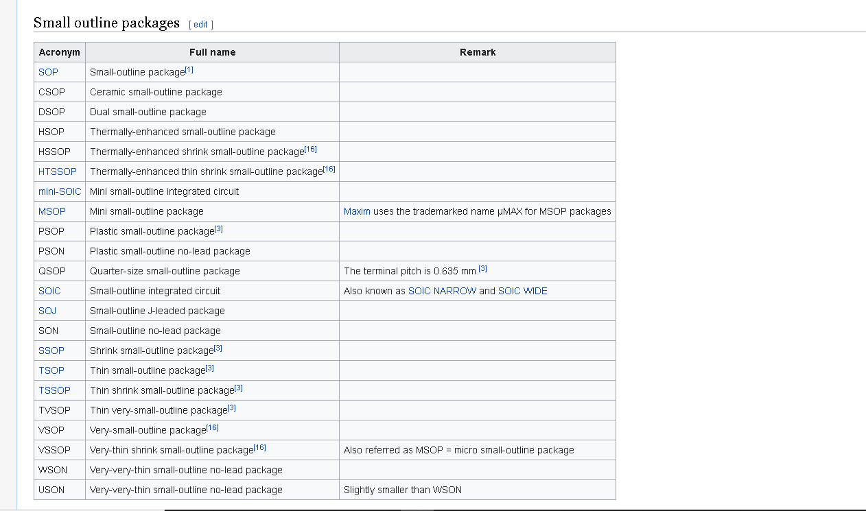

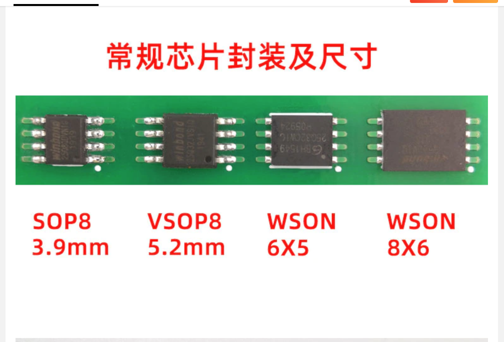

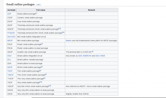

I have done some research while searching this product.Attached are some details which might be useful for you.
SOP8 has 2 types 150 Mil & 208 Mil spacing
