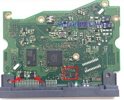

fzabkar and DR-Kiev were spot on.
We tested the board and found two shorts, resoldered the Roms and cannibalized the donor board for spare parts.
The drive now works flawlessly, SMART shows up as OK and the sounds I was hearing still appear on the drive and are confirmed for preventive wear leveling.
I went from 3 busted drives to 3 working drives within a week.
Thanks to the resources on this forum and the input I received here all data has been recovered :D.
Can you recall where they where for the next person that has a similar problem.
 Post subject: Re: Seagate 1x, WD 2x dead PCB repair questions
PostPosted: September 16th, 2022, 9:08
Joined: September 5th, 2022, 16:01
Posts: 6
Location: Germany, BO
Lardman wrote:
Marked them in the picture
