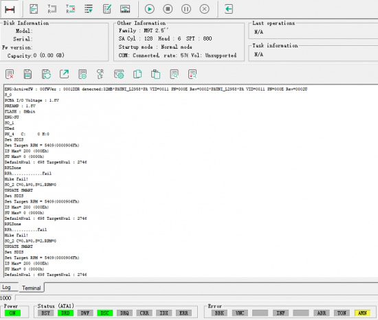

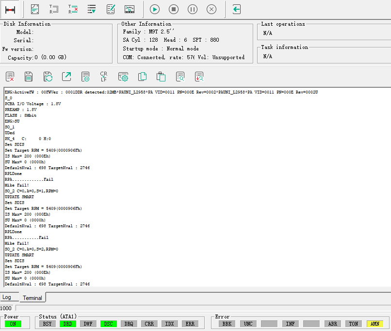

On Giving SU Command , Show this, But NO SPIN
