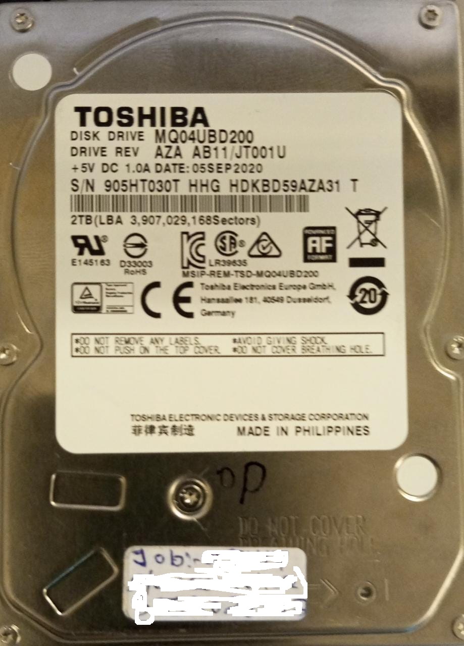

Hello Evereyone ,
I received a Toshiba MQ04UBD200 That the customer had taken back "Time frame not approved " .After the customer gave the drive to another company and for some reason they could not manage to get the data out .That customer gave me the HDD after 1 month of taking it back .I replaced the heads as the drive was in clicking state then i had got it earlier ,After HSA replacement the drive could not spin .I tried the ROM on few USB and SATA Boards just to confirm .I then used a Donor board + rom and it indeed spinned .This is a sure pointer to " BAD or Purposely Tempered ROM " . The Original ROM Chip That i Received In The PCB is Winbond 25Q80 Series Which Means Its " 1MB " .I then Told The customer about the situation and he called up the other company and they gave him a ROM file thats 512KB " From 000000-07FFFF " .But if i read ROM in programmer its from " 0x00000 To 0xFFFF0 " . Attached are The ROM Sent To Me By Other DR Company , ROM of Patient I Read With Programmer , Another Sample ROM Read By Programmer .

The second half of "ROM Patient Read By Programmer.bin" is filled with 0xFF. Unfortunately that's the half of the ROM where the CPs are stored.
Game over. :-(

Posts: 17323
ISTM that the patient PCB may not be native. Otherwise, why would someone read the ROM with PC3K and then write it back, assuming that's what happened?
What are the date codes on the ICs and on the drive's label?
Hi ,
This is the label ,The File is Attached For Your Reference

OK, so we can see the date on the label, but what about the ICs?

There is no serial number in the patient ROM. That's because it has no CPs.
Here is a photo of your PCB:
https://recuperodatos.com/sites/default/files/webform/donantes/03490-PCB.jpg
The date codes on the ICs are 1744, 1744, 804, 751, 1740 and 1750. That suggests a manufacture date some time after week 04 of 2018.

Well,
i have never posted my PCB photos so how come you are suggesting its 2018 manufactured ,The label says 2020 not 2018 of HDA side of HDD .or are you suggesting me how i should read my PCB and date codes

It's not your PCB, but it's the PCB that comes with your model. All I'm suggesting is that the other guy may have transferred the ROM or its contents to a donor PCB. I'm just showing you how to check whether your PCB is original. If it isn't, then the other guy must have the native PCB and maybe the native ROM.
