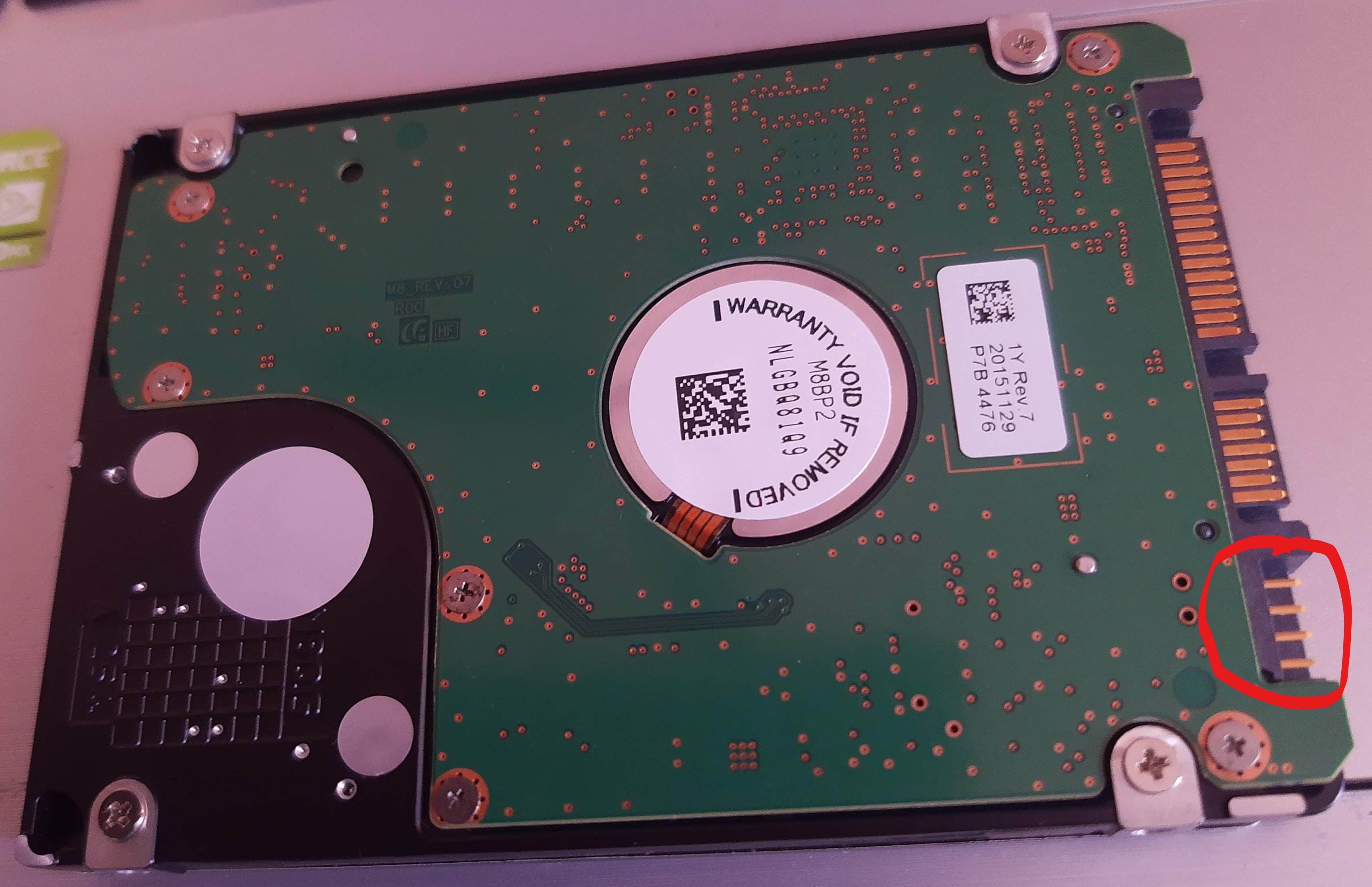

 Post subject: What are these Seagate HDD pins?
PostPosted: October 16th, 2022, 2:33
Joined: October 16th, 2022, 2:24
Location: Kerala
Hello! I just came across the Seagate HDD ST1000LM024. I understood the SATA connector pins (15+7 pins). But what are the 4 pins apart from these? I have encircled them in the attached image. Please let me know. Thanks.

Terminal pins

How to connect the TTL Adaptor to a Seagate drive :
http://www.hddoracle.com/viewtopic.php?f=6&t=193

This is a Samsung HDD. Use 57600 8N1

How to connect a terminal adaptor on a Samsung drive ?
http://www.hddoracle.com/viewtopic.php?f=116&t=189
