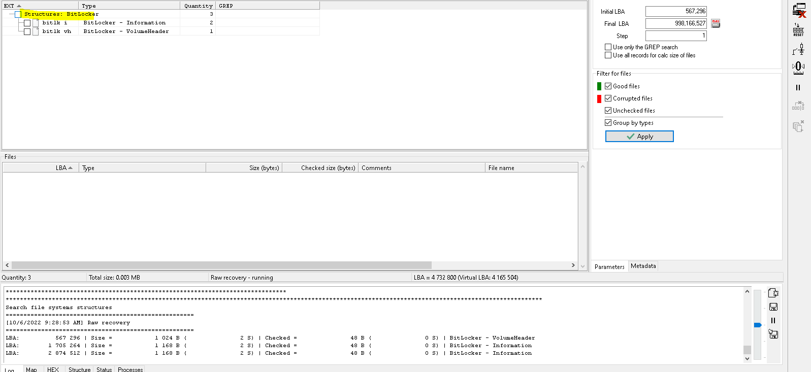

I have got a nvme SSD which was upgraded to windows 11 automatically. Bitlocker has suddenly started appearing and customer says he was not aware of bitlocker.

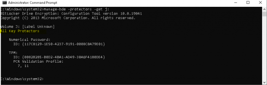

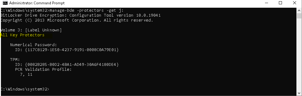

I have checked protectors which are not "clear key" type so I am unable to decrypt them in pc3000 .
Is there anything I can try before giving up. Data on ssd is very important research data collected over time.
protectors are TPM and Numerical password.

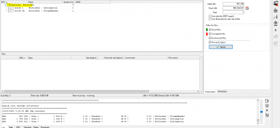

Raw recovery in udma gives bitlocker headers. Are they of any use ? Attached are the same ------
download link - https://drive.google.com/file/d/1RIhD3d ... sp=sharing

I think full decryption not possible in this case as TPM is involved.
User might not be aware of Bitlocker but when he signs into microsoft account ( with administrative privilege ) automatically Clearkey password is converted in TPM type when key is backed up in microsoft account.
regarding those 2 files I am not aware of , opening in notepad shows something but it is least likely of any use.
