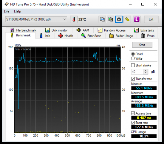

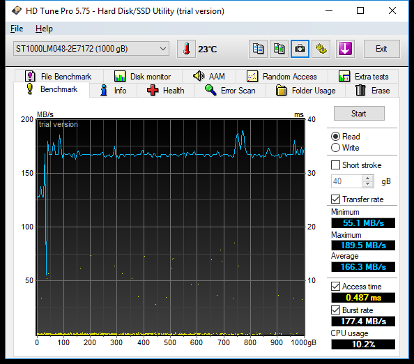

Is this new Hdd ok?
Access time is only 0,487 ms.

Seagate SMR to me...
SMART it after you 0 the drive out.

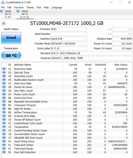

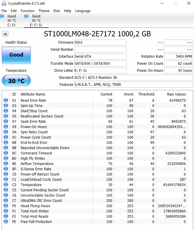

Smart is OK.

Drive looks fine.
Now, for how long will it stay that way, that's another story.

The drive has reported 8 Command Timeouts, one of which was longer than 7 seconds.
