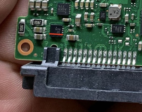

I burned out a TVS diode on a Seagate 8TB drive (ST800NMN0055).
I can see the burnt diode (see picture), not sure if this is the 5V or the 12V?
I've removed the diode but the drive doesn't spin up. I'm assuming I need to solder over a fuse?
Can someone help me what needs to be done next?

That's not a TVS diode -- it's a 12V electronic fuse (NIS5132):
http://www.hddoracle.com/viewtopic.php?f=100&t=1615&p=8872#p8872

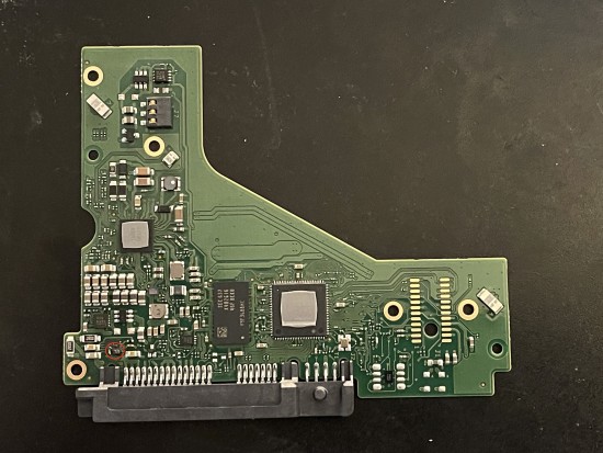

Photo of similar PCB:
https://ae01.alicdn.com/kf/S67743187395f4980b8e1f7b1bde441fcF/hard-disk-circuit-board-is-suitable-for-10t12t-Board-No-100784953-Reva-is-measured.jpg
The solution is to run a bridging wire from Vin (Vdd) to Vout (Source). Make sure there are no shorts between Vout and ground.

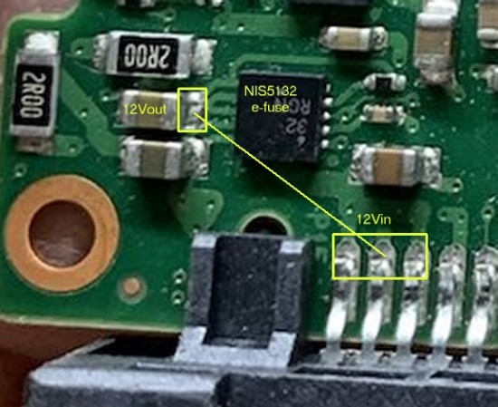

Thanks for the info!
So if I understand right, just one connection from here to here (See picture)?
hard-disk-circuit-board-is-suitable-for-10t12t-Board-No-100784953-Reva-is-measured.jpg [ 235.96 KiB | Viewed 5425 times ]

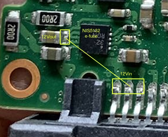

No, don't do that.
Do this:

Ahh thank you for the clarification!
One bridge wire from 12Vin to 12Vout or 3?
Thank you for the help!!

Just one.
